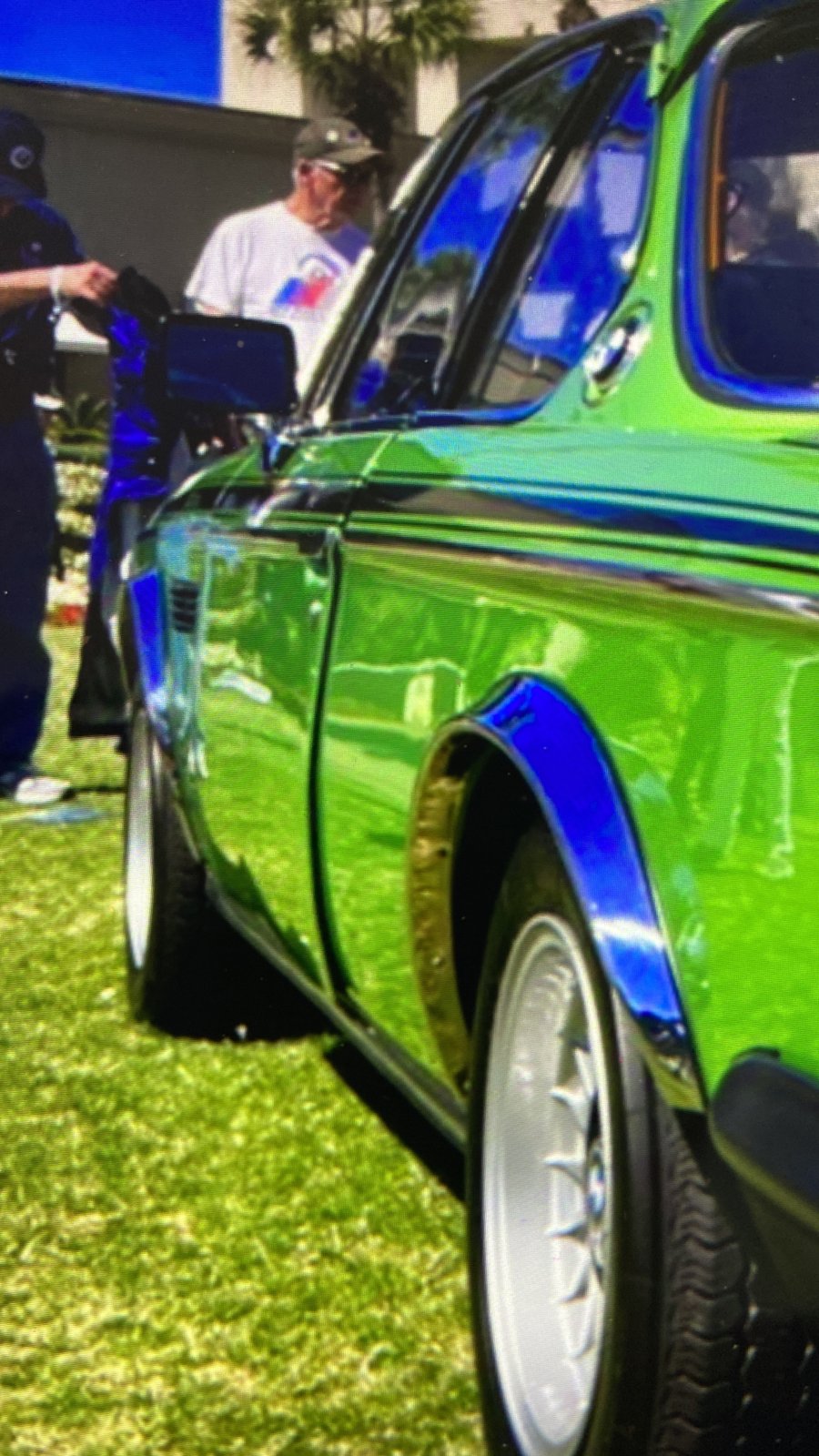

I had to miss Amelia this year due to other commitments. Tell us what you saw adn what you didn't like. The inner fender welds were done wrong, and that is not at all easy to fix. What else did you see? The headliner looks like correct material to my eyes from the pic above. Totally weird ride height, too. How about the rear wing setup?

I hate to be negative, but you have asked, so I will explain why it was a correct price for "that" Batmobile - inner fenders lots of filler starting now to crack and lift at the seams, what should be sharp metal lines and clear spot welds have been smoothed over with seam sealer or filler in the restoration, hiding all the places we know are weak. Shut lines all over the place all around the car terrible, something a simple as the drivers door had a gap at the front bottom of door where you could almost see into the car and a 3/4 inch out of line at the bottom rear of door, inconsistent gaps all around. In fact just look at the door picture above.
Wrong kidney, not CSL -engine stamping, inconsistent with factory and shows grinding down of another number - Rear wing is a series one Bat and incorrect for a series 2 bat - seats are not correct - roof has been replaced at some time and is now showing where car was cut.

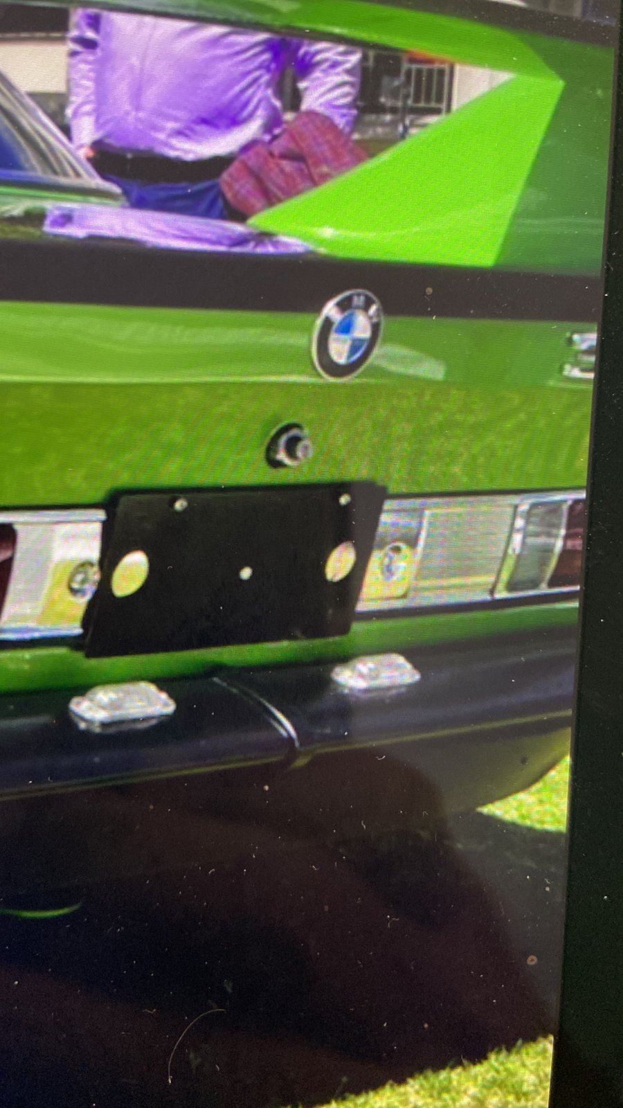

The rear bumper lights taken from the trunk…..hilarious!

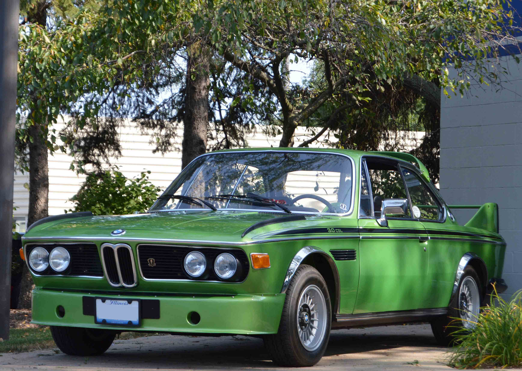

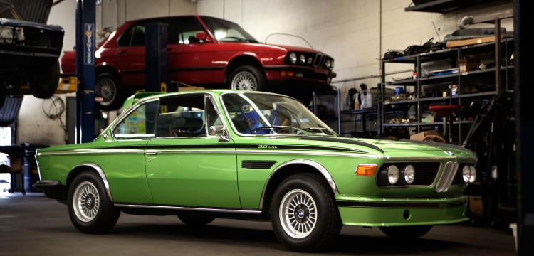

Found this car (Bat series 2 number 49), sold at Bonhams for 150k (I had 160 in my head) all in back in 2009. Same wonky wing mounting and bad trunk panel fit. All the filler on the inner fenders had yet to declare itself.
@BMWPete, Perhaps four star classics was the buyer at the auction, and then brought the car to the UK? in GBP it was probably cheap.
This recent sale of the same car at 291k is a 100K discount off market, IMO, but now we know it is all based on the messy condition. Another 100k and a year with Mario could put it right.
