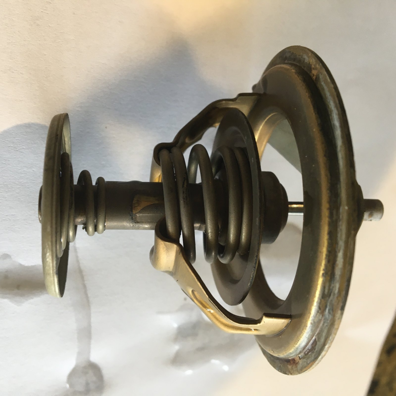

I had asked him to give me the old thermostat. Today I gave it the boiling water test and it seemed to open pretty wide (see picture below). My questions are:
- Looking at the picture, with the thermostat fresh out of boiling water, is it opening fully (sure looks like it to me)?
- Do thermostats ever become intermittent? That is, stick only sometimes? My mechanic pointed out a shiny part on the thermostat shaft where he believes it was binding. But it sure seemed to open in the pan of boiling water.
- If the old thermostat was not defective, then what other issues might explain my symptoms? Yea, I know: a clogged radiator.

Thermostat sure does look to be wide open but since you've replaced it you can strike off the list! Have you been for a drive since it was changed ie not just idling?
If still overheating, bleeding the system cant hurt though I dont think an airlock would cause symptoms you describe. Note your newish radiator, but its only going to be as clean as the sludge in the rest of your engine allows. Maybe try a coolant flush - I did one recently and seems to have been beneficial

Brought the car to my mechanic to get his opinion. He looked at the condenser and pronounced it OK. Suggested that the thermostat might be sticking and we agreed to have him change it (old and replacement thermostats rated 70° C). After changing it, he left the car idling at his shop and said that the temperature gauge stayed in the normal range. So, the problem should be solved, right?
I had asked him to give me the old thermostat. Today I gave it the boiling water test and it seemed to open pretty wide.
It sounds to me like it is fixed. If he let it idle in his shop for a while that should be the same as being stuck in traffic for a while. Let it idle in your driveway for a half an hour and see if you get the same results your mechanic did.
The T-stat is 70 C. The water temp should be monitored during a test to see if the T-stat starts to open at 70C. Plunking it into boiling water only shows it will open at 100C. It does not test that it is performing correctly.
My guess is that the T-stat was defective and the mechanic fixed the problem.

the correct thermostat for your car is an 80* C thermostat. It should open at 80* C. Putting a thermostat in a pan of boiling water is not how to test it.
Place it in a pan with a thermometer and note the temp when it opens
Yes, I see your point. The fact that my old one was fully open at 100 C doesn't tell me what it would do at a lower temperture.
