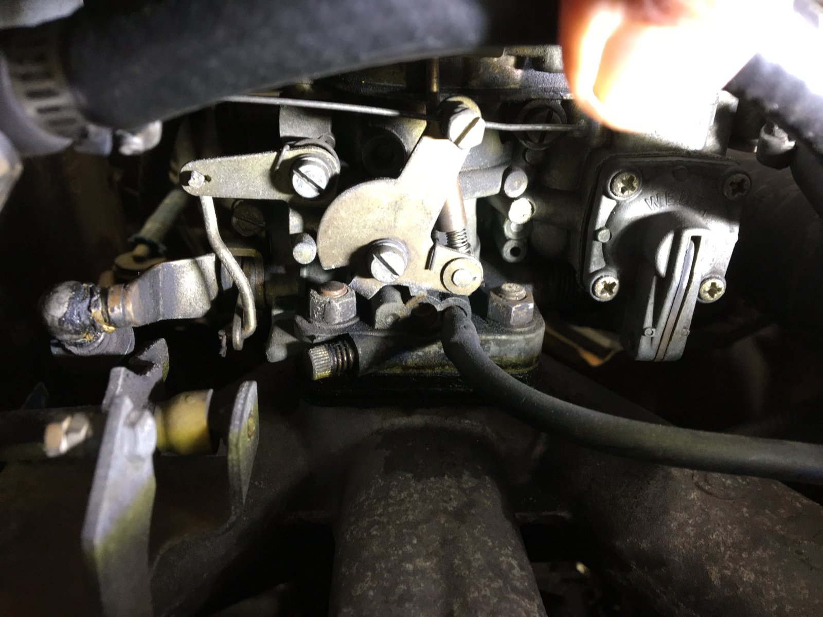

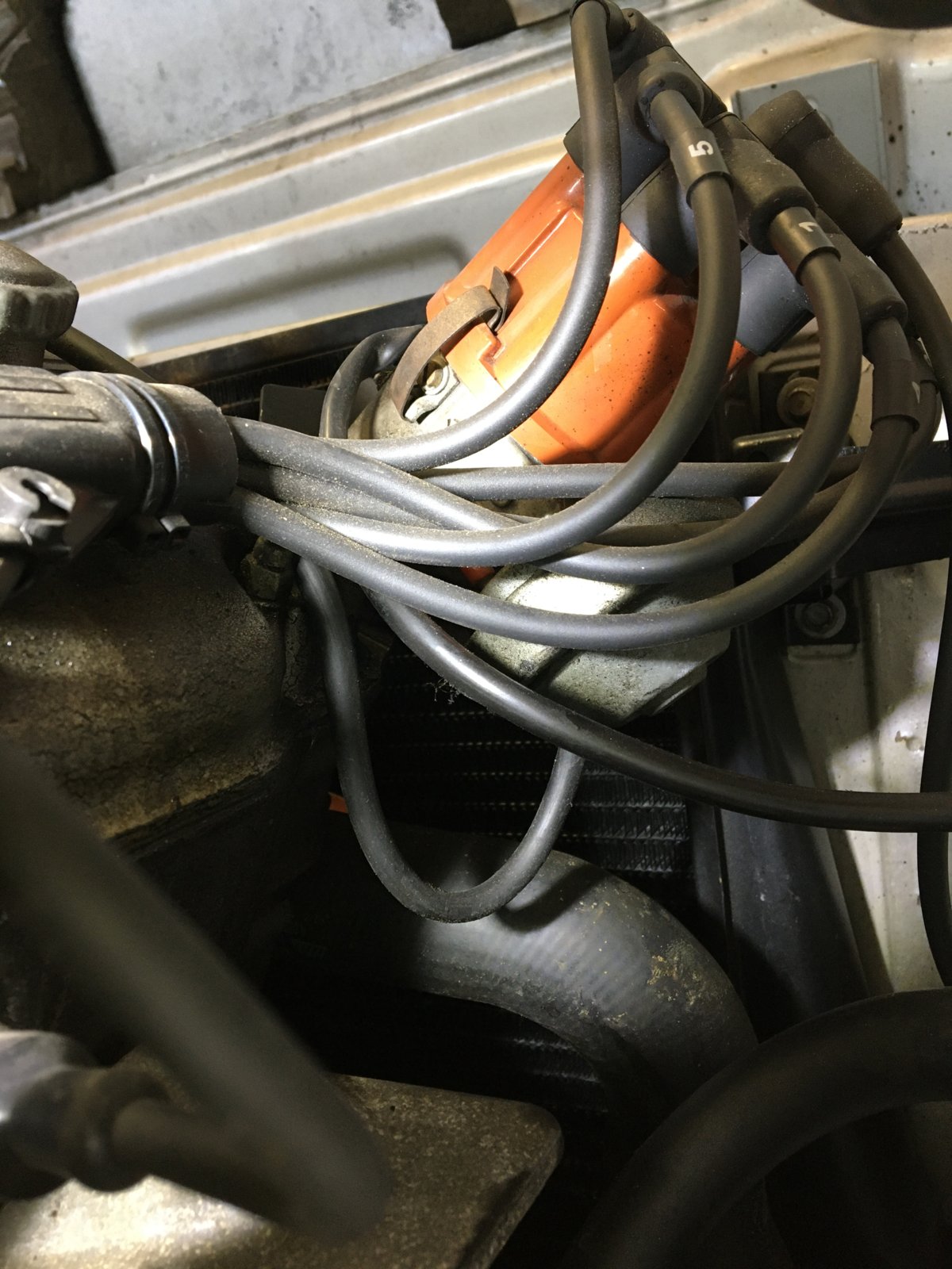

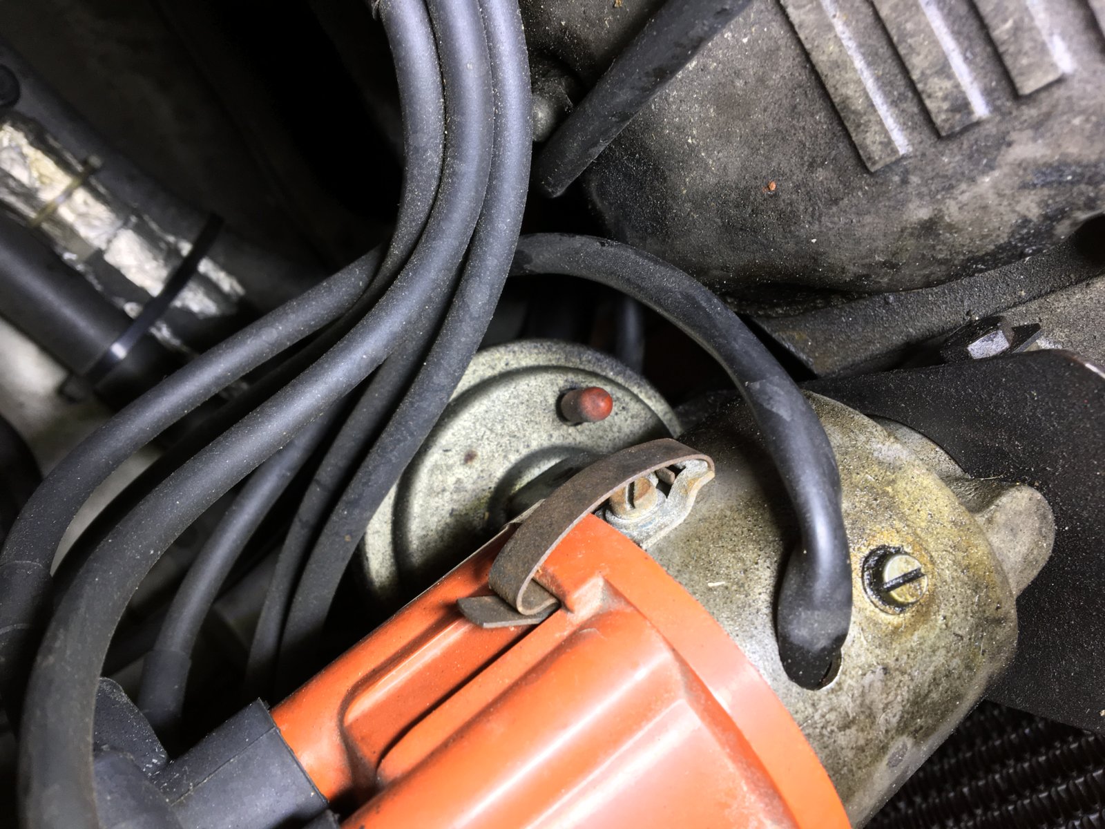

Hmm - perhaps this modification has already been made. I see that the port to the upper vacuum chamber has been blocked (1st photo below). There is a vacuum line going to the bottom chamber (2nd photo) and that line comes from the base of the forward carburetor (3rd photo). So has that "retarding the spark at idle to reduce emissions at idle" already been eliminated?
Sort of. The vacuum retard has been disconnected, but the advance side of the dizzy is hooked up to ported vacuum. That means the dizzy does not see a vacuum signal until the throttle plates open and uncover the ported vacuum port. So at idle, the engine is not receiving additional advance.
It is certainly a step in the right direction. At least the ignition timing is not being retarded at idle like it is stock. Most owners leave things like this and that's OK. But for best idle performance and the least heat induced by timing at idle, I hook up that side of the dizzy to manifold vacuum...the port(s) where the retard side of the dizzy was getting the vacuum signal. Again, the idle speed will increase when you do this since the engine is happiest with lots of advance at idle. You'll have to set the idle speed back down to spec with the idle speed screws on the carbs.
