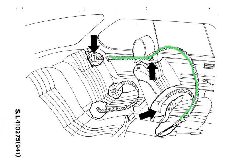

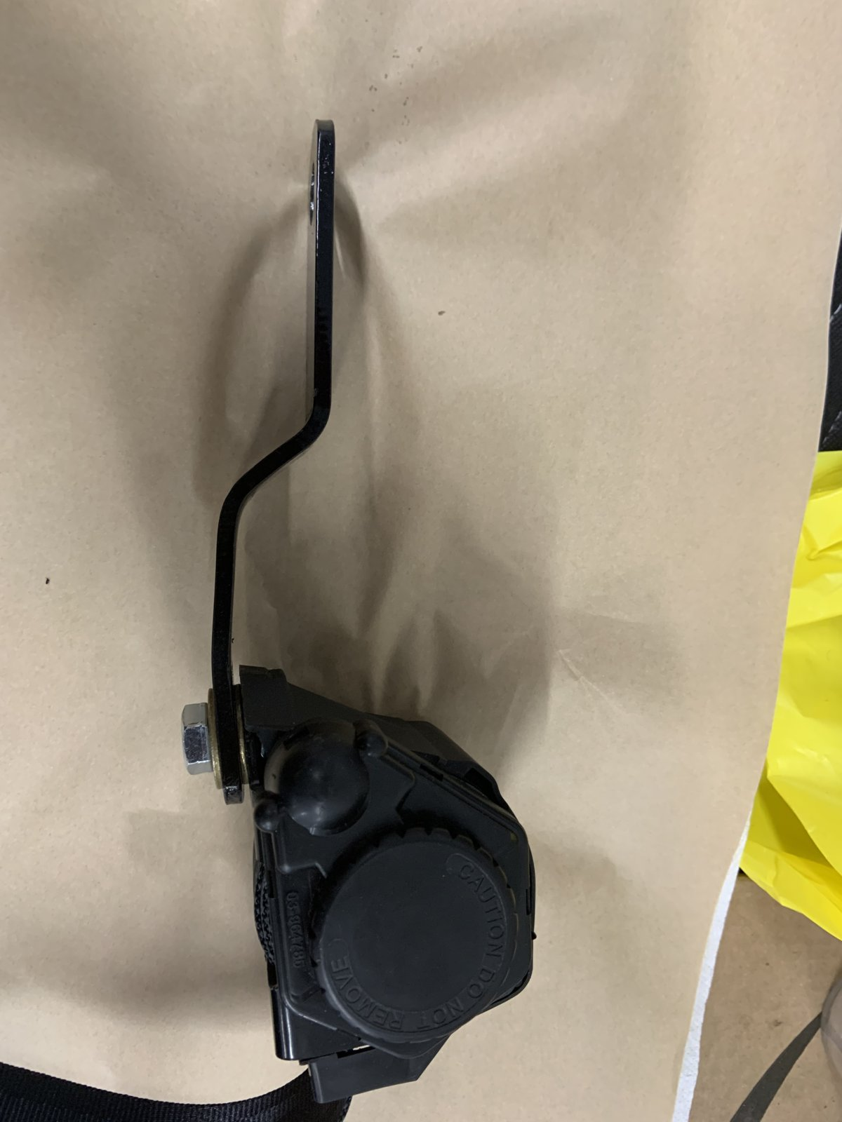

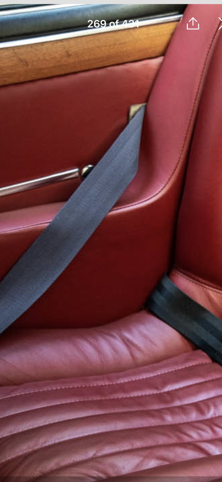

Your Euro coupe had the fixed shoulder belt mounted behind rear seat armrest with a fixed or possibly retractable lap belt I assume. The 74 had a horizontal retractor behind the rear seat but you would need to modify or swap out the rear armrests and fabricate a mount. Sometime in 72 a fixture was added to the roof in front of the grab handle for the fixed shoulder belt. At this point any mod could be a bit challenging. Easiest is to mount the retractor on the rocker where the fixed lap mount is and use a belt long enough attach to rear seat area after it crosses your lap and shoulder and find something to hold it to the headrest post I would think. I believe Al is still around but he would need to know how long your belts would be.

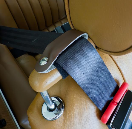

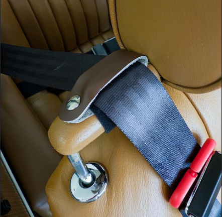

I did what Chris suggests here with my 71. I did run the belt through the headrest, which keeps it positioned nicely. This retractor arrangement is a bit cumbersome and requires some getting used to, but seems to be a good solution. Plus, no hanging belt in a pillars-less coupe.

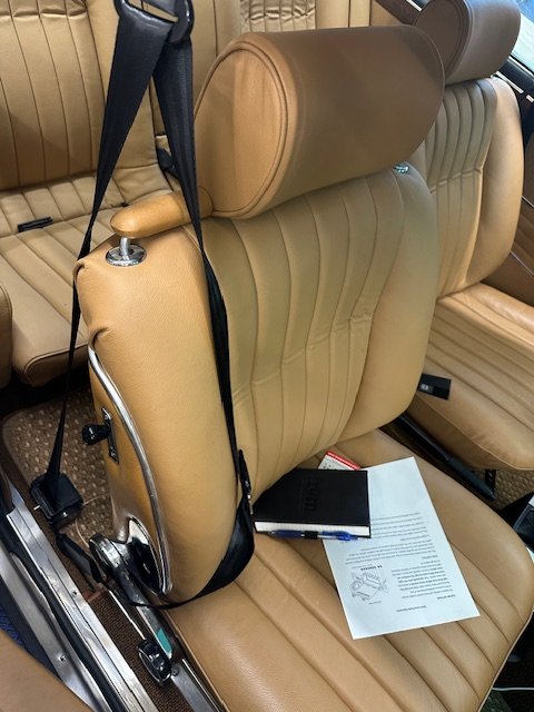

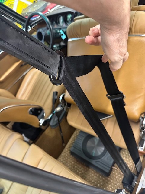

Here are some pictures of the belts from Al that I described earlier in this thread.

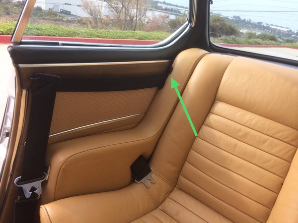

I have a wide velcro and leather strap now holding it to the head rest.

The retractor works without any issues in that orientation.

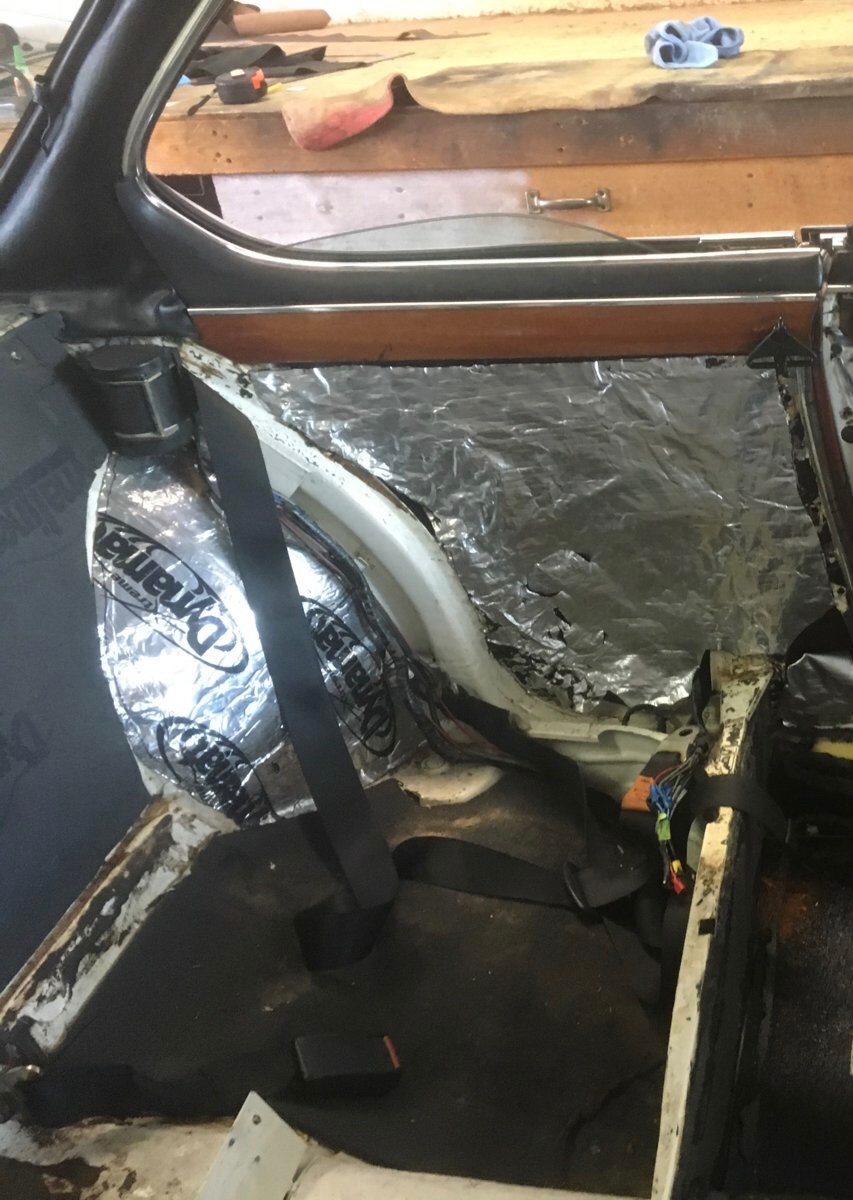

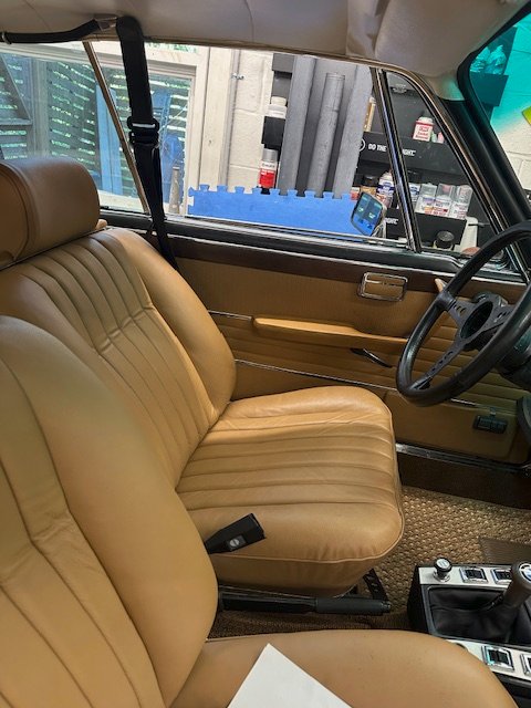

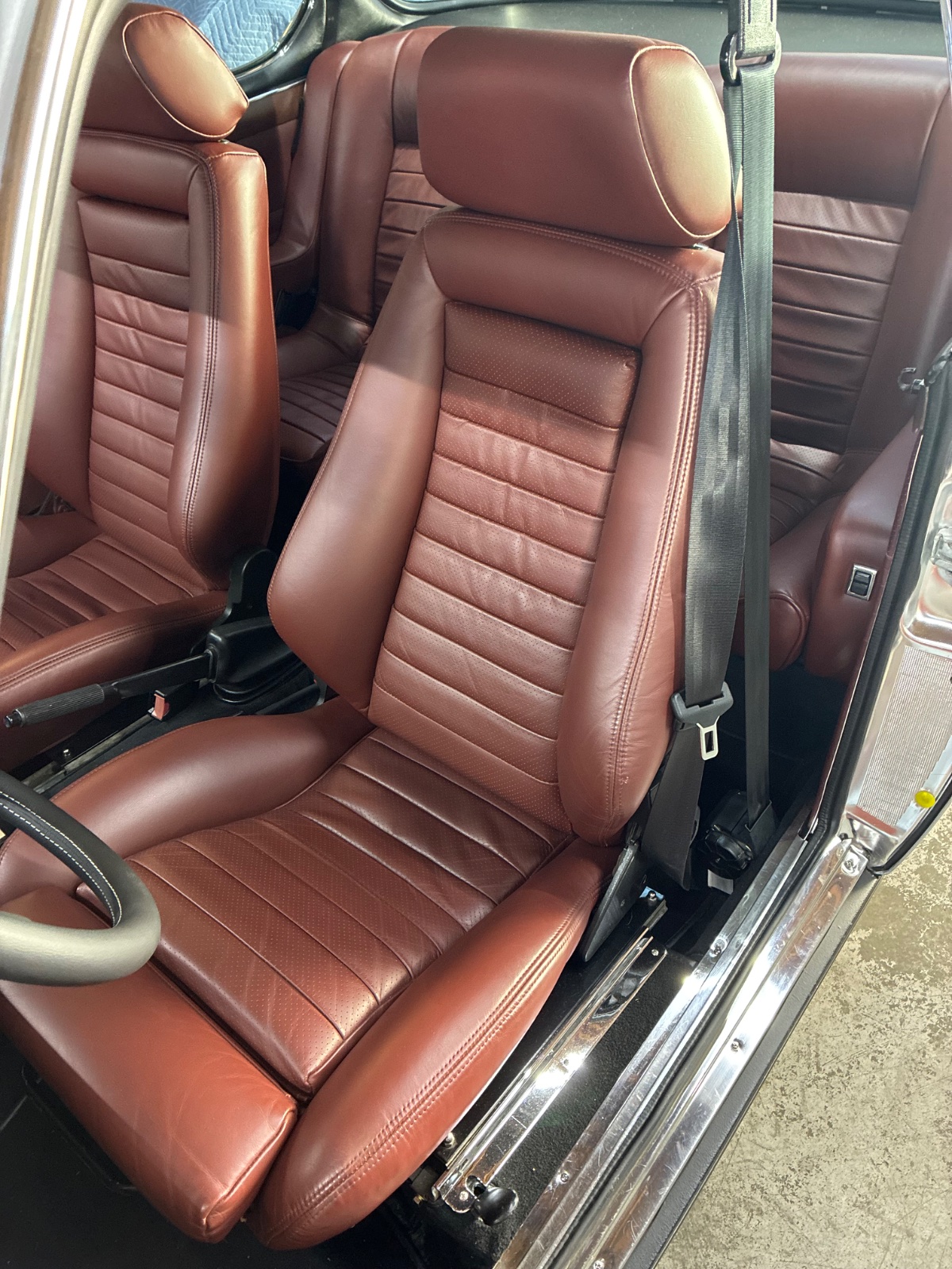

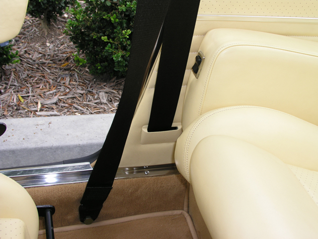

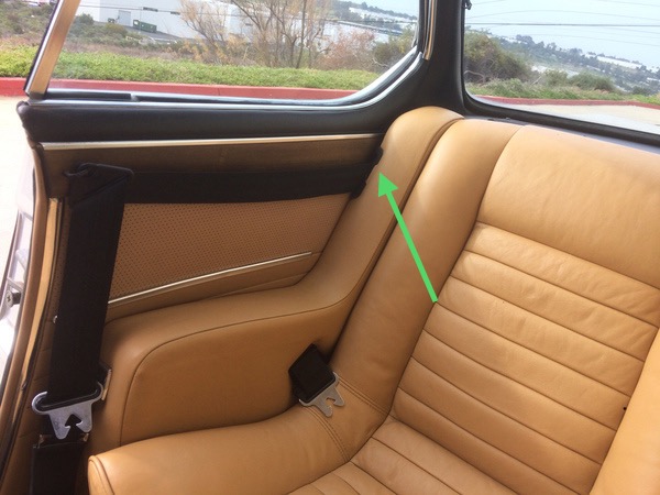

thanks Dan ... since i use Scheel sport seats, i don't have a horizontal bar on the headrest - just 2 verticals that are the same width as the headrest. my thought was to put the inertia wheel behind the seat in the original seatbelt mounting hole or at the bottom of the B pillar (steel would have to be added) - the belt go up and over the seat (that's the problem child) - connect across the seat and then dead end in the original seatbelt mouning hole.
always been intrigued by the approach that Paul Cain used in the first fjord car - no roof hoop is a problem, but either need to beef up the top of the B pillar to turn it there ... or figure out how to go over the top of the seat.

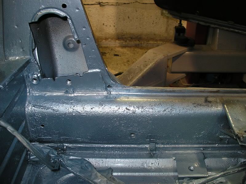

opening up the box a bit in the B pillar - probably adding a little steel at the bottom

i always felt this was a little suspect - would have to have some real steel at that pivot point.
It bolts into the steel behind the wood.
Sure, there's steel there, but is it robust enough to withstand the forces that will be put on it during a collision? I'd think it would be easier, with less cosmetic damage, to reinforce that area after removing the wood than to remove the headliner and reinforce the roof area for an attachment point.
Well Paul is an engineer and never cuts corners, it is probably beefed up as well.
i don't think that picture is of Paul's car. the one with the ivory interior was Paul's 3.8L with the beautiful way to let the seatbelt out of the side panel which went up to a roof hoop. the other one is somebody else's car, with the use of the e30 seatbelt bar on the floor ... i would be very happy if there was enough steel to support a seatbelt force on the existing B pillar ... but i don't think there is.
I really like the look of this solution, but I have to wonder - in a crash, would the belt tear through the leather/velcro and slide down to the lateral side of the seat, releasing the tension and allowing your body to move forward too far? Or... would the force be pulling it inward against the headrest? I guess it would depend on the angle of impact?
I also appreciated @eriknetherlands points about routing through the space under the headrest. It could dig into the seat material, and also compress the spine.

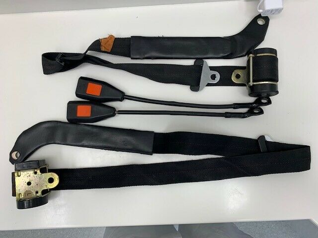

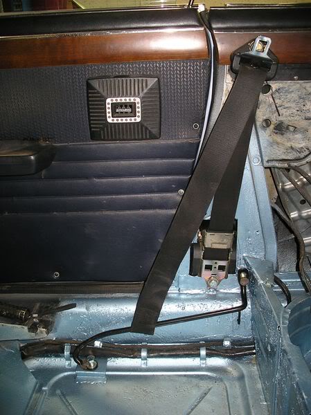

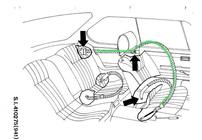

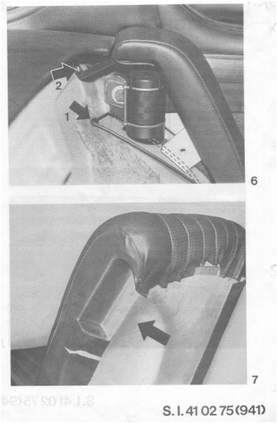

The face lift car seat belt system is the neatest of all and being that it’s a factory design TÜV approved, surely as secure as possible!

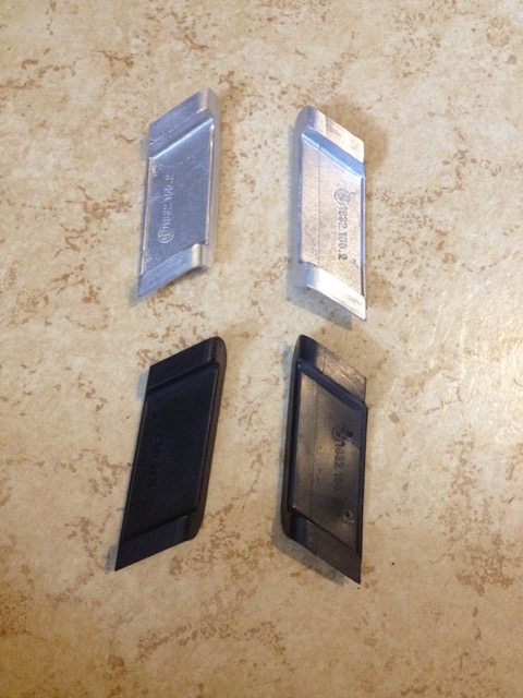

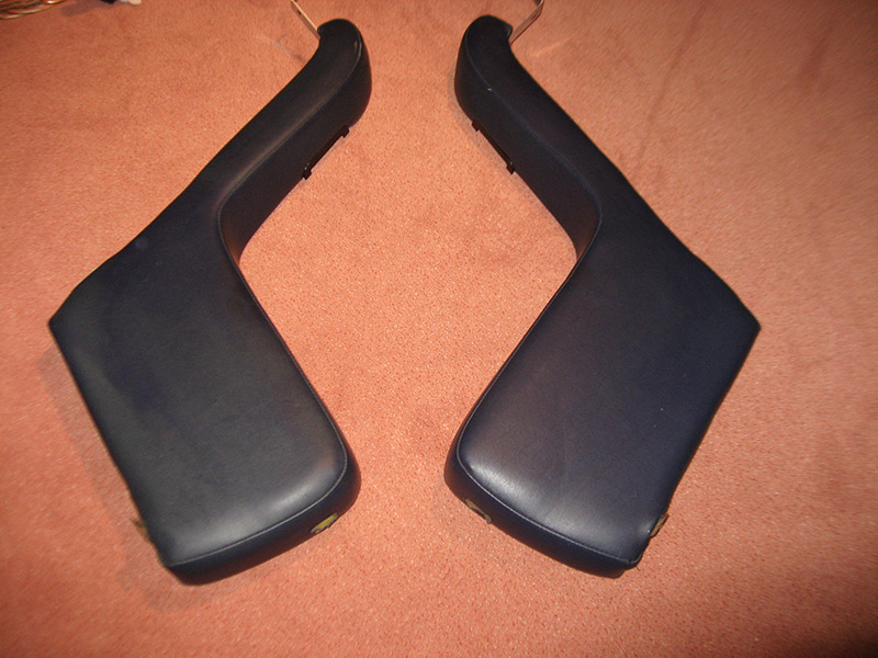

Apart from the seatbelts which are hockey stick design, the armrests specific for this system is available thru cs-Werke + the few plastic bits. The only real job is to add a nut/ bolt higher up on the wheelwell to get the belt retractor position to slide in and out.

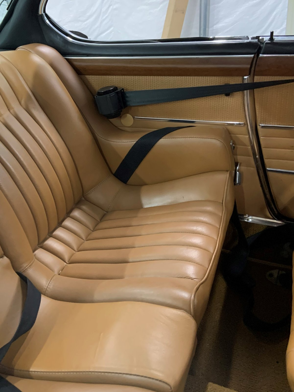

i agree @Keshav that the version you have linked looks the cleanest, as the appearance of both belts (front and rear) are improved from the current in my car shown here. The rear belts look to emerge from within the armrest rather than from the space between the armrest and seat. As a newer member here I’m not familiar with all of the various places to source parts. Can you provide a link to the cs-Werke page with the armrests? Thanks…
Ideally you’d want to shop around for all parts from a 1974/75 E9 coupe in the US.
The arm rests can be ordered from Christoph, see link. He states that he could also alter your current ones thus keeping them original, color etc. If someone wants new armrests, send a request to Christoph.

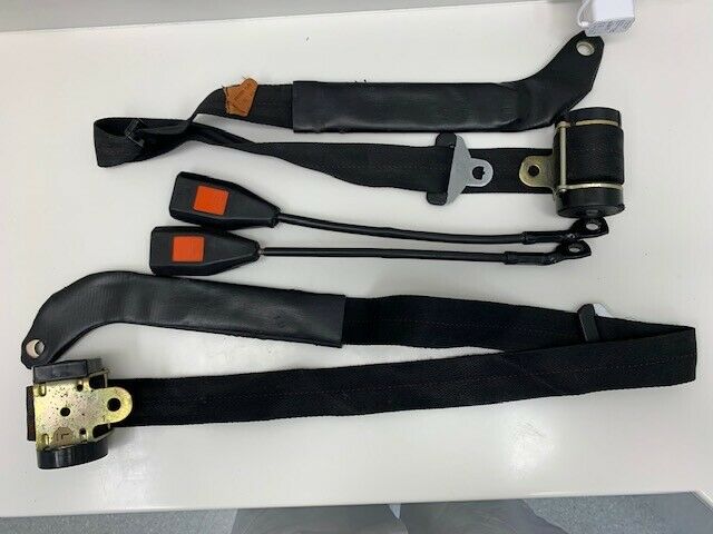

Seat belts with retractors can be ordered via @TomHom (everything else too)
I have ordered 3 more sets. These belts are simple to install and work great.

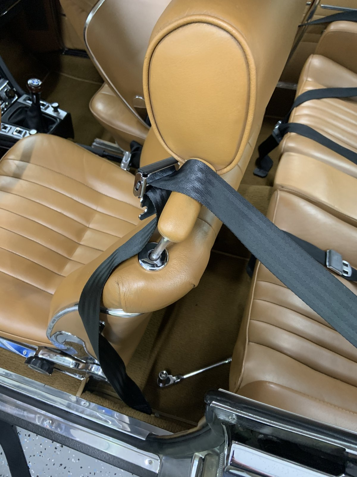

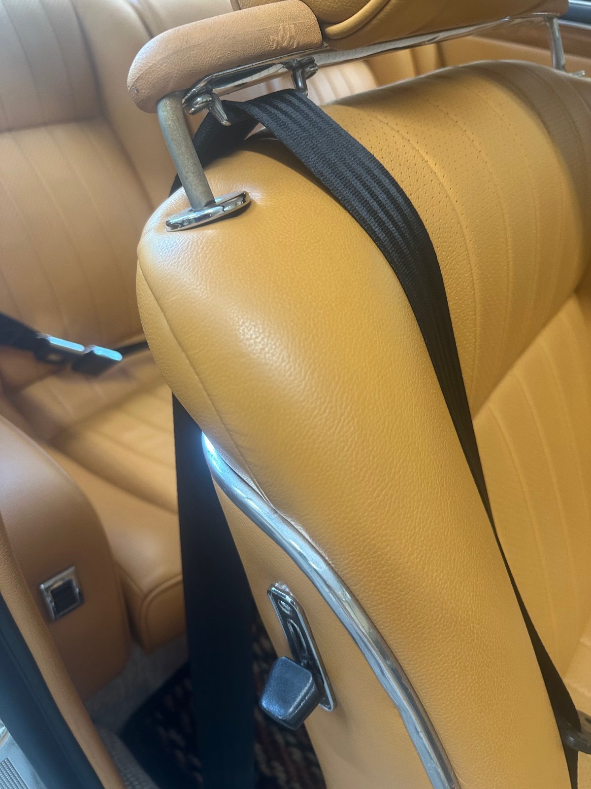

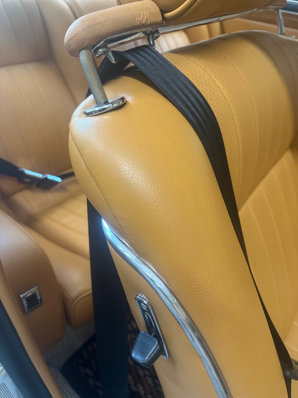

Very interesting to see all the different approaches. Here is what my 1971 Coupe came to me with. Note the routing of the belt through a guide that attaches to the bottom of the headrest, and not routed directly over the seat. Thinking of what Erik said, perhaps this is a reasonable solution.
That under-headrest guide is definitely intriguing - seems like it would be something original but sounds like you’re the only one with it?
Yeah I agree, this looks really nice. @BimRLuvR how is it attached? If it is screwed in, those could fail as it is pulled downward in a crash.
I might do something similar, but attach it to the top of the headrest bar. Maybe pass some bolts through the rubberized part, and the washers/nuts would be less visible underneath? Or just a rectangular metal loop with some stainless cable ties as a less permanent solution? It would be similar to what @Dan Wood has, but a stronger attachment to avoid the belt slipping to the side of the seat in a crash.
