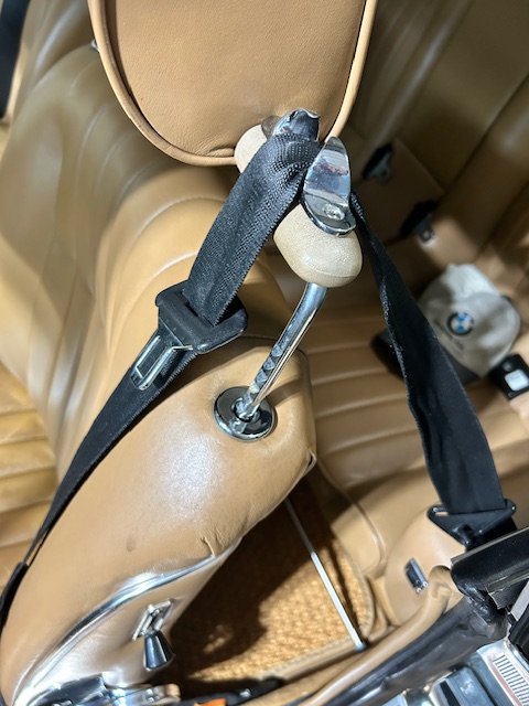

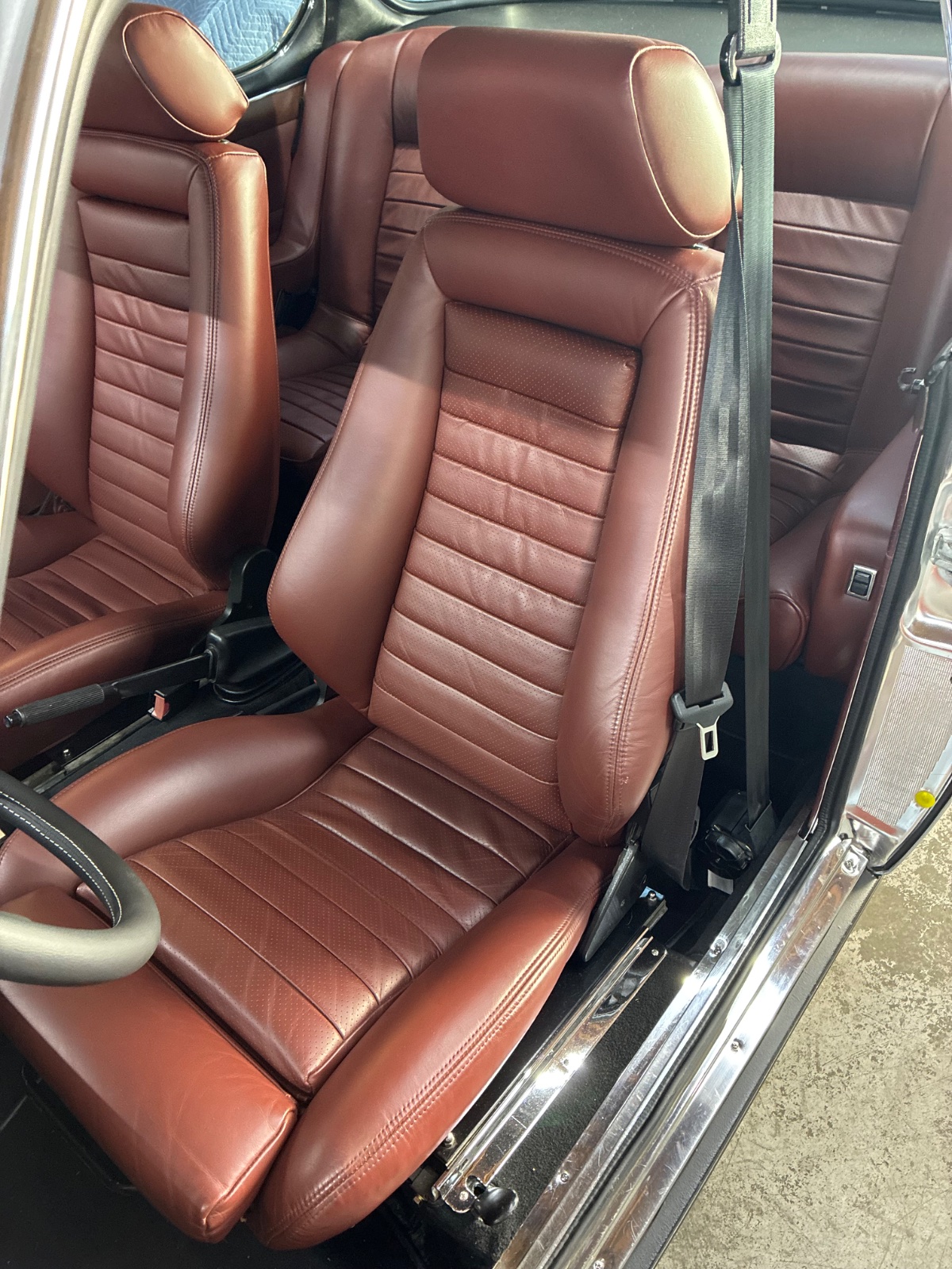

Here's my "solution." Far from ideal but it keeps the shoulder belt from falling off. I zip-tied these chrome marine brackets to the headrest bar. Given that my vertical headrest adjustment has defied all manner of persuasion, I hope it would continue its frozen state in a crash. But my life insurance is paid up.

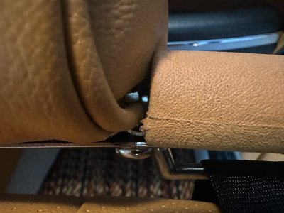

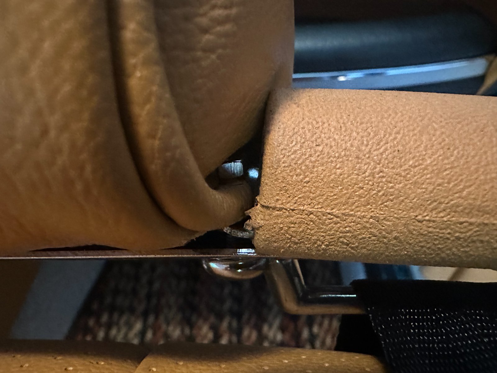

I actually really like that! You can still slip the belt out to fold the seat. It looks like it is screwed in there - are the cable ties hidden under the belt?
Here is another pic @Minivansomeren. I looked closely and see it is screwed in to a beefy truss bar that runs the length of the headrest. A lot like @dbowers solution, just inverted. Hope this helps!

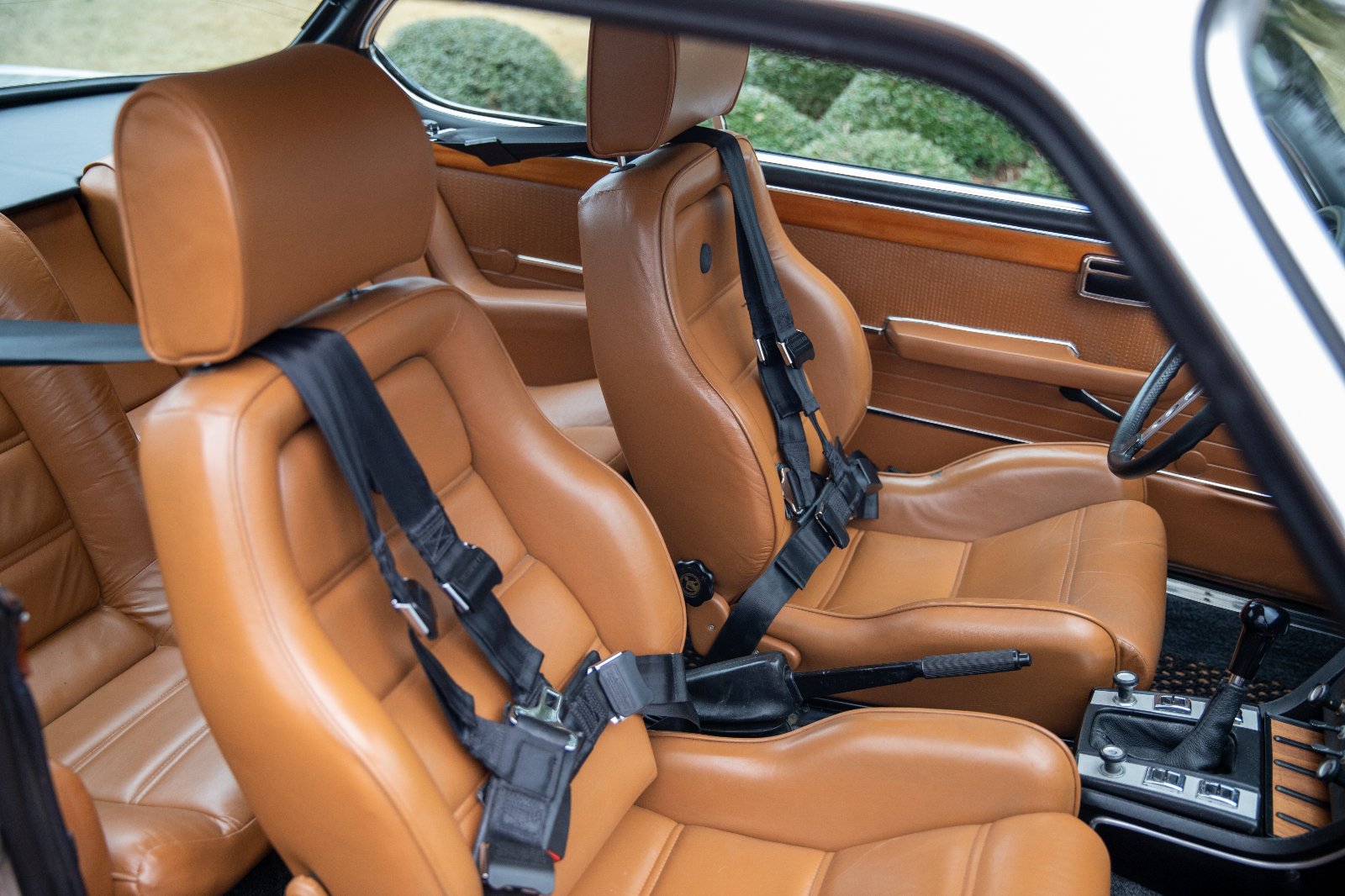

So, about ten years ago now I toured VSR (with @Stan and Chris Auty making introductions), and Mario had sitting in the shop a 2002 with Shroth rally harness that he had installed. I talked with Mario about this setup, and looked into it, and decided to install it in my car. Makes the back seat unusable, and the look is not at all factory, but I think its the safest setup I could put into the car (and while I don't dispute Erik's estimate that seat belts are only 20% of your safety in a crash, the question I was addressing is which seat belts would be the most helpful.) Not only are these belts designed to attach in the parcel shelf, they have a set of tensioners that act in a crash (based on yaw sensors) to pull you back into the seat like modern seat belts. These tensioners also are completely free when they have power to them, so they don't restrict your ability to move forward naturally to say, operate the a/c controls.

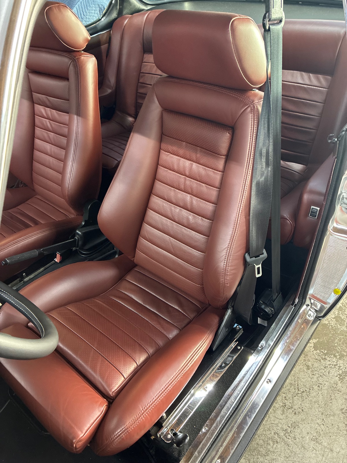

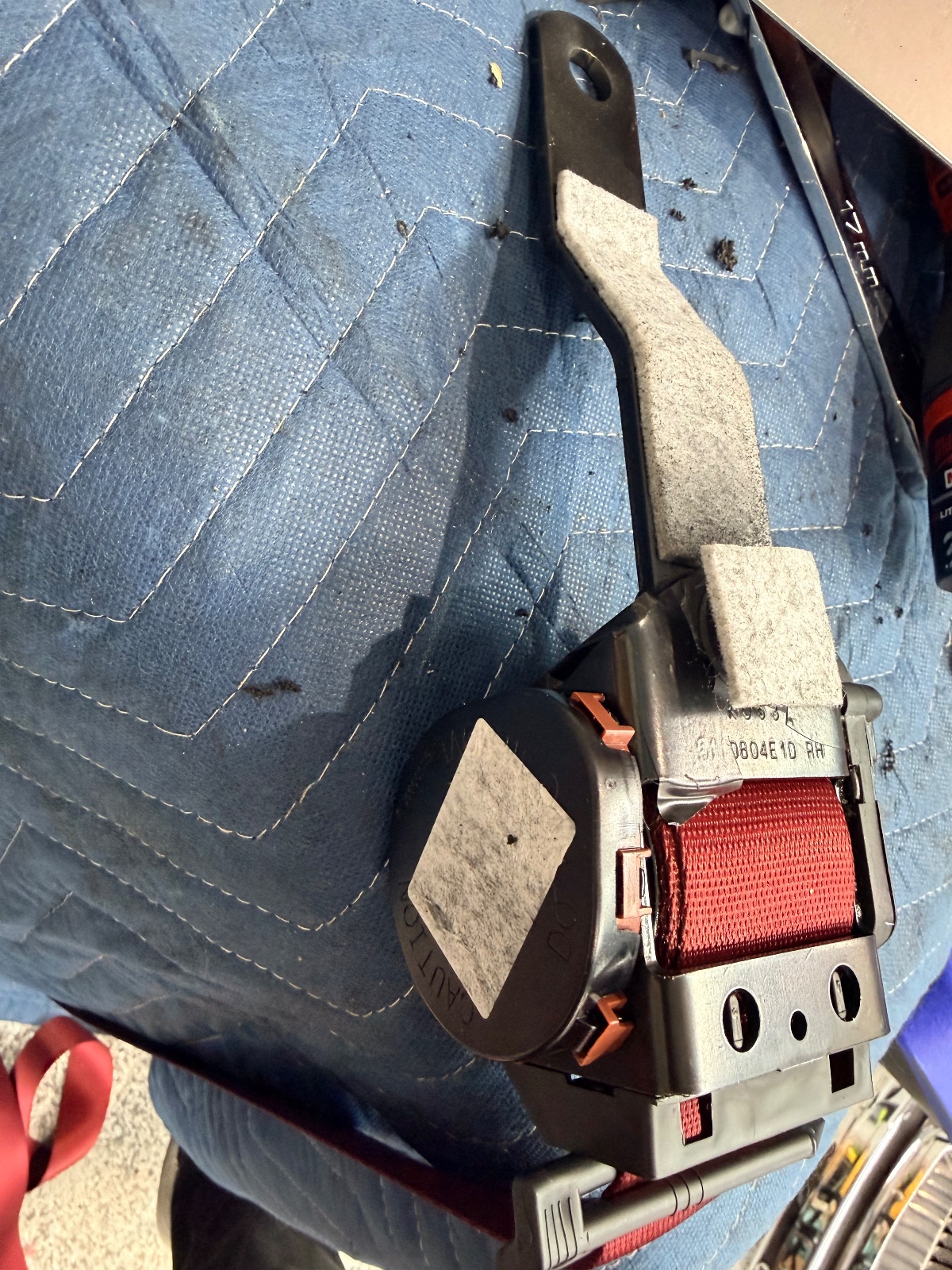

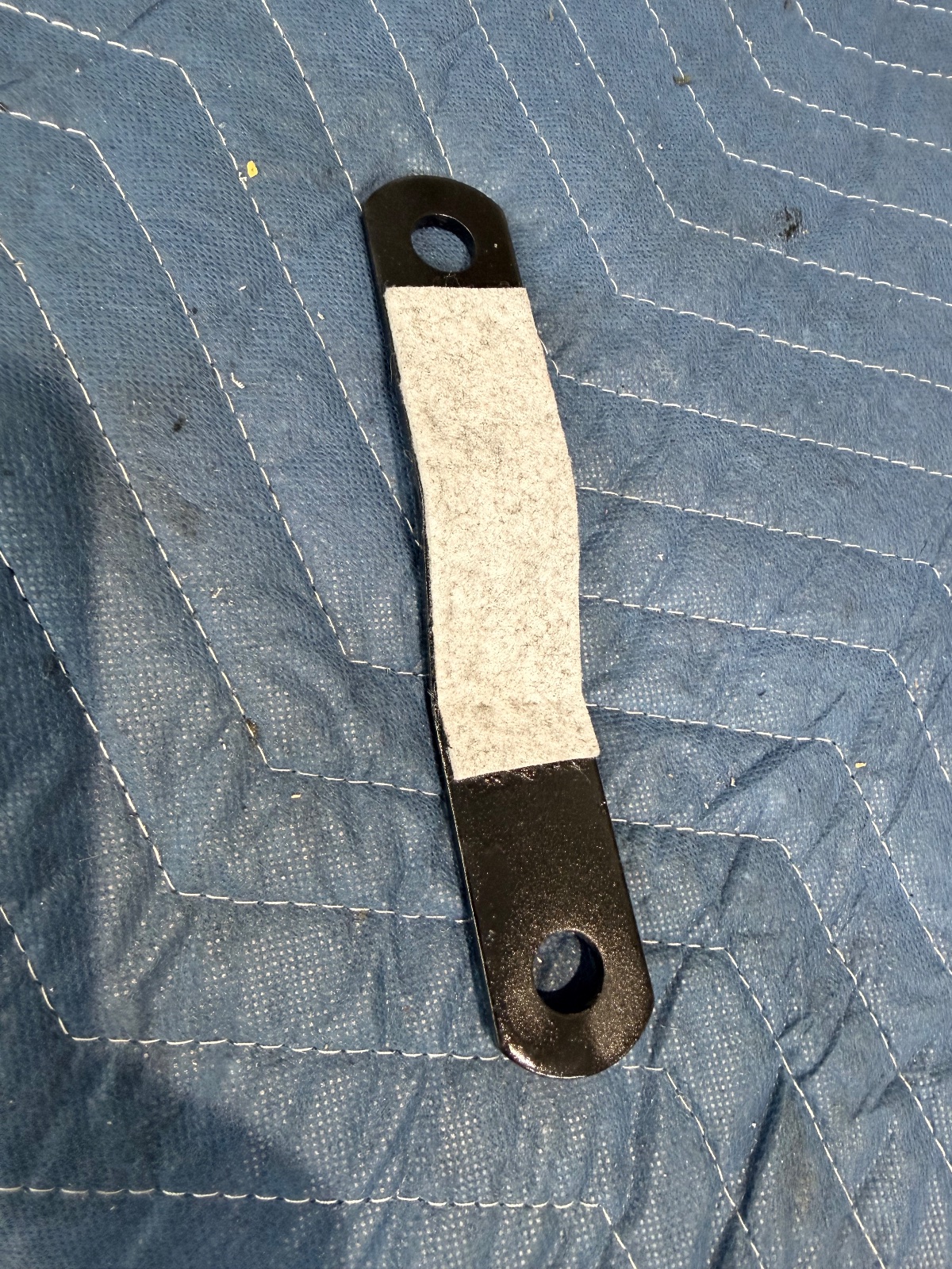

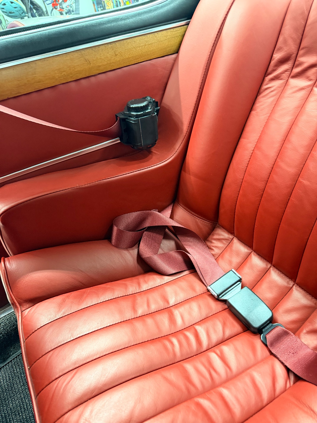

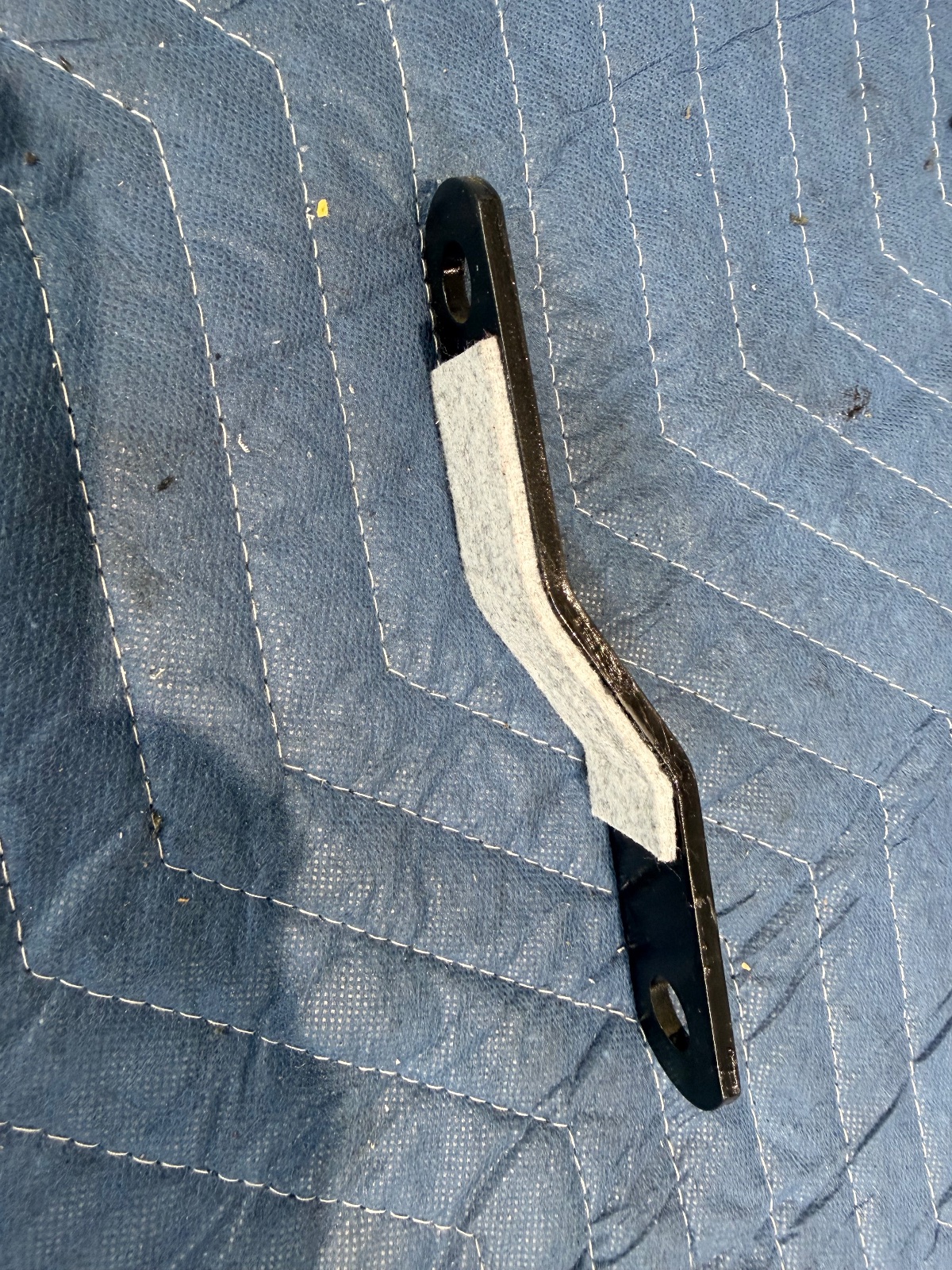

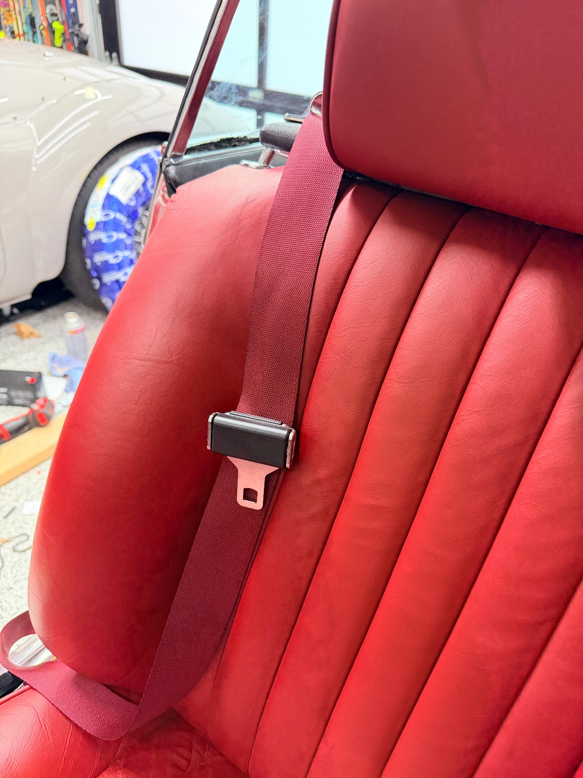

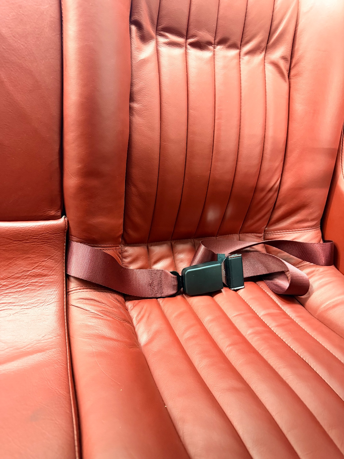

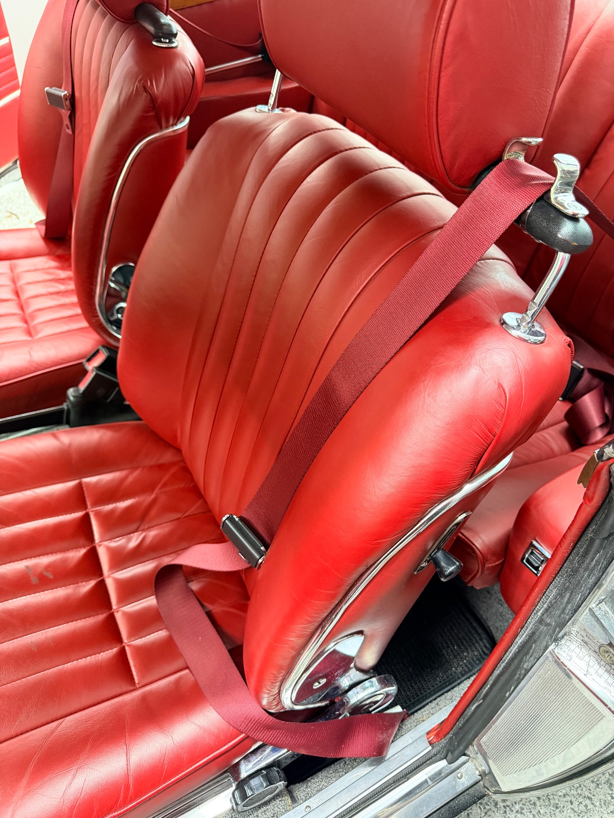

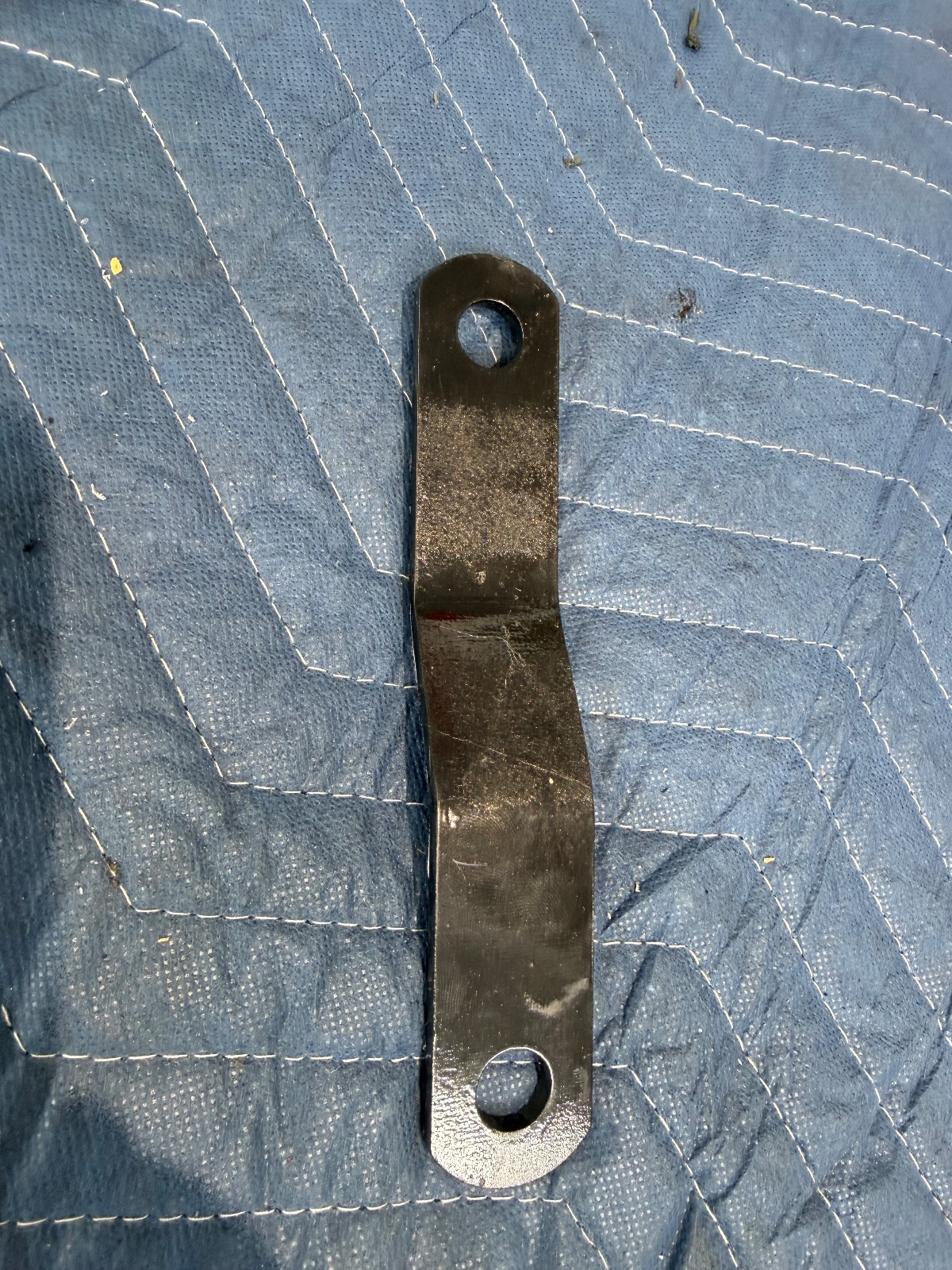

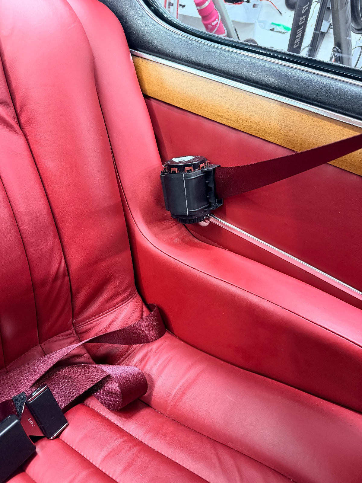

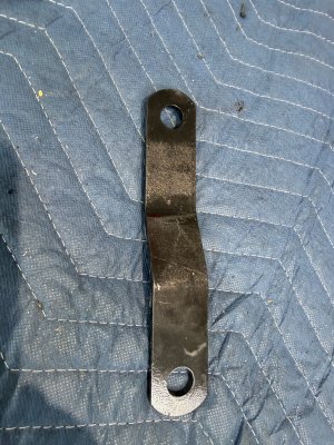

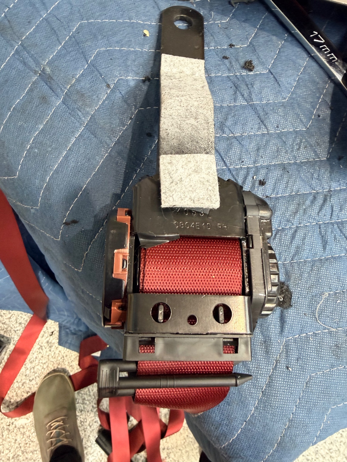

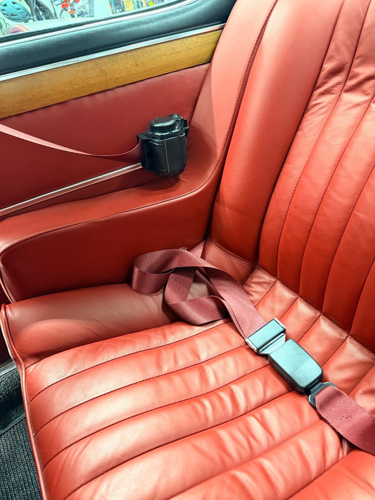

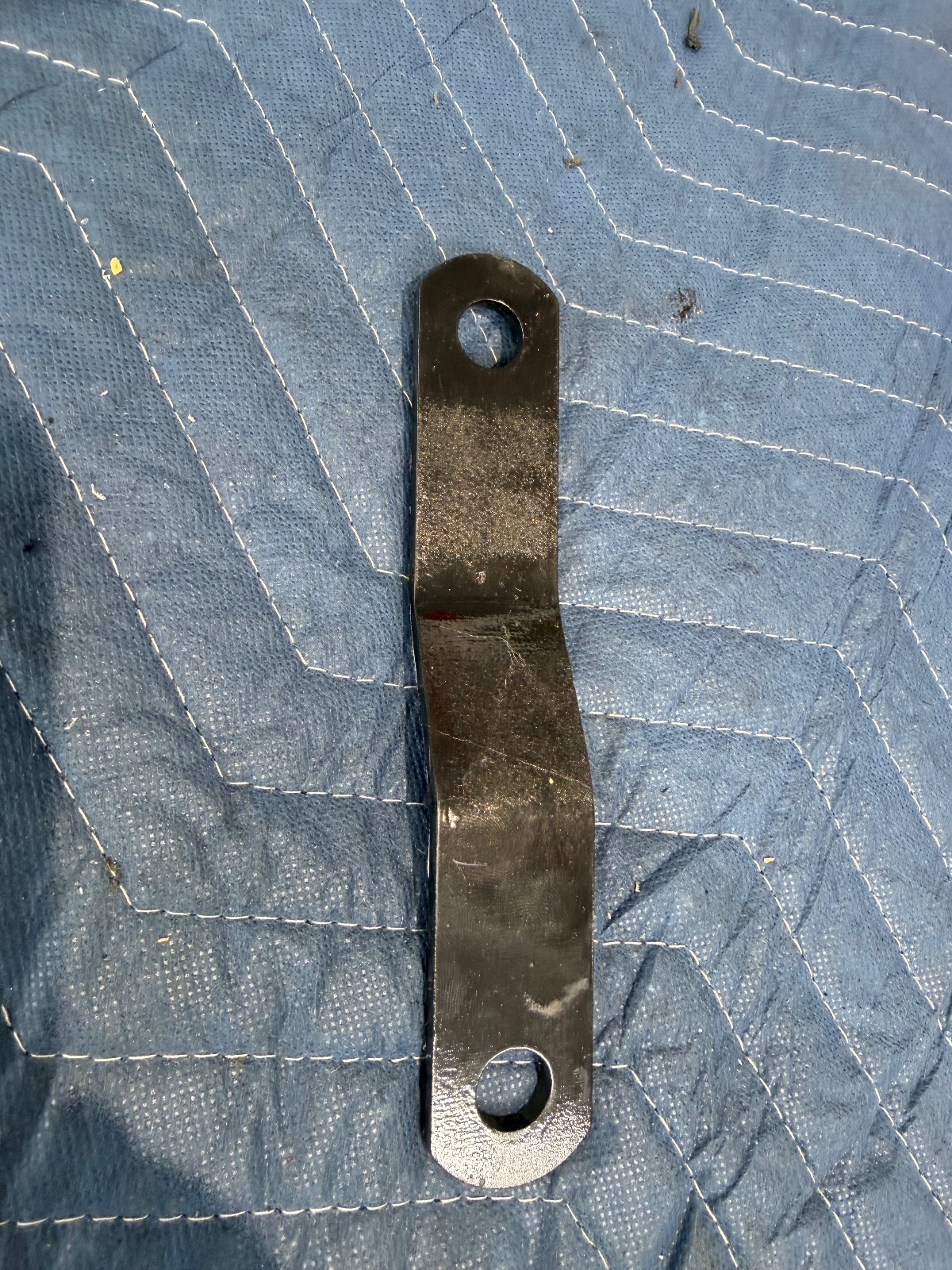

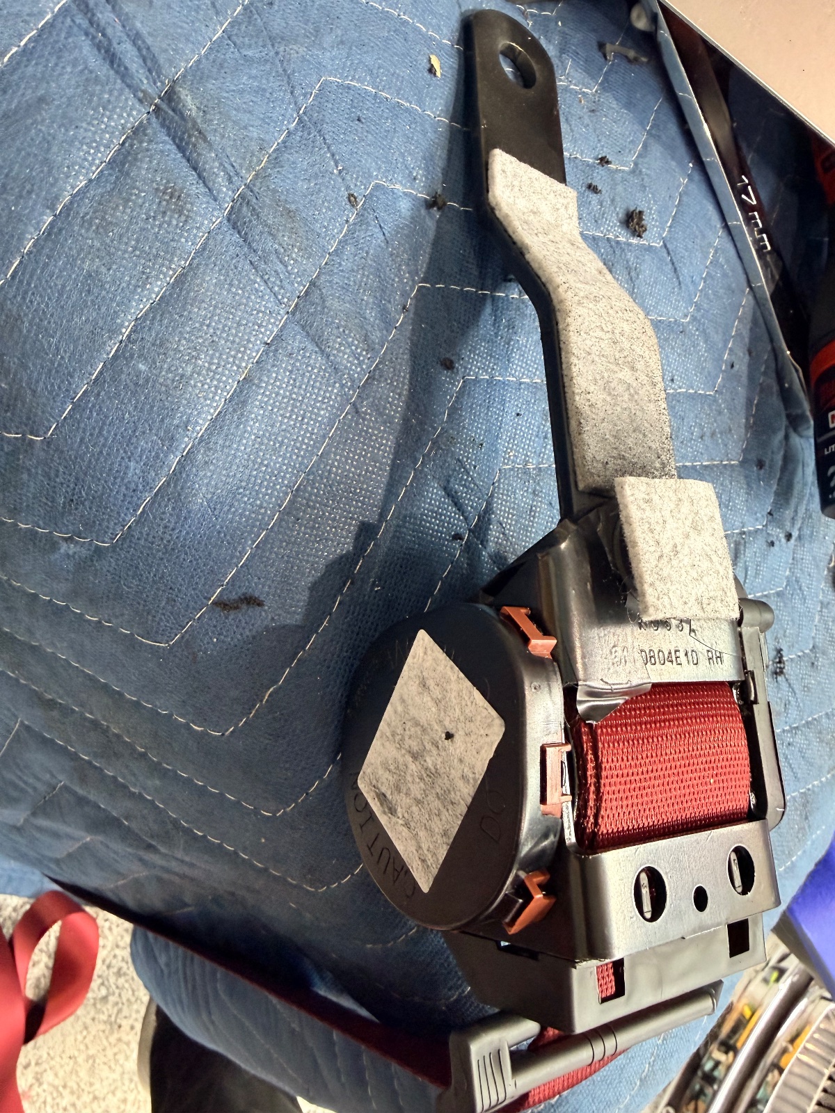

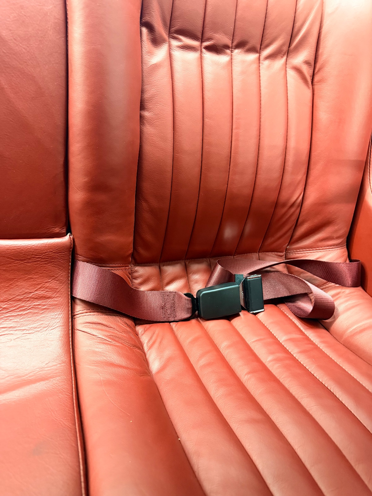

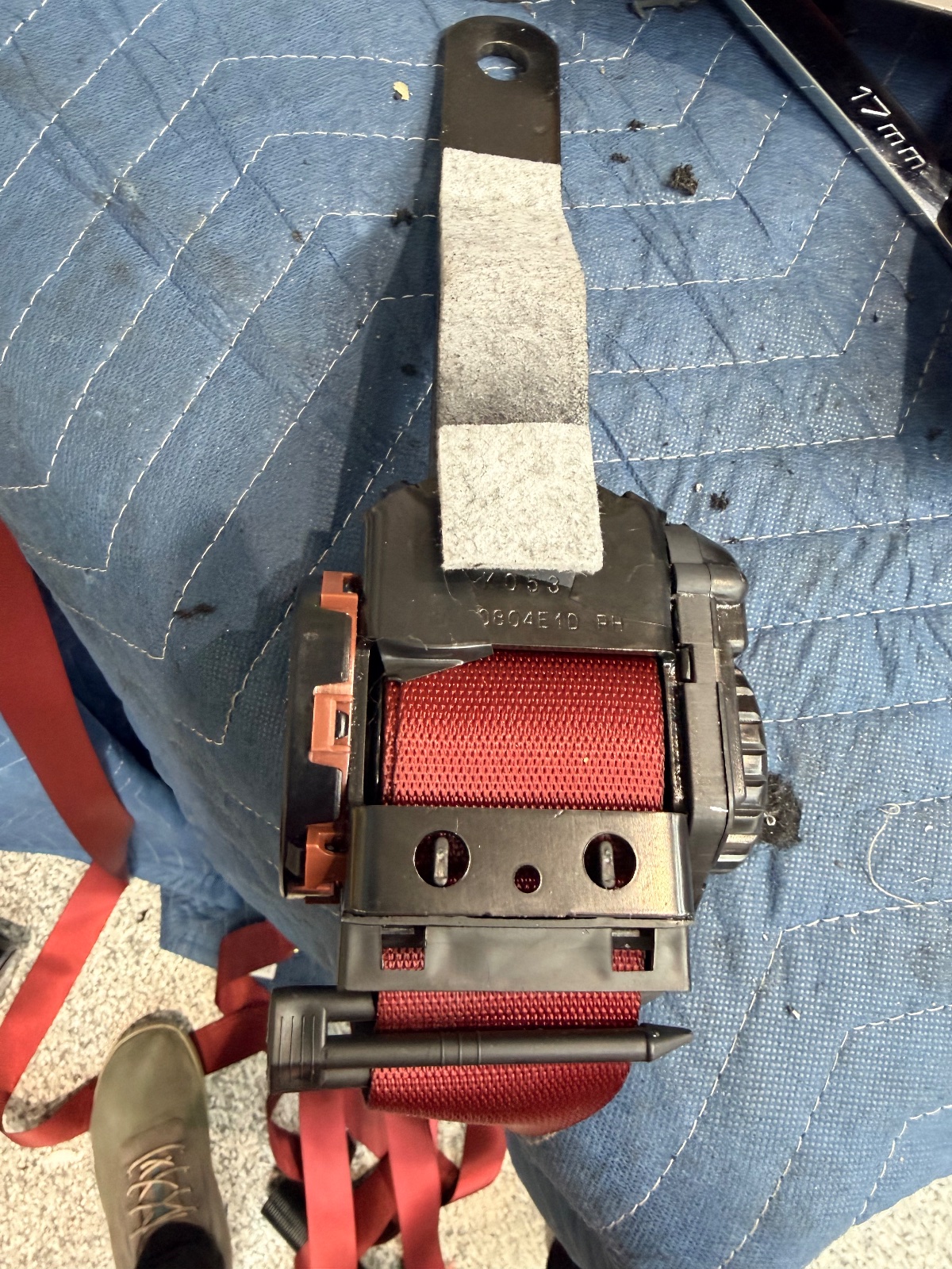

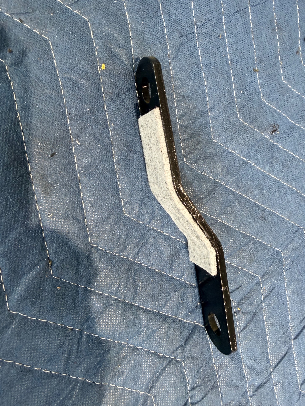

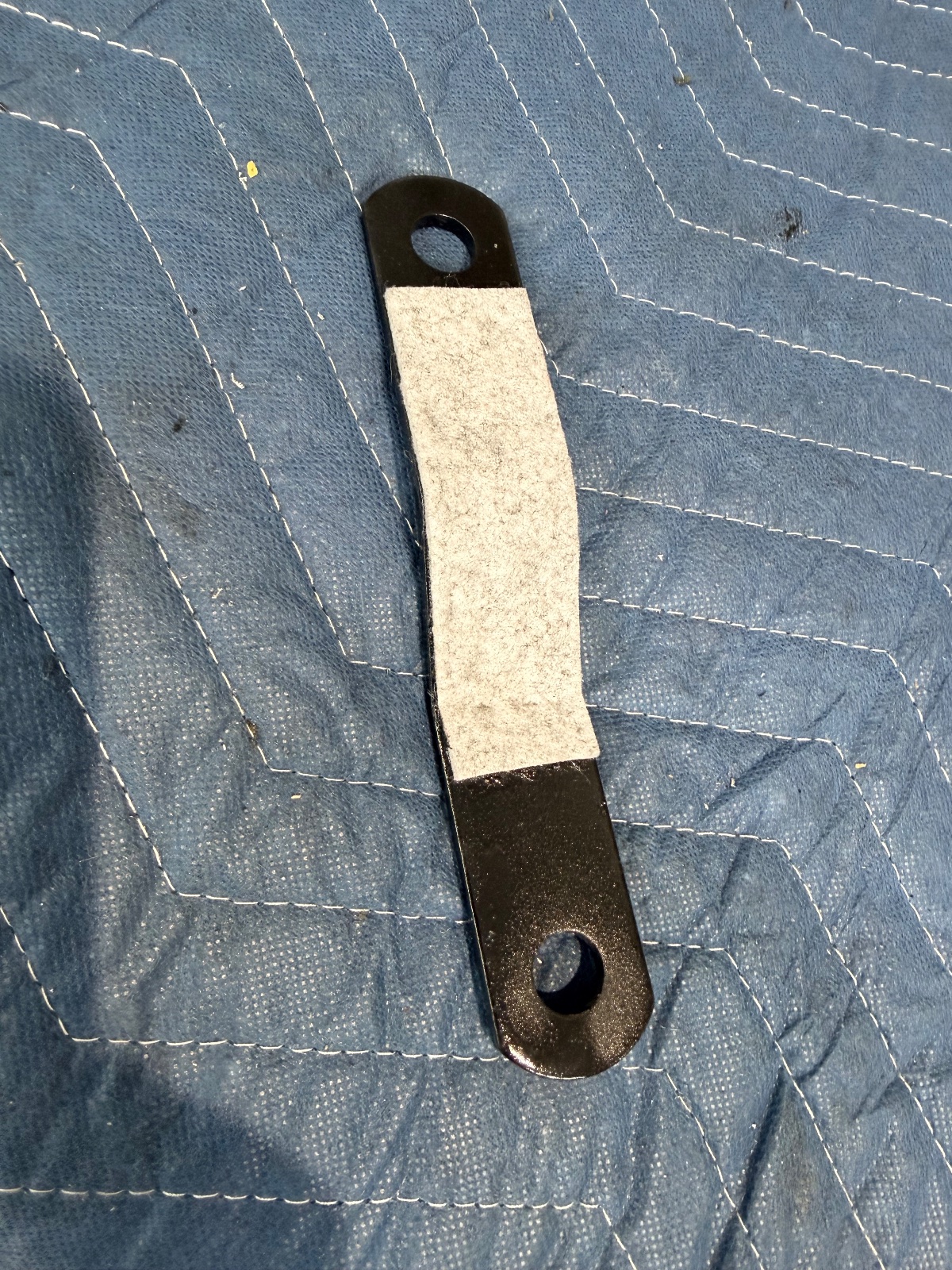

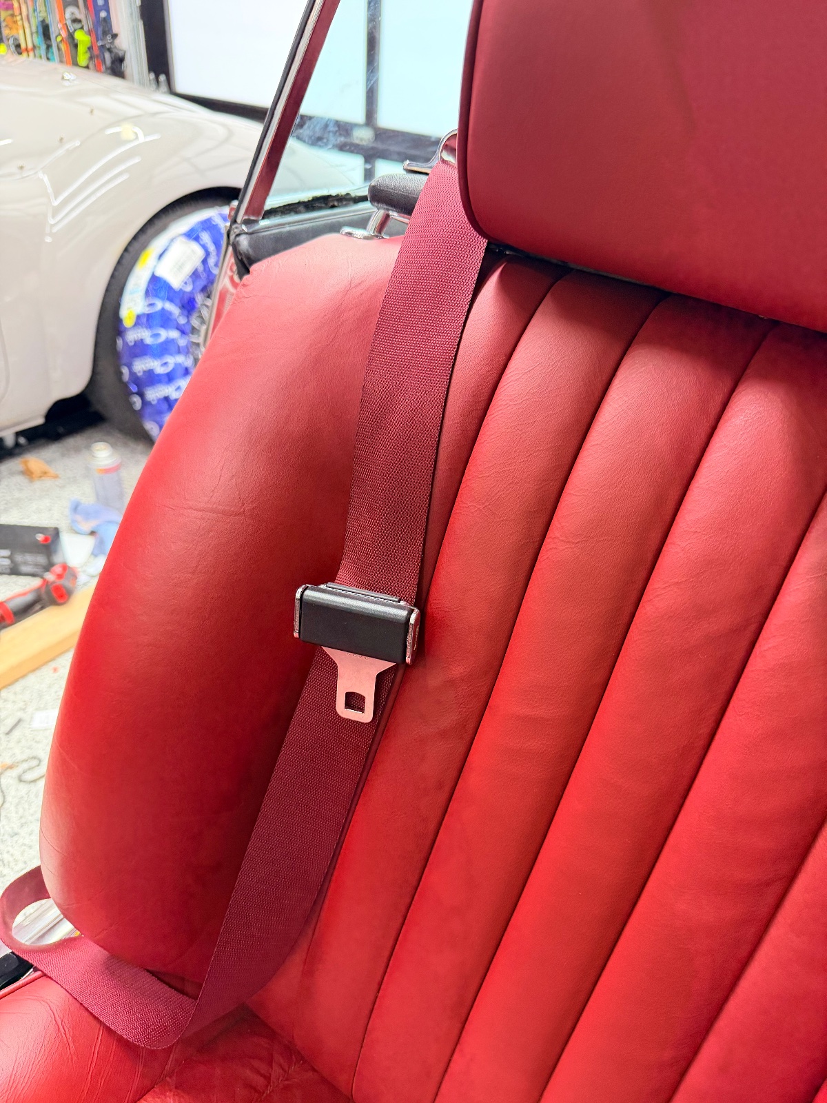

Thought I’d provide an update. After much internal debate I decided to go @Dan Wood method with the retractable seatbelt. I don’t have an attachment point in the headliner so Al’s belts wouldn’t work for me. This method involved a bit of work - I got the seatbelts from SeatbeltPlanet along with the metal seatbelt extension, which I then had to bend into this shape to go past the edge of the rear panel. I also put some felt underneath the metal so it wouldn’t mar the leather. I also added the portion to hold the belt onto the shoulder bracket. The seatbelt is a little long but I’ll adjust that this week - that’s a me issue not the method.
Let me know if anyone needs the bend metal part, I could probably rig up a few without too much difficulty.

And just to be clear, the belt is still mounted to a factory attachment point, using an extension that I ordered from the seatbelt supplier, so theoretically this is as safe (or not) as the original belts. The piece on the shoulder bolster is not in any ways structural or trying to be, it just keeps the belt from sliding off the side of that bolster.
