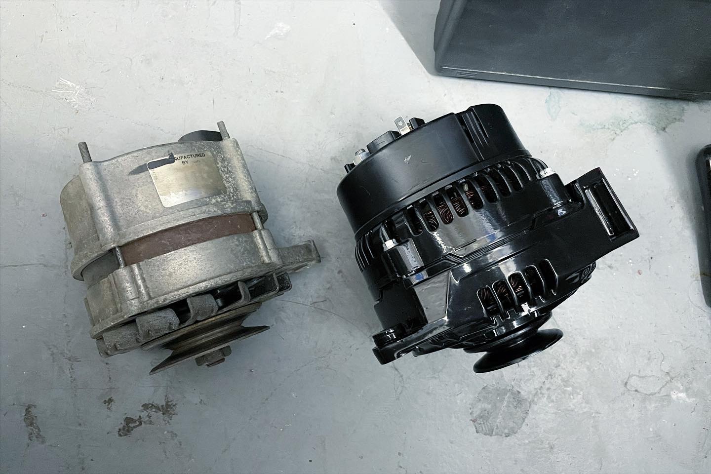

Ok, following up on this one. I swapped the alternator with an upgraded one from BNR parts. Some fittment notes if you go with them. The 250amp e9 alternator they sell is a different housing than the standard AL45x. The stock oil filter doesn’t have enough clearance for the plastic back and cables, but the e28 housing gives about 1/2” of clearance. Otherwise it fit up and works well. No more L-light.
