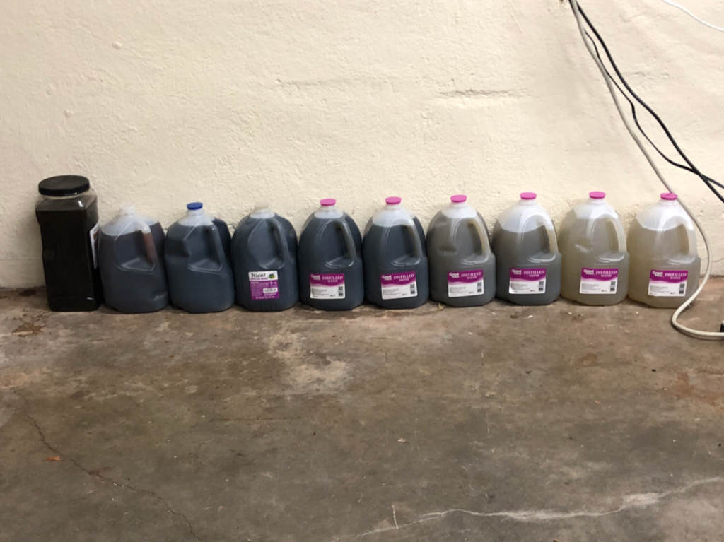

Flushing the cooling system in 5 acts. And this is after replacing the radiator, water pump, thermostat housing, and all hoses.
In case
