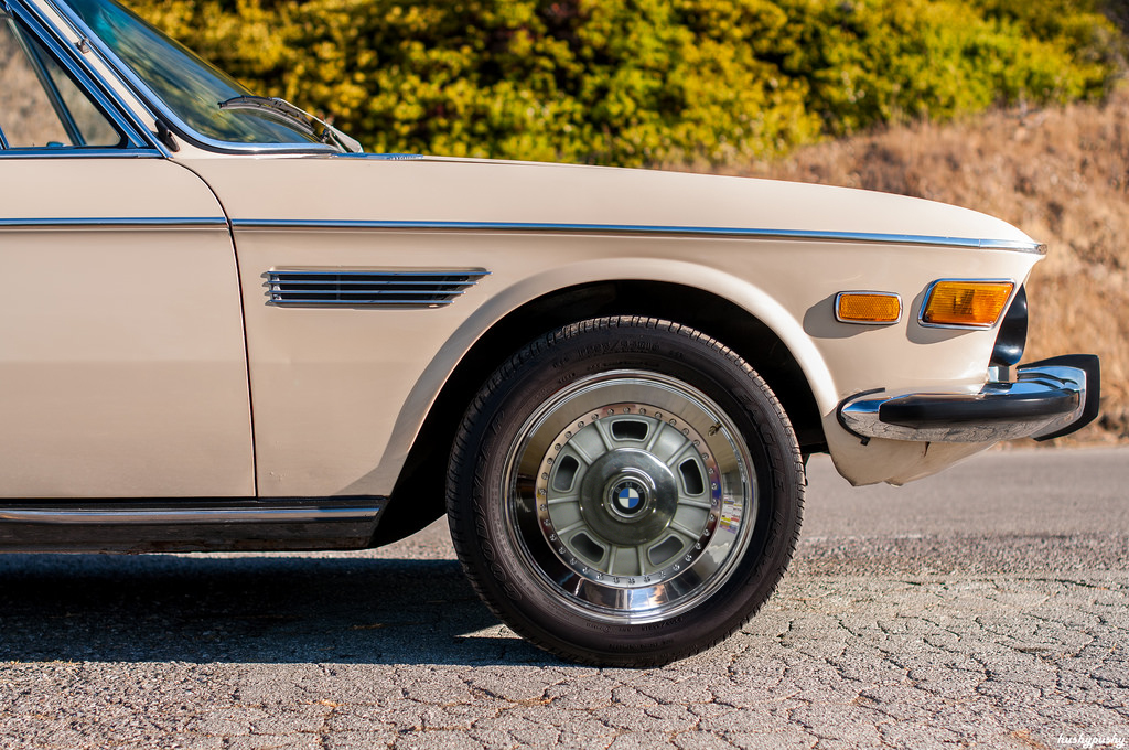

I'm having fun with Photoshop and day dreaming my commute home. There are several custom wheel builders that will convert OEM wheels to 3 piece. I spoke to a local builder yesterday that uses BBS lips and barrels. I threw this together in Photoshop, and stuck the fake wheel on Brendan's car (hopefully this is okay Brendan).
In reality fabricating this wheel would be challenging, as the metal on the factory wheel face is only about .25" thick. A support ring would need to be tig welded to the back side. Still doable- just expensive.
The example below uses a more vintage styled angled lip, and is a 16" wheel. Given the factory offset, I don't think you could get more than 2" of "Dish" out of these wheels. I'm not sold on the concept. This is just for fun given that the wheels would cost a few thousand dollars. Group by anyone? :D

Not a fan of that design. A 16" or 17" version of the stock slotted wheel might look cool though.

Also not a fan, the polished rim vs the painted center looks odd and the wheel still looks small as the focus is on the center
