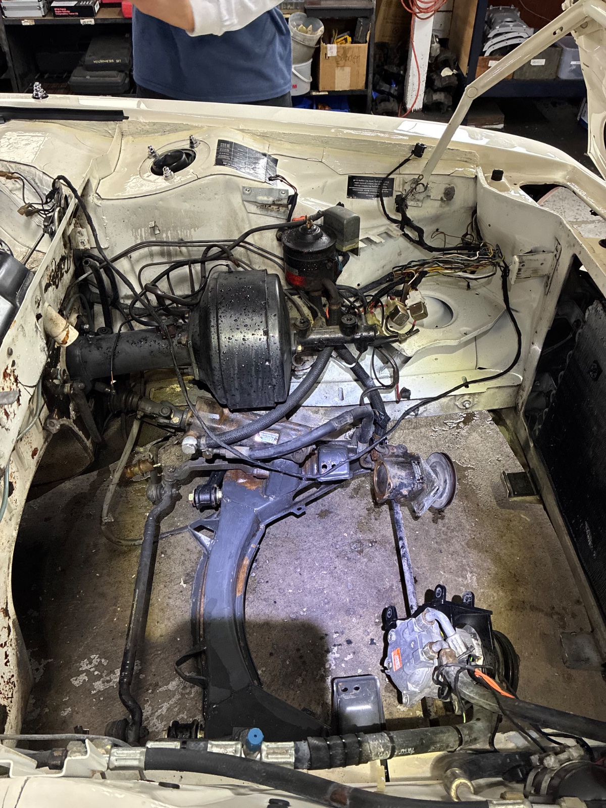

All good thoughts - found a HVLP gun and figure with the compressor I should be good to go. And Don, I will spend a lot of time prepping and I am also a Simple Green cleaner guy. My hope though was that the dry ice blasting will do the yeoman's work for me and I will just be doing the last bit clean-up. I'll make sure to take pre-post photos. Thanks for all of the tips so far. This week will be peeling off the bitumen and disconnecting everything in preparation for lifting out that engine this weekend when I can get some help. Lots of photos will be taken to make sure it all goes back together correctly! I also very much appreciate the photos in Steve's thread since he has it all laid out so nicely.

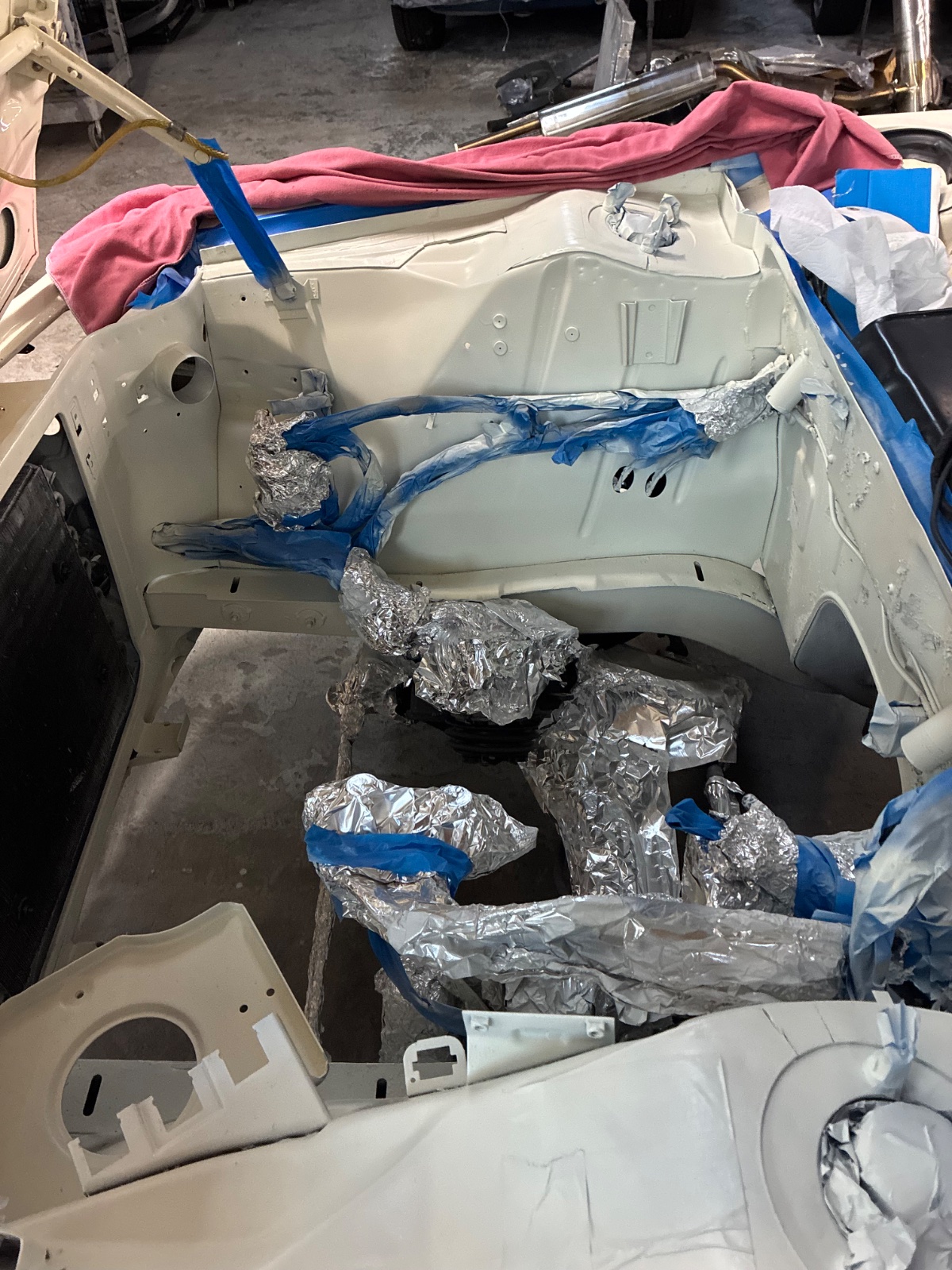

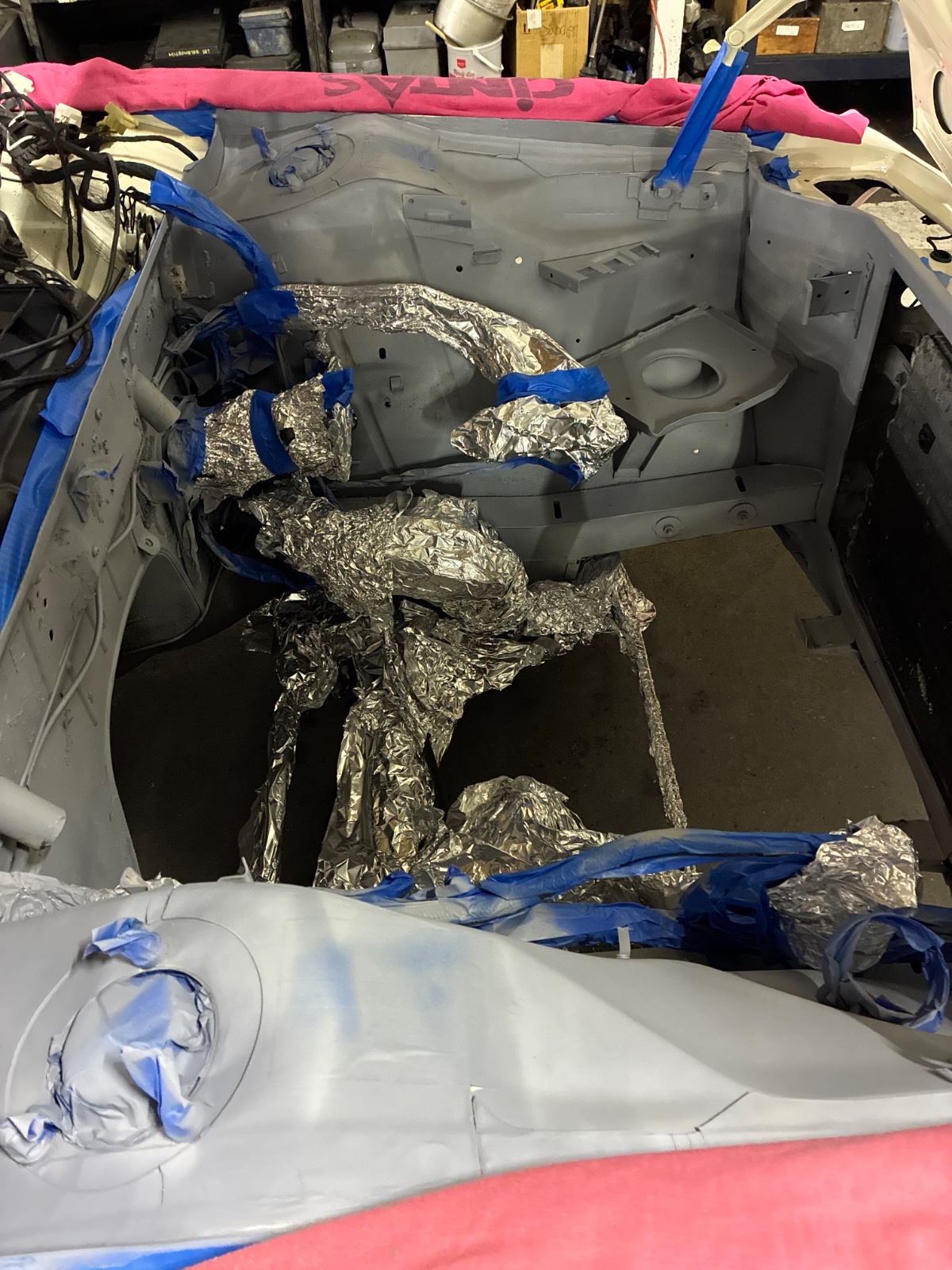

The rattle cans work well for an engine bay because once everything is back in, you don't see a large percentage of it. A high quality mixed spray paint in a can with a good nozzle can lay down paint surprisingly well, unlike a hardware store can. Then a 2k clear will make it all purty, stain resistant, and hide small flaws. I thought about going the gun/compressor route as I have a 60 gallon one with plenty of CFM. I would certainly use it for exterior or large panels as Scott mentions but for under the hood I didn't want to mess with measuring paint, mixing, removing all water from the lines, cleaning everything etc etc for each coat. Not to mention the $$$$. If I ran out of paint or messed up like when I put the wrong honey comb fender insulation on, I'd just order a couple more cans from the supplier and redo it. They got to know me pretty well by the end of it.

Any thoughts on dropping the engine and transmission out the bottom with the subframe? I am considering doing that on my recently acquired 1972 E3 Bavaria to clean up and reseal the engine and transmission and rebuild the front suspension and steering. I have done it that way on a couple of 2002's and it worked great. It helps that i have a lift, but have done it without one as well.
Also Curious what the dry ice blasting is costing you. I asked for a quote at a shop here in N. Virginia and it was between$2K and $4K - Ouch!! Would also be interested in seeing before and after pics.
I don't have a lift that would make it easy so I think it's coming out the top.
The dry ice blasting is $1000 for underside, $500 for all wheel wells and $500 for engine bay. I will definitely take some pictures before and after. The primary motivation was the underside, since I spent an hour cleaning an inch of grime off the front driver side and it looked better but not great. From there the wheel wells seemed obvious and then the whole motivation for THIS thread was whether the work of removing the engine to get it cleaned and then me repainting was worth it. Clearly I've decided yes.

At this point I figure since the underside is as clean as it's going to be I'll probably re-spray it with some rustproofing and then will prep/paint the engine bay and may decide to include the wheel wells once I get an idea how they look now.
