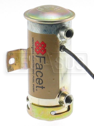

Don't know what pump it is, just happen to see that it's a small cube near the diff. when I was looking at the brake pressure regulator~
Sounds like a Facet fuel pump. Does it look like:
There is nothing wrong with those, but assuming that fuel pressure is among your issues, that pump may be undersized for a 3.2L, triple Weber set-up (some versions of that configuration pump are only rated at 15 GPH). Or the pump may simply be failing.
I prefer the larger Facet pumps which can deliver up to 34 GPH. Just be sure to get a low pressure model.
