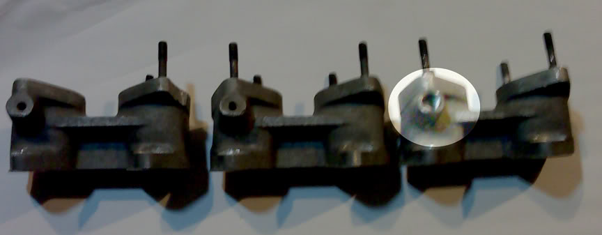

4) Manifold question: In my old parts archive pic below (parts off site currently), are these holes mount locations for the linkage hardware/eyebolts? circled mount appears to need repair/tap/helicoil..

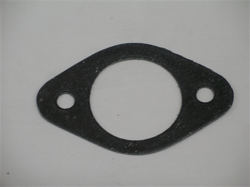

2. Negatory, soft mounts are not needed, will also sentence you to frustration and mental torture, a simple base gasket is the way to go:

4. If the larger one is threaded then yes, it should be the vacuum port for the brake booster. Would go in the #2 position with the others at 1 & 3. If you use the coupling linkage it can go in #1 spot. Show a close up pic of that hole.
