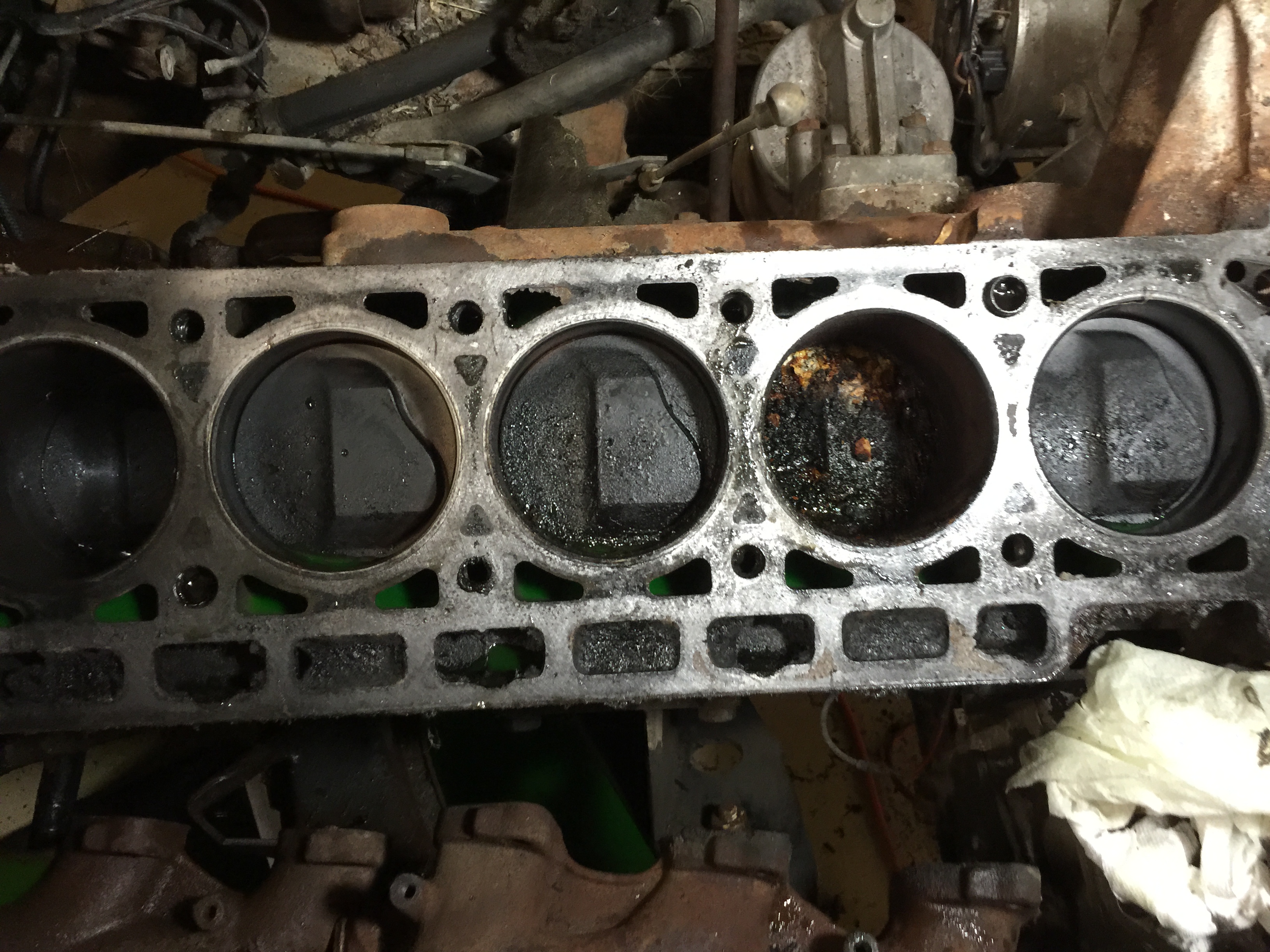

1st Photo , May 2015 .... of the spark plug shows the residue left from coolant leak. Oops ! But apparently that is very common with almost all early E9 since the all had very weak allun head which either warped or cracked having had to be replaced with much newer heads....

Yeah that is a US car. I wonder what block you have in there. When you are free you should check the flat spot on the block right above where the starter bolts up. It should be easy to see with the head off, but you'll likely need to wipe it down. You should find a VIN or a serial number.
Markos
I left the block in May of 2015 at the machine shop while I was looking for a replacement piston.... since I wasn't sure if it was worth a rebuild I left it there . I stopped by two months ago and the shop owner wasn't there but his worker took me back where they keep such stuff and it wasn't there. If it is important I can go back and hunt it down...
Couldn't find another piston like it... may be I didn't look in the right places. I wasn't familiar with this forum then!!
