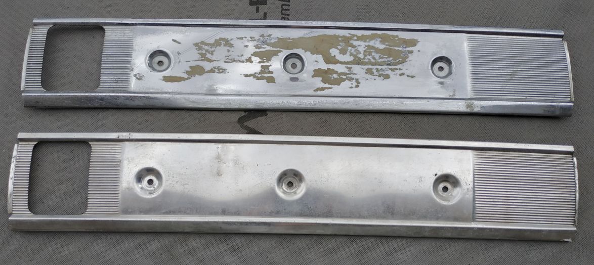

Here are both to show the difference. Aluminum is the top one I replaced it with a re-chromed brass which to me is a better aesthetic with the tail lights & bumper.
So the question seems to be still open - what was the difference? Which models were equipped with an aluminum and which with a brass parts as also facelift E9s panels were available in two variants?
Thanks @HB Chris . I thought someone can tell the model year. Parts have no markings except weight. I will try to figure out.

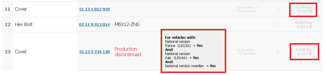

BMW catalog is helping only partially (telling by weight)... parts 11 and 13

The brass part I have is coming from French and aluminum from German market E9.
Maybe it is because of the lack of fog light but I would not take too much attention to the drawings.
@HB Chris look on the weight of the parts which I have marked red. I not sure opening can take 400 grams out of part.
