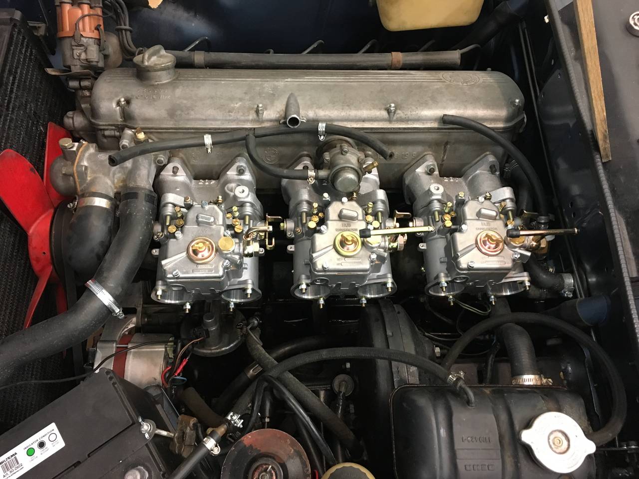

Stock brake booster will almost collide with the center carb.
I changed it to a 2002 booster (not Tii) and I am now able to run ca 30 mm long stacks and angled stacks would be no problem.
This is what it looked like the first time I put the carbs in with stock brake booster.
remember, that is a 2800cs booster which is much smaller than the 3.0cs booster

Hi Mark
That is an original Alpina setup?
do you have an end view?
Length of booster I don't think is an issue, it is in there now
I keep every airbox pic I find. I’m at work though. These are from an archived eBay ad. It is safe to presume that these parts are original.

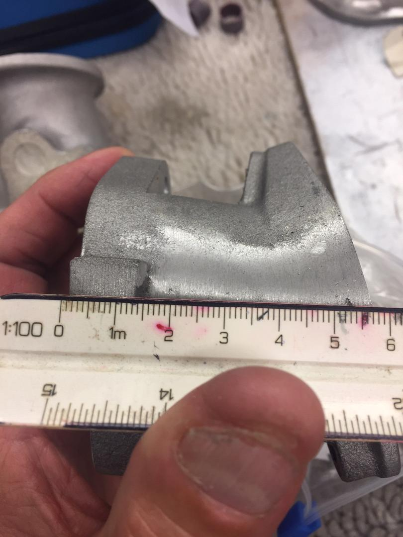

Just fyi -- this is probably not relevant to Mark's original issue, but Ray Korman makes a tstat housing that has a kink in it that provides slightly more room for the installation of Webers. I am using one of Ray's tstat housings and a Korman intake manifold.
