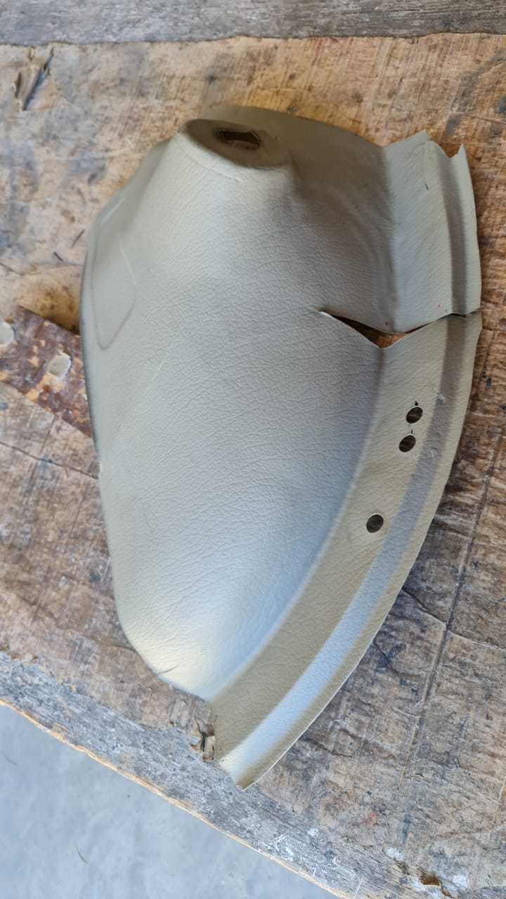

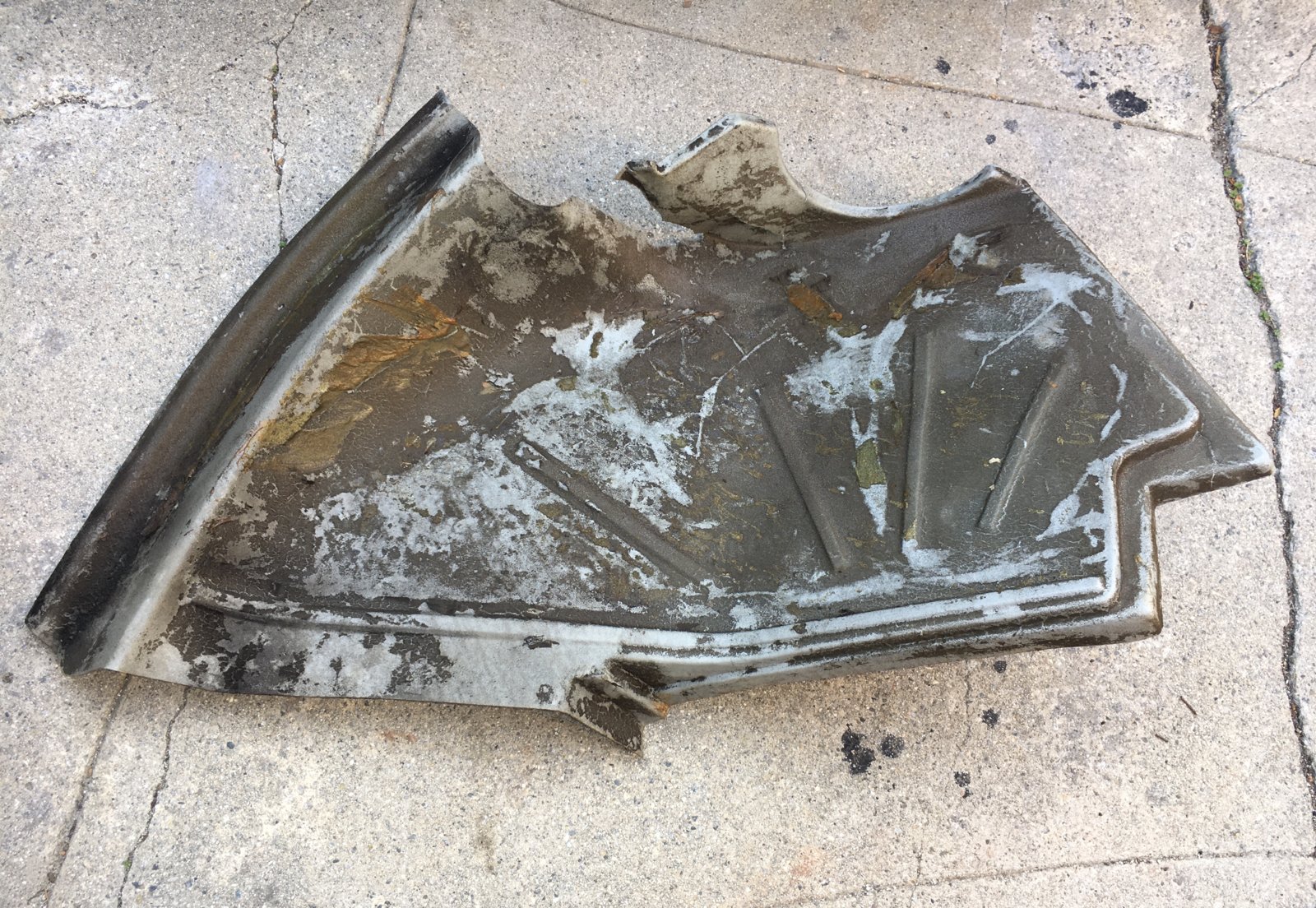

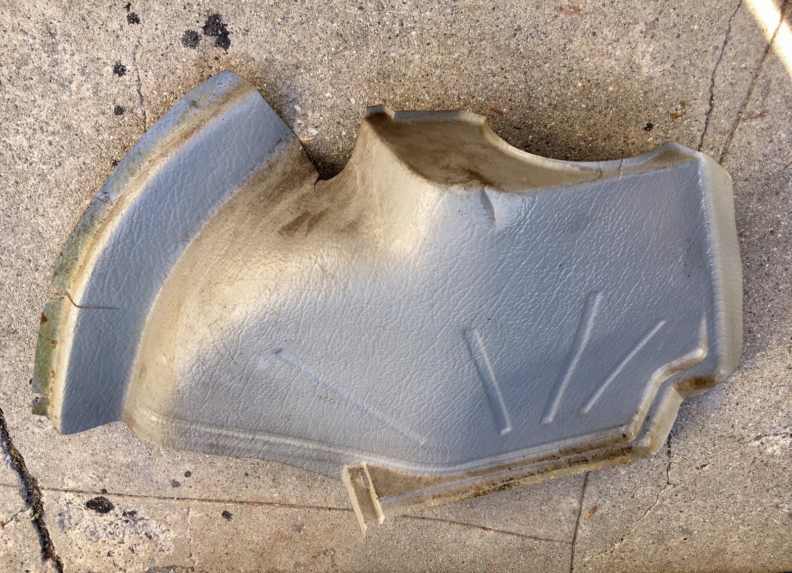

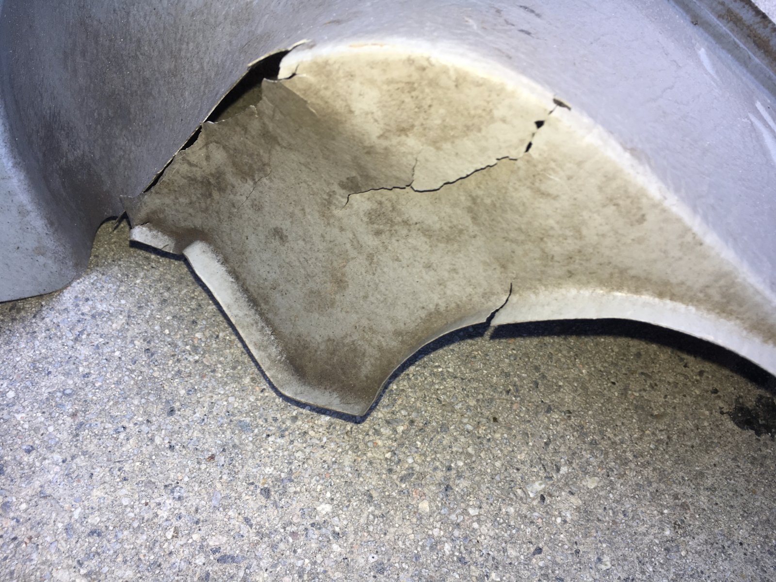

The pics that 3moons sent show one in much better condition than mine.
3moons look completely intact, good examples. they will likely always have some cracks. Easy to fix with fiberglass cloth and a good 2 part, sandable epoxy. Makes them sturdy as well.

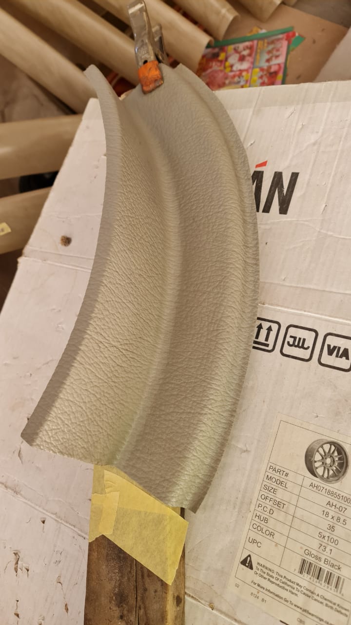

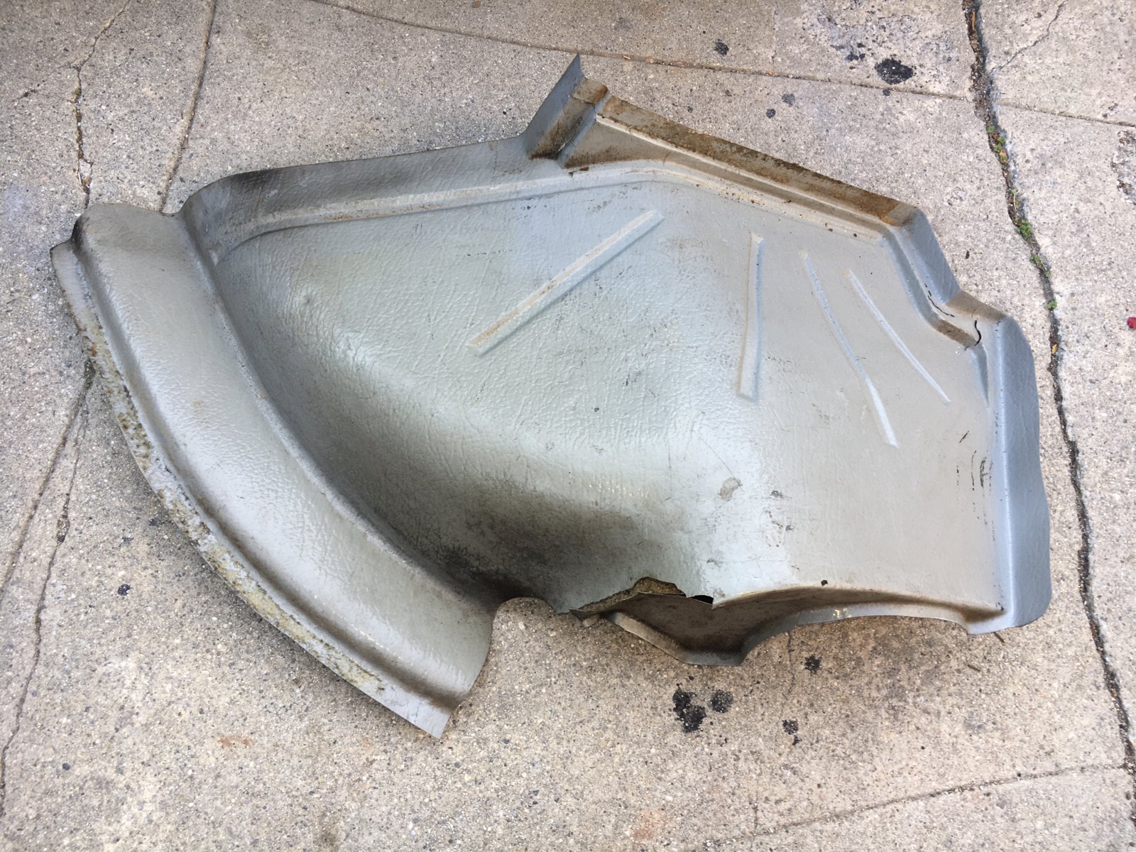

Photos of my trunk liners.
I found there are the 2 large ones and 2 smaller, 1/2 moon.
Is the 1/2 moon of interest, or only the large ones?
Regards, Alberto

Hello Alberto.
I am happy to send my pieces but the ones pictured above are from @3moons. I think if we want a good set, then we need @3moons to send them as mine have many cracks. If it does not look like there are any alternatives in a week or so, I will box mine up and send them your way.

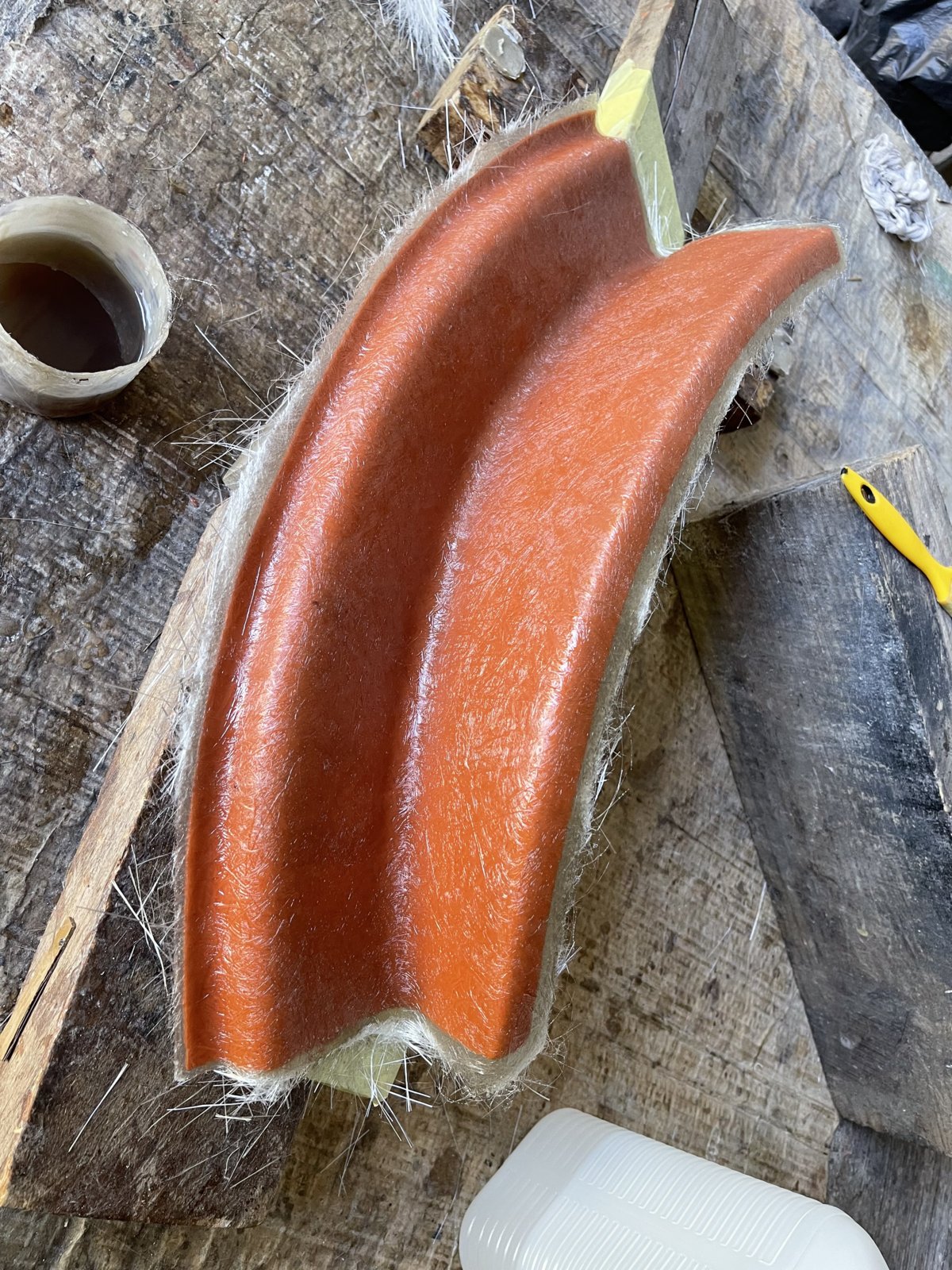

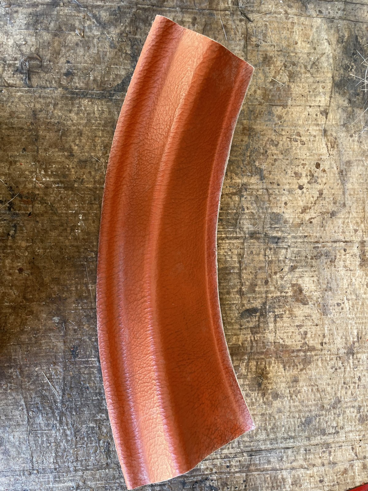

Drew, yes, I am making the half moons also.

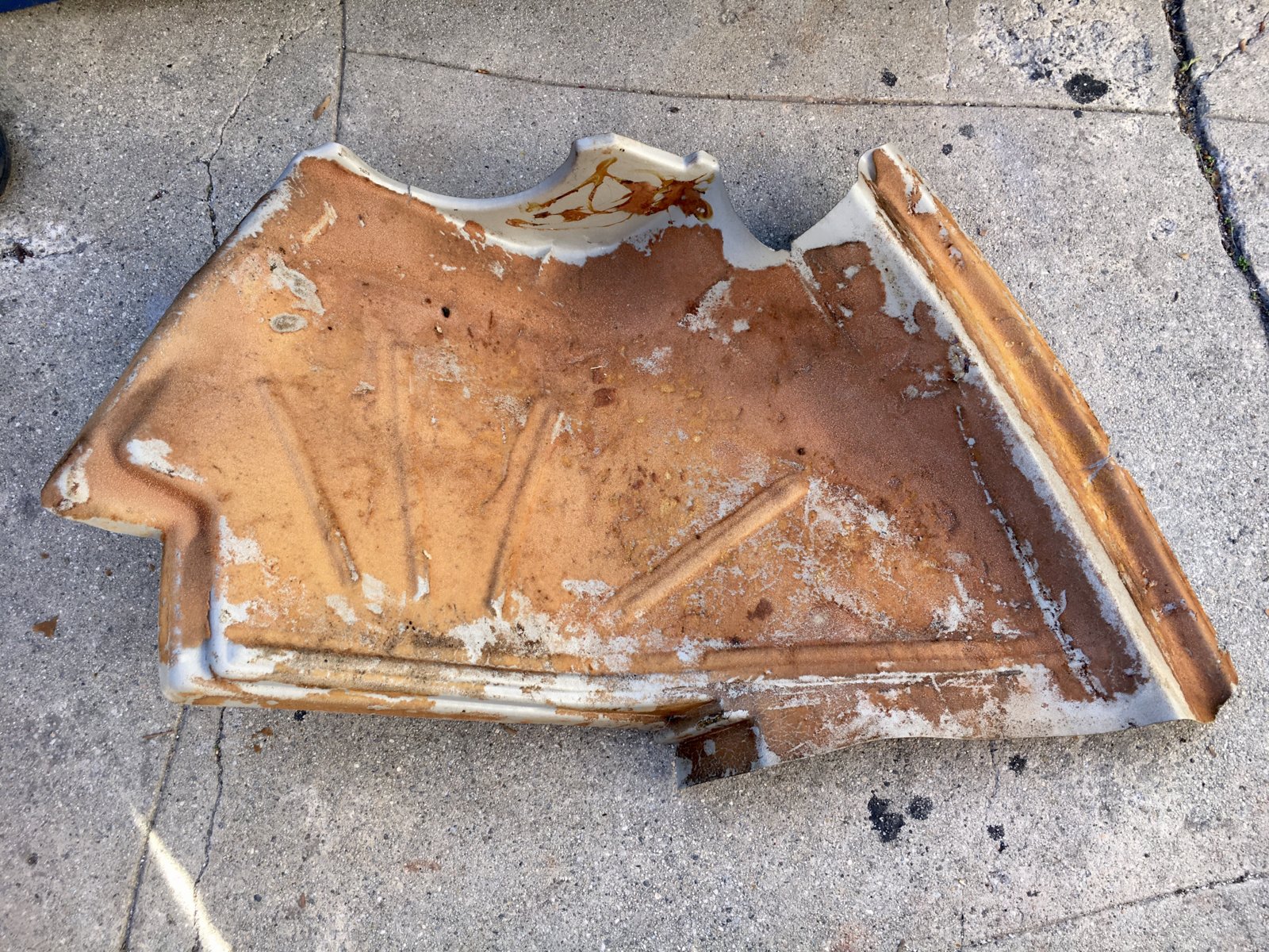

Here’s the right side liner:
