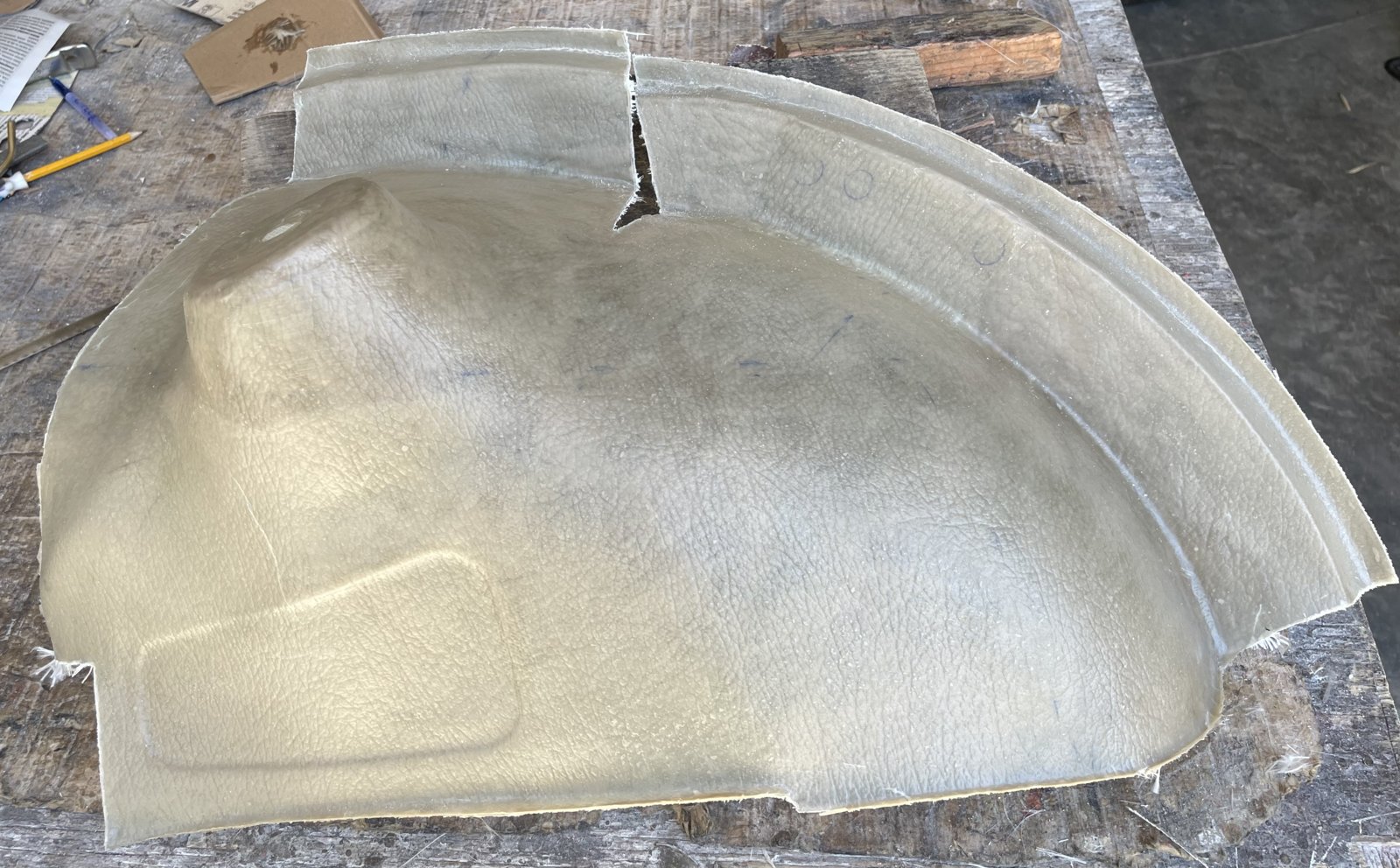

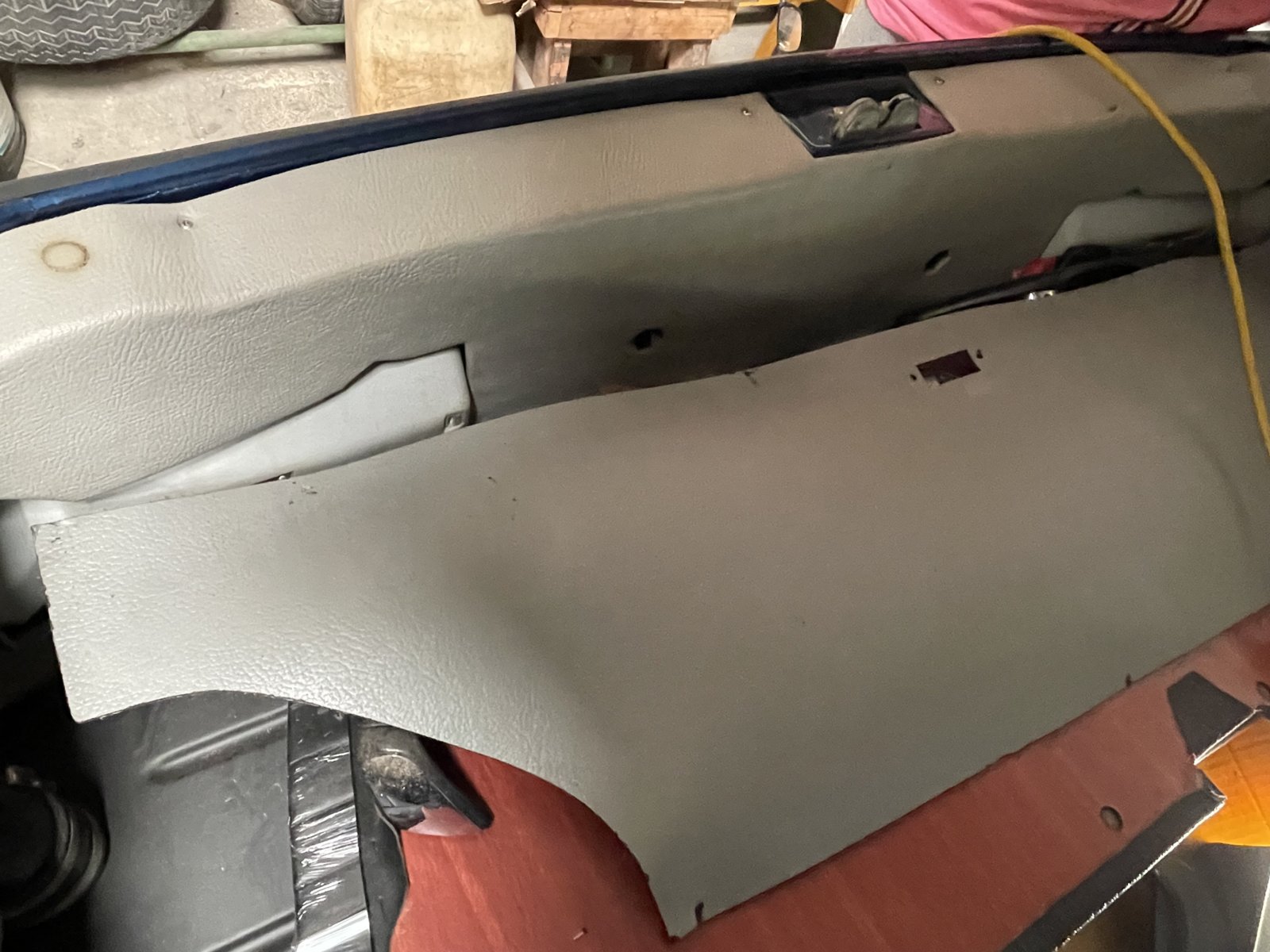

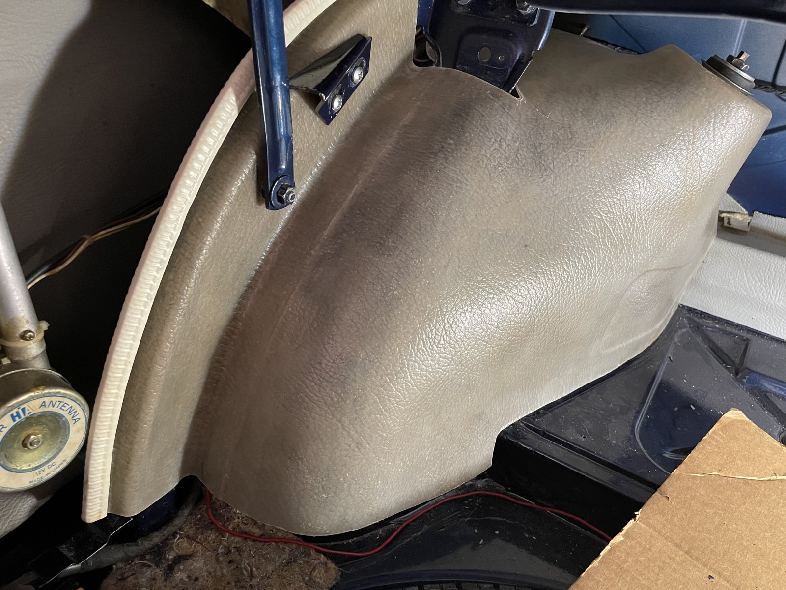

Here is a sample of the 1st prototype. It came out great, it is as flexible as original, super sturdy.
Will make it in tinted gelcoat, as too thin to apply 2nd gelcoat.
Please note, the installed fender cover is made with mat, the second ( not installed) with cloth, much better and as thin as original
The mould was corrected and cannot see the additions to the original mould(s) anymore.
This is a top notch quality product. No ifs buts or maybes.
We also noticed that the rear taillight cover tends to distort around the taillights. Thoughts?
Regards, Alberto

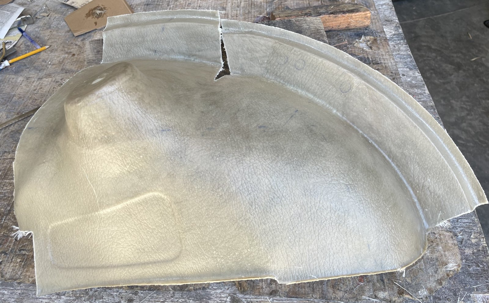

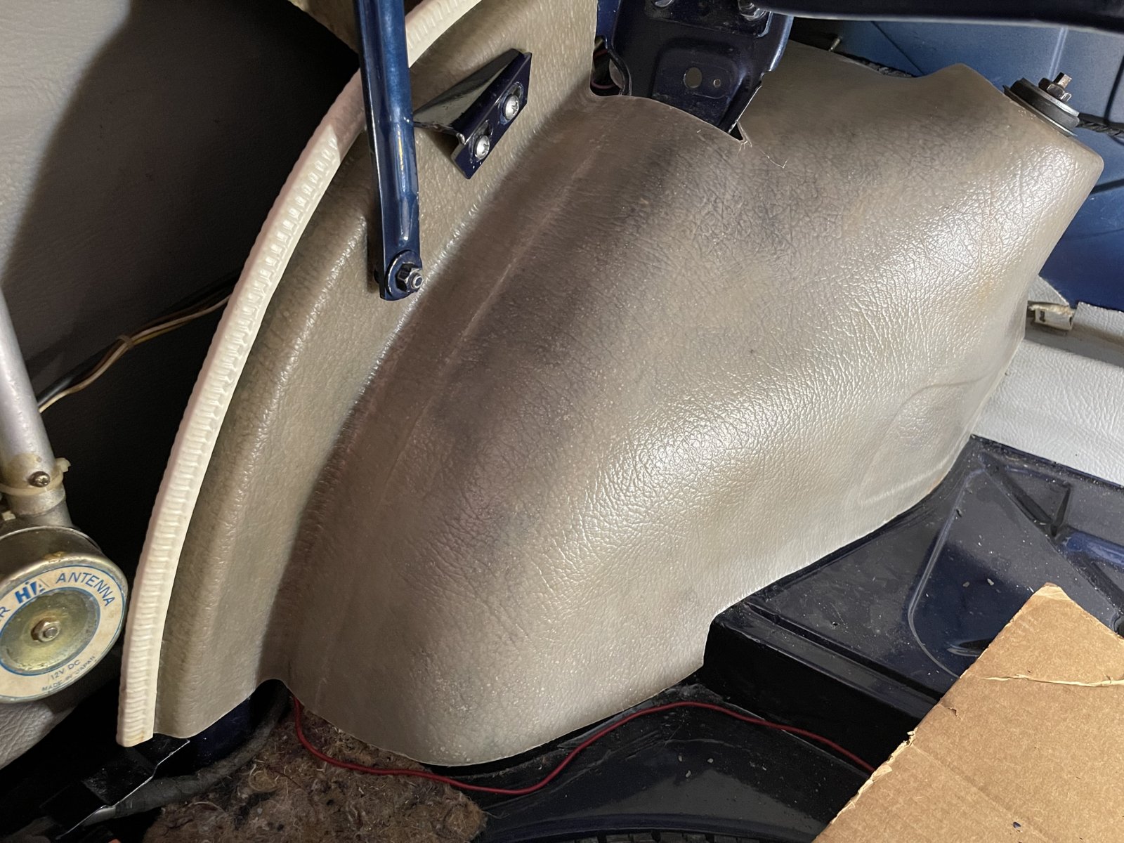

Very timely question. I need to have some rear suspension work done. I think it can get done without removing skins. But, even bumping them might cause them to crumble. They are nearly perfect (well, the right one), but they are so, so delicate.
