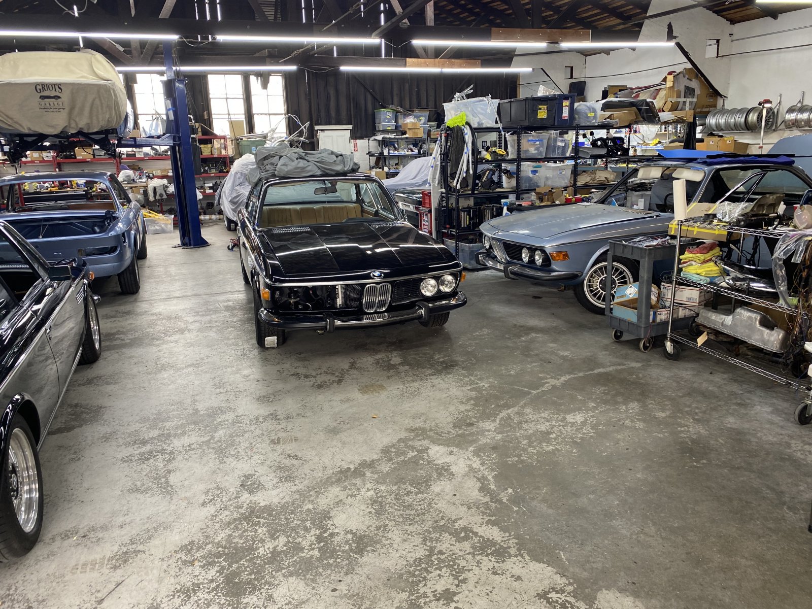

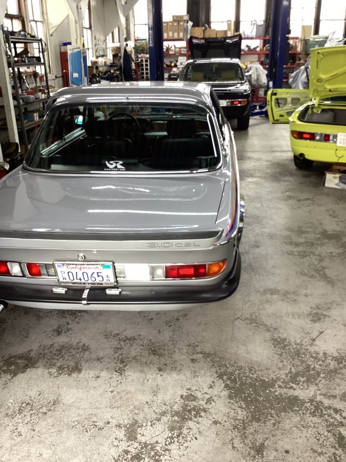

After The Quail and Legends…
The smart thing to do is Get a Leakdown Test before you do anything else.
You can do that locally. Cheap, fast, easy.
Share the results here.
