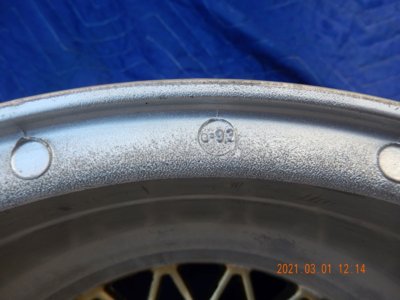

I would love to see if you can of course What is the offset on those wheels
Most probably is et11 or perhaps et9.3 which could be also possible although the 9.3 were used on csl and 11 is the most common one

I've looked for the offset, but it isn't stamped on the rim anywhere. I'm guessing 11, but won't know for sure until I pull one and measure it.
Dear Dan

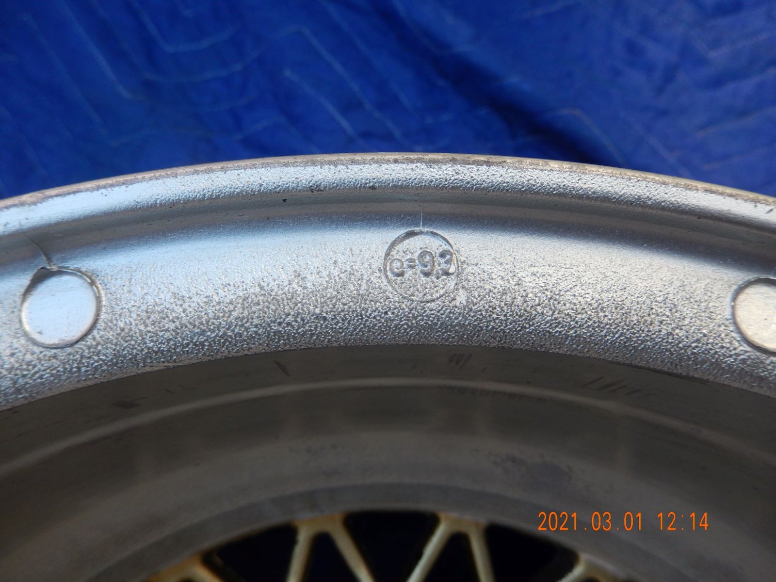

Check on the back of the wheel there is a tiny round mark on each wheel where you can find the offset as pictured
Cheers and good luck
