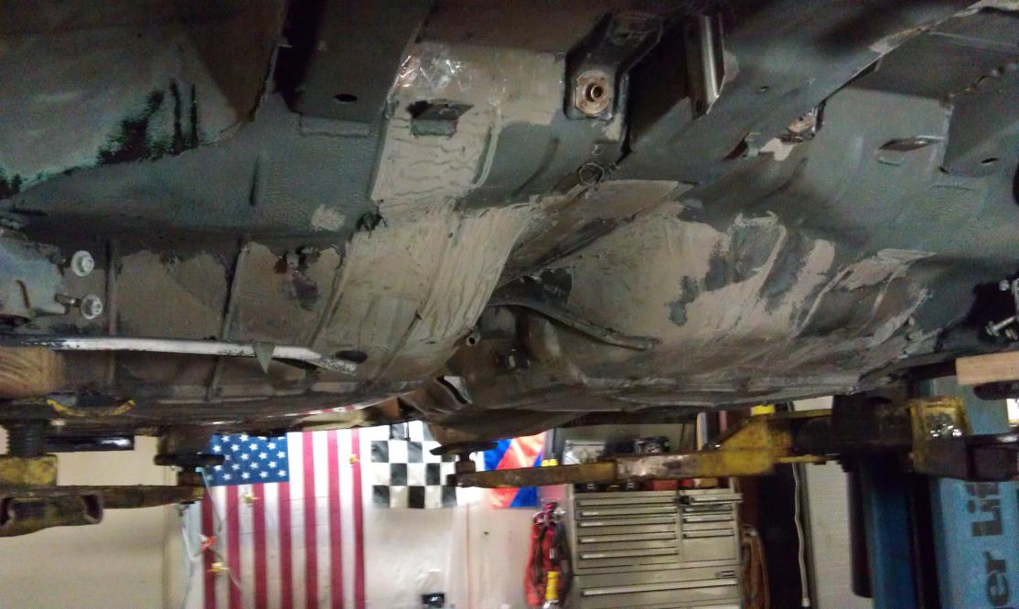

I am doing a full undercoat this week-end. I have a product that I think is going to match the original (mfg.) undercoating. I will send some pics and the product name and you can see what you think. Here is a pic of the car now- I'm scraping, not blasting, but I wish I blasted. I think I lost about 10 lbs. scraping this stuff off :-(

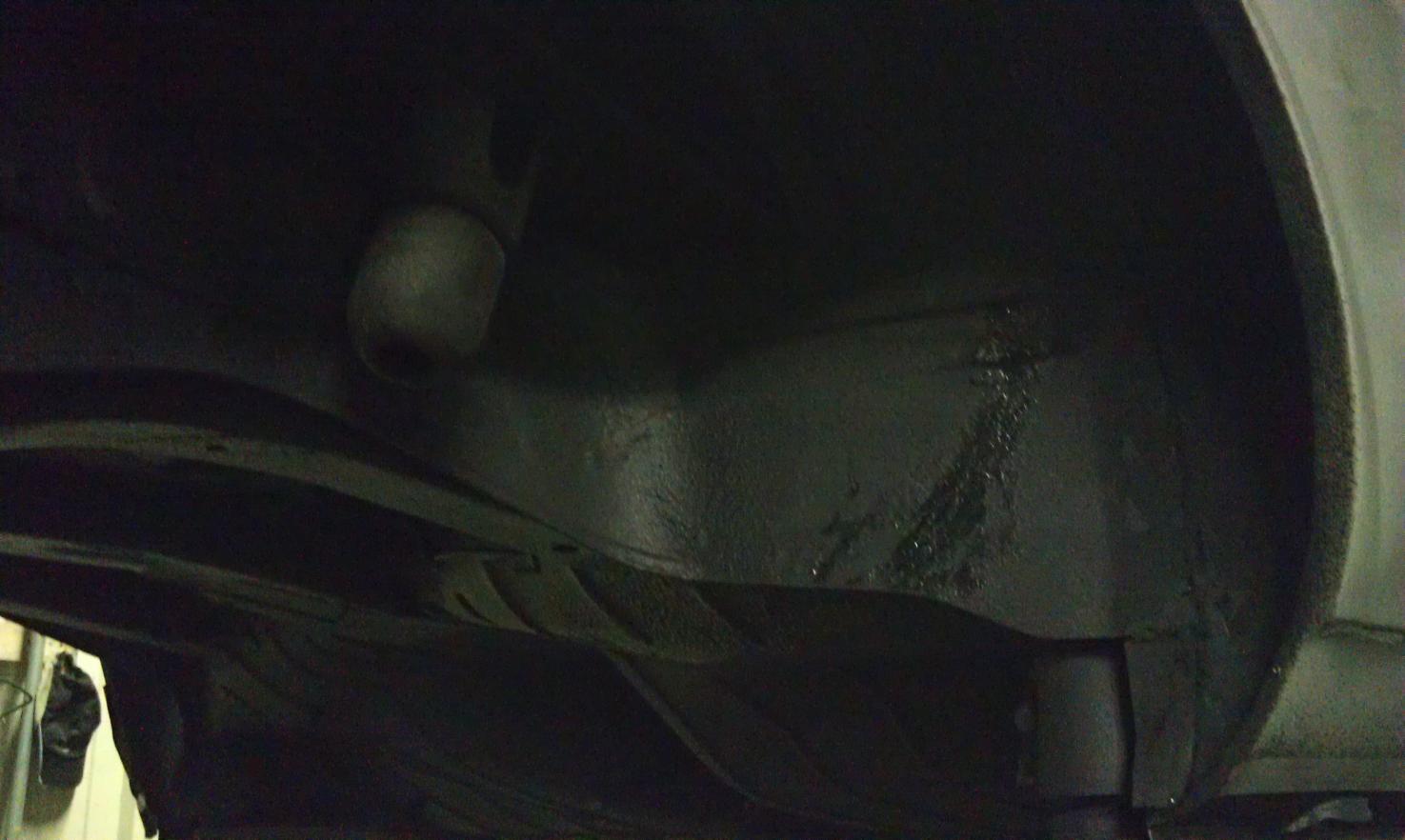

Here are a couple shots from my undercarriage. I used the Wurth product.

Peter, what has you scraping technique been? I tried a heat gun, but it seemed too weak. Will try a torch and scraper perhaps next. I wish I could farm this part of my undercarriage resto out. Polaris 68, that shot of your underside looks amazing. Is that a Coupeking exhaust?

Yes, it is a Coupe King exhaust, but it is an early one. Not as nice as their current offering. Thanks for the compliments.

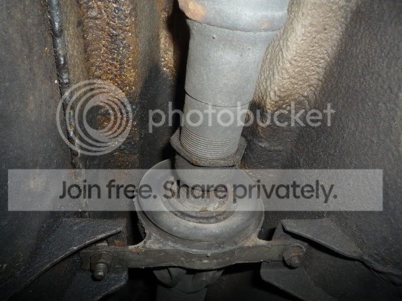

Interesting that the 2002 has easier to defeat undercoat Chris. Here is a shot of the one area on mine that is not covered in Black undercoat.

Good question; I tried everything known to man (and a few that are not)! The "factory undercoating" (mine is a 74), was grayish and applied pretty well. The only thing that really gets ALL the undercoating off is blasting or dipping. Short of that you'll have to scrape and use all types brushes, scrapers, wire wheels, etc. It is a work-out! To completely clean the bottom I used oven cleaner and a power washer, that also loosened up allot of the bad undercoating and made it easier to scrape off. I too used a heat gun and it did not really help.

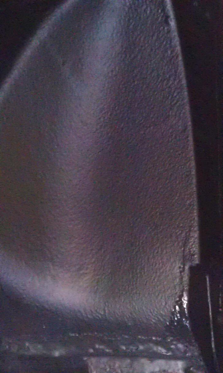

Regarding scraping it all off, when I saw it was on so well, I carefully scraped all the lose stuff and then feathered the edges down and cleaned up the bare metal. When I was done I used a self-etching primer and then sprayed 6 bottles of undercoating at about 60 psi. I'm pretty happy with the undercoating product I used but not the final results as I will have to do a little more feathering and hand apply some areas and then re-shoot for texture. Then I plan on painting semi-gloss black. It's not "factory" but I think it will give me the desired look once I'm done. I included a couple of pictures but my phone camera did not work too well.

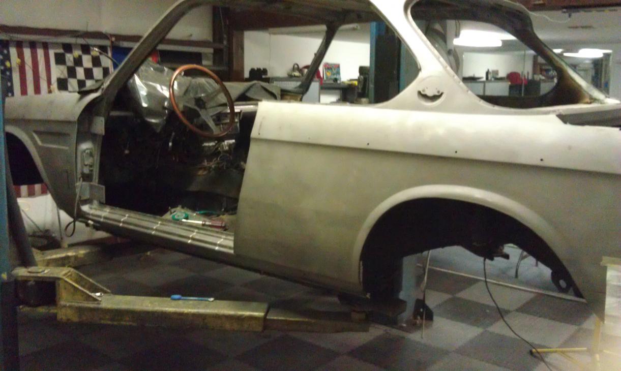

I took some pics last night- they're a little grainy, but I did knock down the high spots of the old undercoating and applied more of the new stuff. It was very interesting, I used an abrasive (3M) wheel and it took down the old undercoating but the new stuff I put on was immune to the abrasive wheel. Really tough stuff! I included some pics and one of the product I used. Are you in a hurry for the removal stuff because if not I could buy a can and send it up to you in the mail- if it works you can send me the cash. It will probably take 10 days or so to get it in and up to you.
