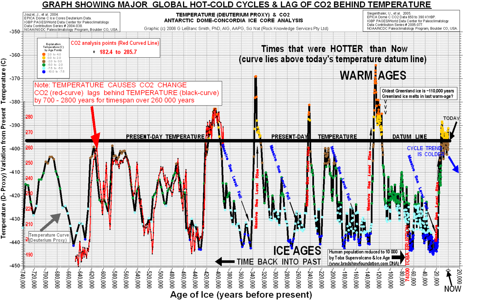

Look at the chart below, which was compiled by National Oceanic and Atmospheric Administration at Boulder CO and published in 2006. We are currently at the far right side of this chart. History goes to the left. We are still about 3 degrees C cooler on average than previous 'high temperature periods'. And since it's been nearly 20K years since the last ice age, it might not be long before our future descendants will see the temp start dropping again. Significant volcanic activity can accentuate the cooling effects, of course.
There are something like at least 80 'laws of physics', 'gravitational', and 'wobble' aspects of the orbits of earth, and other planets that impact to our relationship to the sun and effect the amount of heat that arrives on our little blue orb. They seem to be on about a 20K year cycle!

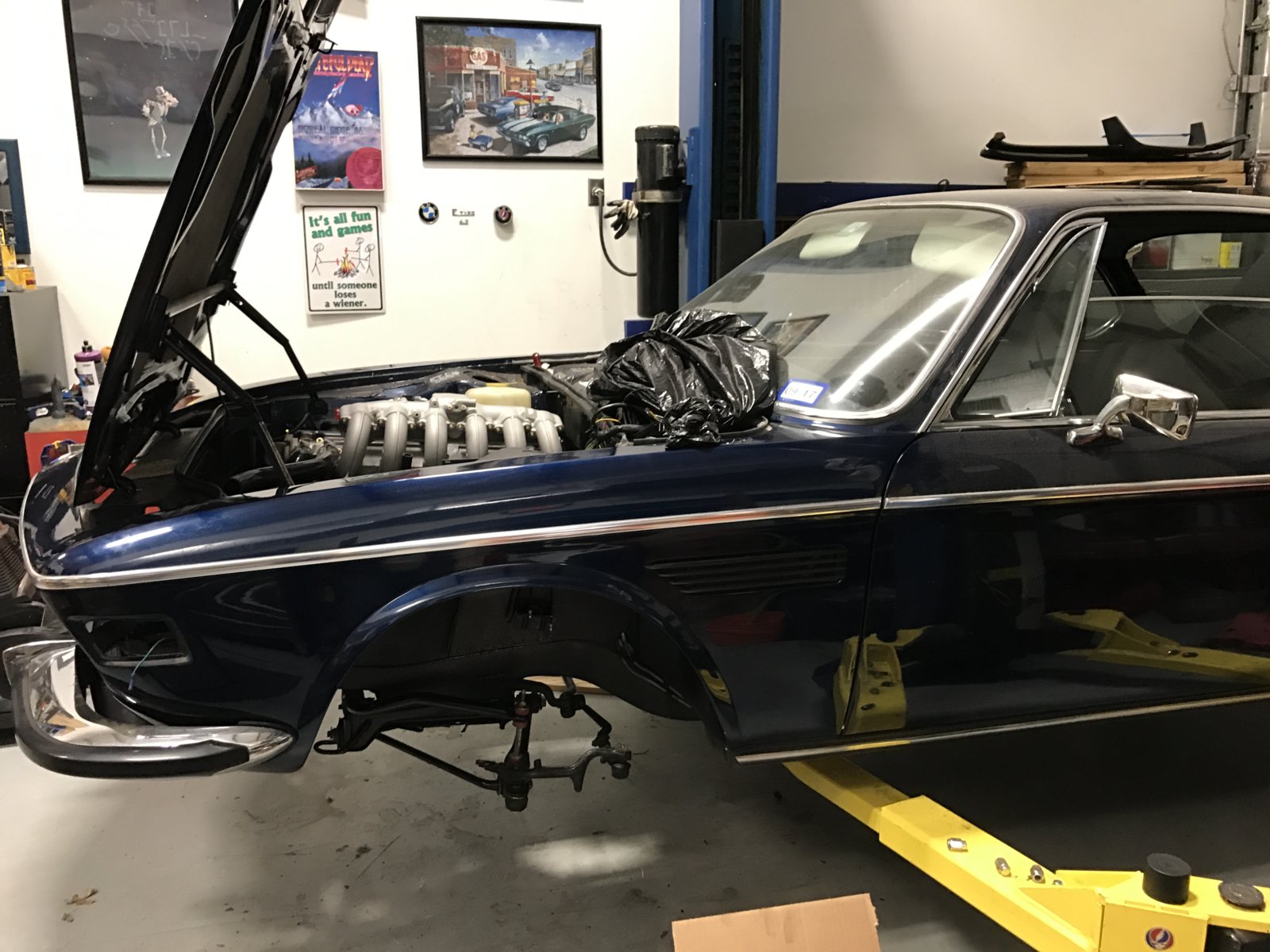

Dan when you get around to doing it please let me know, I want to do it as well, just got the engine in :-)

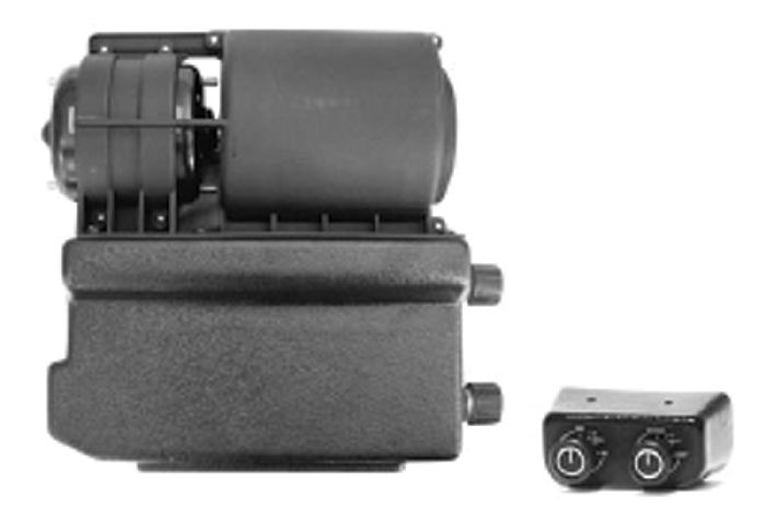

I talked to Dan about the 3D parts in a PM. For those interested in an AC conversion, I suggest that you consider the 3D parts last. The thing is, I can’t run out of inventory and the timeline is very predictable. That means you can try to find a package deal for the AC setup and switch to the 3D parts if nothing shows up.
I’m working on sourcing a few evaporator boxes. The console side cores can be found with relative ease. Expect to recover them. Really the only tricky part is the evap box and a good faceplate. The side vents can be found but they tend to be cracked. Unlike the printed face plate, the 3D side vents don’t offer substantial savings over good used ones. They just rarely come up for sale. Lastly, the side vents don’t have the texture modeled into them. They don’t look quite original to the trained eye. That isn’t a problem for the face plate because it was painted but the side vents have somewhat of a leather texture from the factory.
