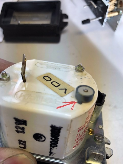

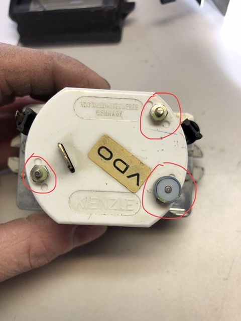

1) having the clock on the work bench you’ll see the plastic white back cover has two nuts and one plastic tamper proof piece. To gain access to the clock movement and gearing this will need to come off.

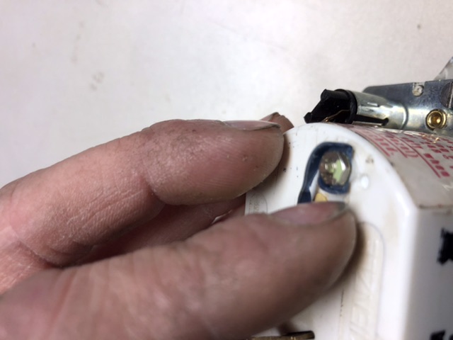

2) the tamper proof covers the third 5mm nut that needs to come off. I cut the to small plastic ear tabs on the side of the tamper proof cover with a utility knife then just pride off with a small flat head Screw driver

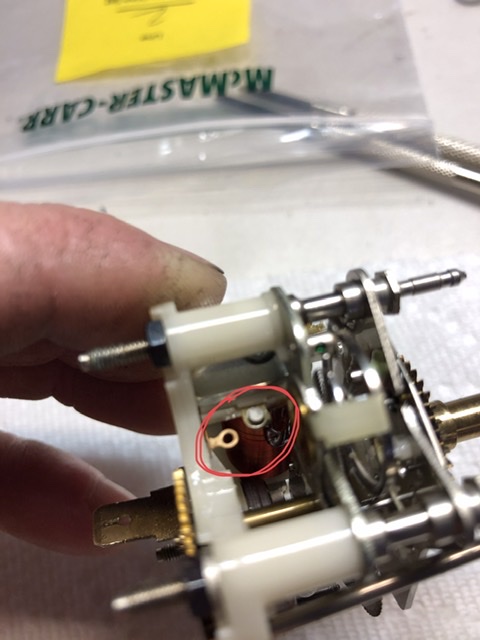

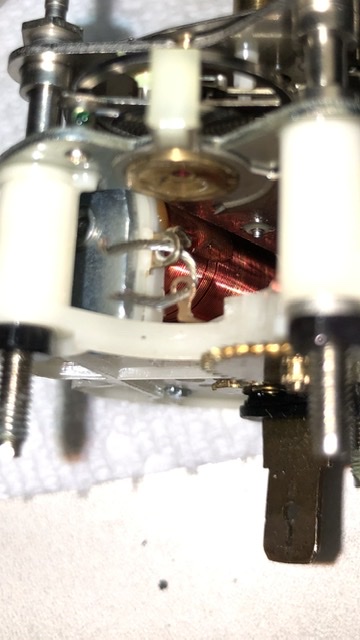

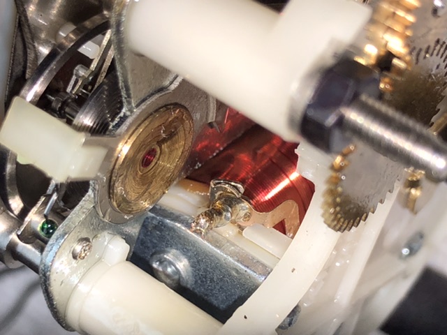

3) after sliding off the back cover you can see all the glory of german engineering. upon close examination of the gears, movements and winding mechanism i found a disintegrated soldered joint between the electrical coil and winding mechanism ( I believe it was ground side)
NOTE-on all three of my clocks this soldered joint had failed!!!

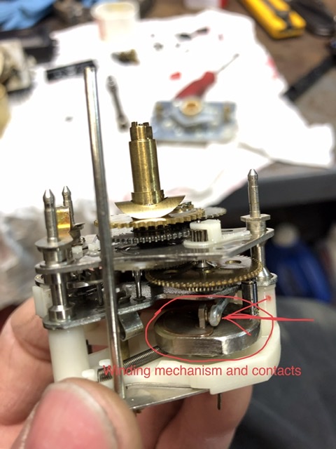

NOTE-this picture of the winding mechanism shows the contacts touching when this happens with uninterrupted power the left contact turns clock wise away from the right side stationary contact. This resets the mechanism and keeps the clock turning Until it happens all over again and again and again.

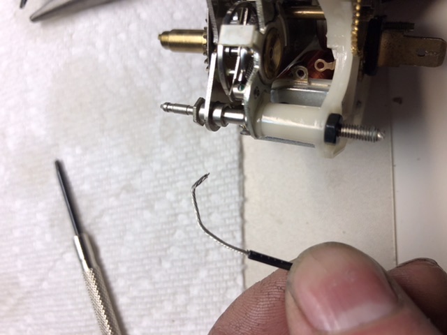

4) I repaired the joint with some 18-20 gauge wire and threaded it between the two eyelets twisted to tighten then resoldered.
5) I went through the gears lightly blew any grim away and oiled all pivot points. Hooked up the clock to 12v and we were back in business and being on time for it as well. winding mechanism winds, movements move and the sound of the classic tick tick tick are great.

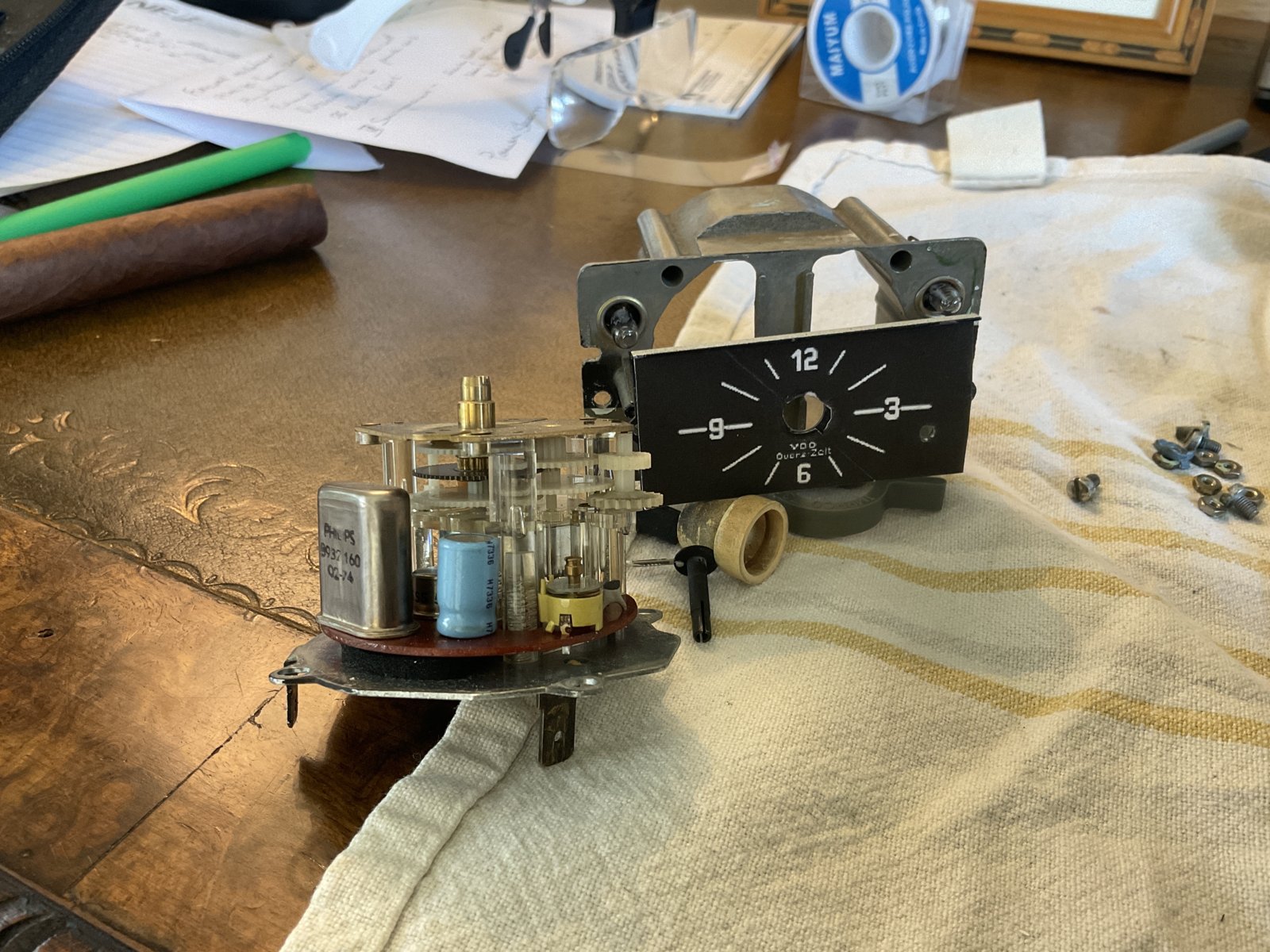

this is one of my summer projects - to remove the clock is all that necessary or can you loosen the plastic nuts, rotate the clock and drop it out the back without removing the wood trim piece?
No Dick, The quarts is completely different. The face is paper and says Quaz Zeit on it.
Could be possible I believe though that the way you need to manipulate the clock through the dash its easy to damage the beauty panel.

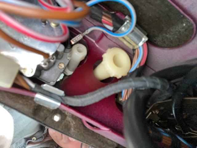

I found the drivers side clock retainer knob is a tight fit between clock threaded stud that it screws onto and the metal frame under the dash that the clock stud runs through. Taking off wasn’t to much of a hassle for me but putting the knob back on was a pain. Easy to cross thread and almost get it wedged if I didn’t take my time. I used my phone to take pictures of the area I couldn’t see to try and get a better idea what it looked liked to deal with it.
Yeah, snapped a pic if it's helpful to anybody. I'll give it another go tonite.
OK - I finally got it. For whatever reason that side was on super tight and did not want to break loose. I alternated between a small 10mm wrench and a needle nose pliers to break it loose, which was not particularly easy, then once it was backed out a bit I used a 10mm socket on the end which gave my fingers space to turn the socket since I could not grab the end of the retainer knob. Then I ran out of patience so I still have to push it back through the dash. Does it go back through without removing the black bezel and faceplate? There is space on the right side barely but does not appear to be on the left, although I'll give it another go tomorrow.
