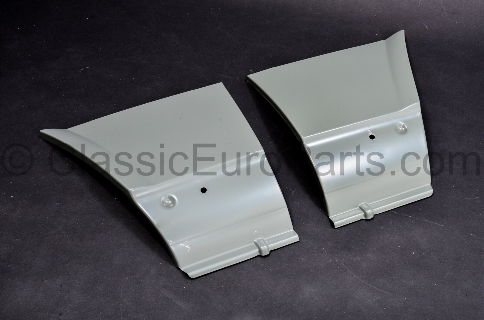

Did the front fenders NEED to come off? If they took a boroscope to it, and all is well underneath, no need?
However, I plan on just cutting off the patch panel and both sides (lower part) and seeing if all is well. Then putting a W&N patch panel back on as I see no need to take off the whole fender and preserve the factory welds on the top part (thank goodness they look good there).
