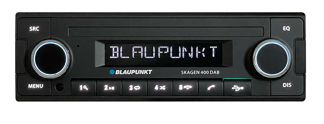

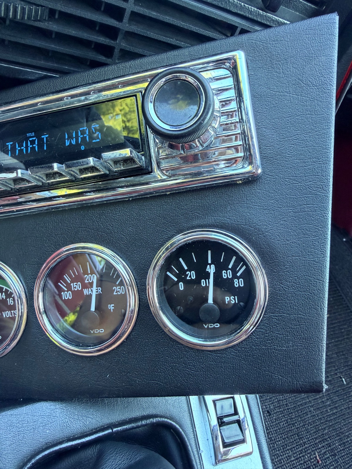

I have just bought a Blaupunkt Skagen. Mostly because it has a DAB+ receiver (that are the standard in some European countries),FM, bluetooth, and hands free (buing a car radio without it is out of the question). It has a modest look that fits well into the coupe unlike some of the new bling bling retro radios. The best of it all is that you get a modern and hassle-free plug and play unit.

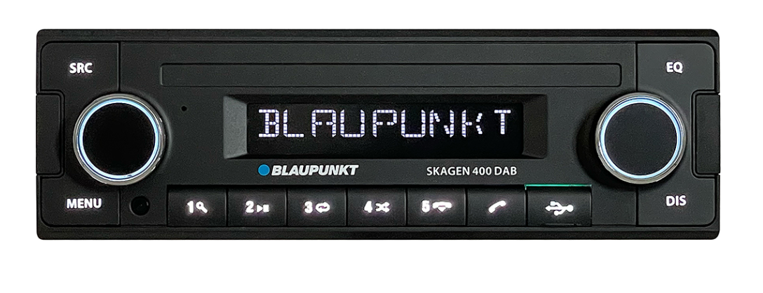

Curious
mixed feelings about design aspect and looks
but good for you

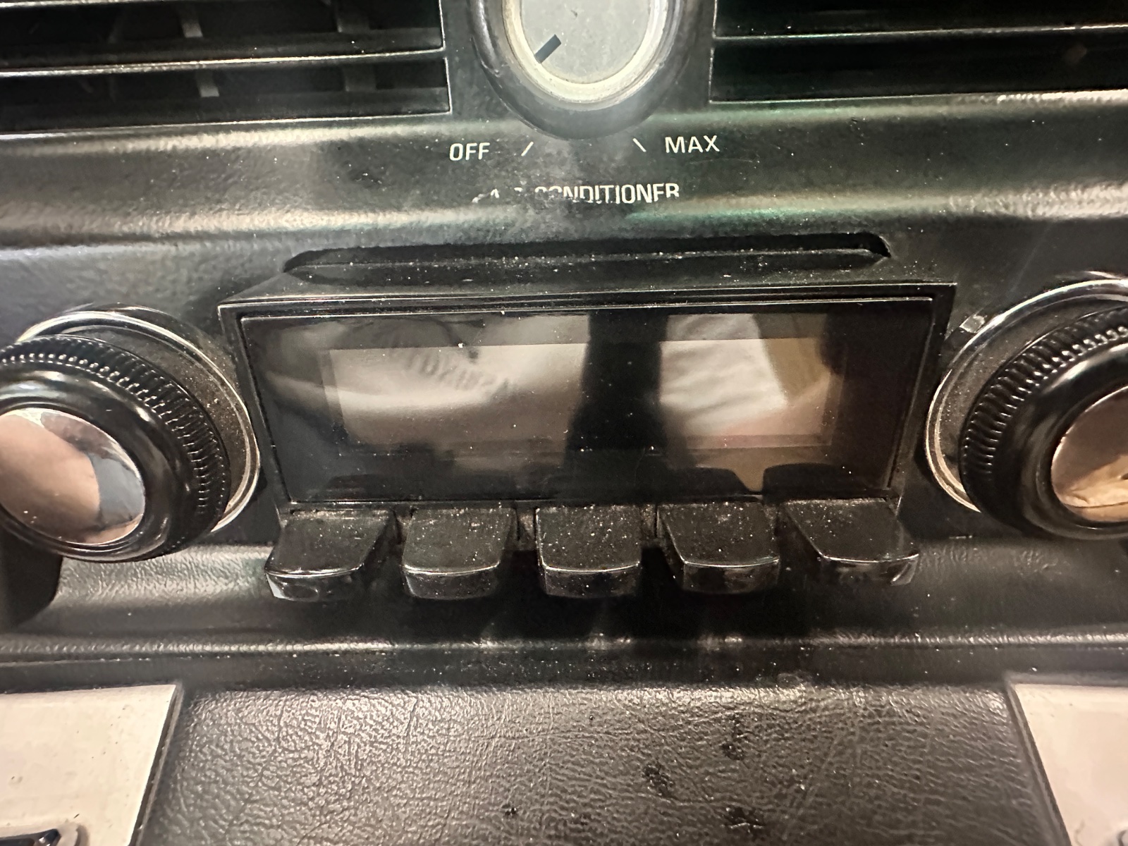

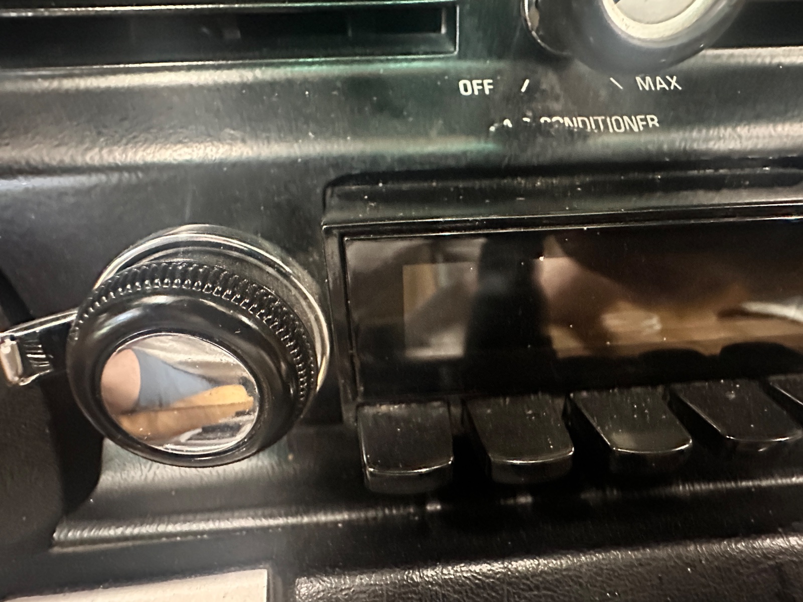

so here's the follow question for you retrosound guys with the uncut plate. what does the gap look like between the faceplate and the display? presumably the display is behind the a/c panel and then the coverplate is on top. how about an installed picture ... next question, how good is the sound quality?
Here’s the only photo I have at the moment but I think it shows that it looks pretty clean. Regarding phone placement, the other thread with the iPhone 3d printed stand would work but would obscure the gauges in the dash speaker. It would be pretty easy to modify that stand to sit one “well” over to the right
The gap was larger than I wanted when I installed the radio, but in reality it is invisible given that the face plate and the radio are black.

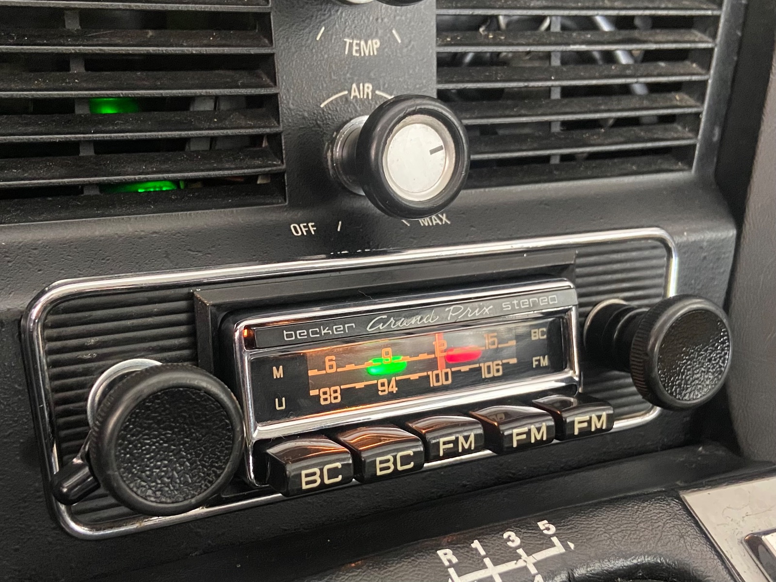

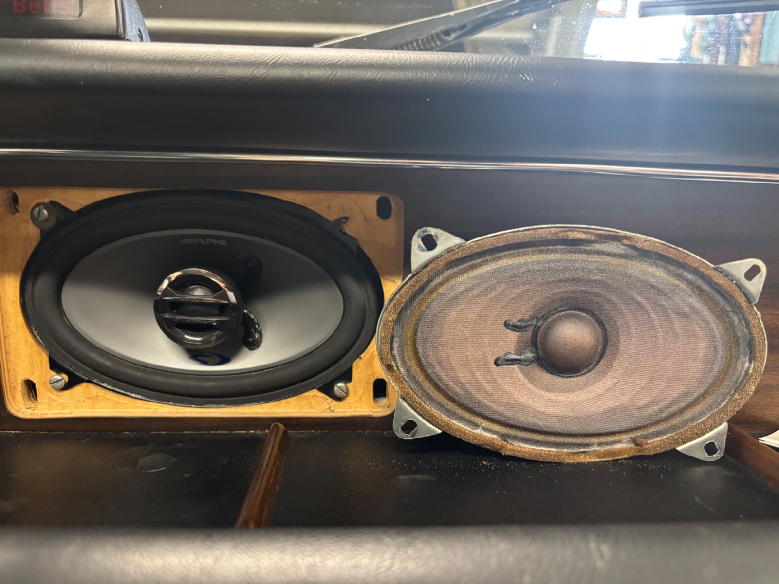

My Becker Grand Prix. The red handle screwdriver of radios. Rebuilt 5 years ago by Becker Autosound in NJ with added blue tooth capability (the green light behind the AC grill). Works great. I was still running original 50 year old speaks until yesterday. I replaced the front speaker with an Alpine unit purchased from @e9Leveque last weekend. Nice improvement. I’ll get around to the rears someday provided I find quality speakers to fit under the original grills.
always loved the Becker Europa or Grand Prix. my mothers 450sl had one. the best vintage radio look - period. its just so hard to find one that doesn't require a DIN cutout.
i have inquired about service / rebuilding from VintageBlau. they can incorporate bluetooth and replace the circuit board which increases power, makes the radio bulletproof, increases reception. waiting on time frame / cost information
well, don't love the information that i received - 1400 with bluetooth and 1250 without ... time frame is 4 weeks. this pricing sure makes the Frankfurt MB radio seem a lot more appealing.
