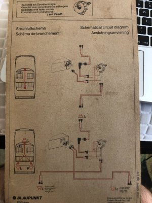

Question for speaker wiring.

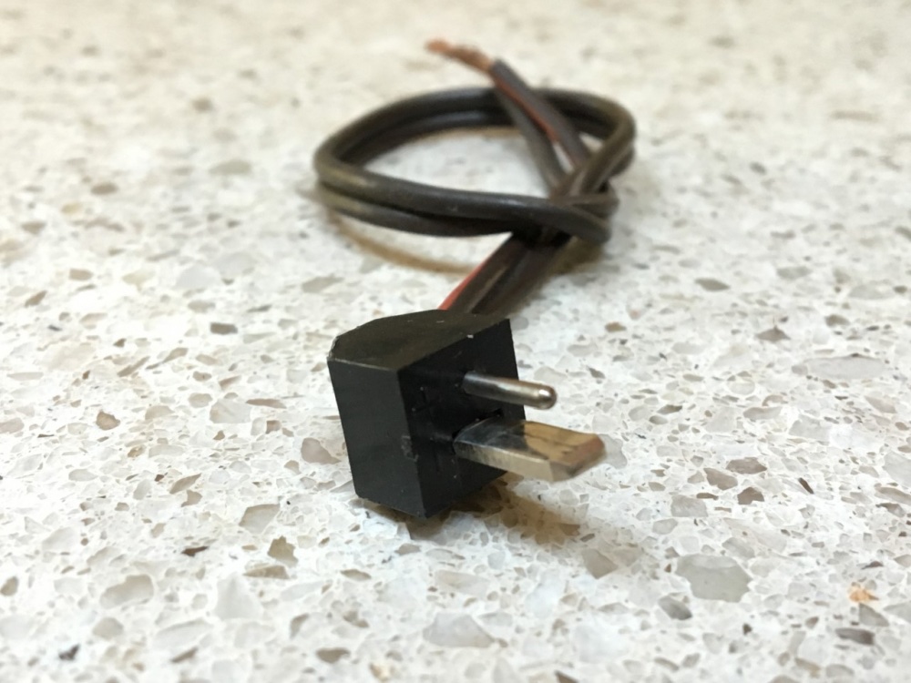

I have a 1972 euro Frankfurt with 2 of these speaker wire plugs both of which are connected to the 2 rear speakers in the parcel self. Is there a splitter I can use on one of them to feed both rear speakers so the other one can connect to my center dash speaker?
You probably don't want to do that. The output is stereo. If you hook one channel tot he front speaker and the other to the rear pair f speakers, you will lose any stereo imaging. I'd recommend looking up a recent thread where we created a 2-speaker insert for the front in-dash speaker. There are two different ones. One for planar speakers and one for small cone speakers. Then wire each of those in parallel with its corresponding side in the back.

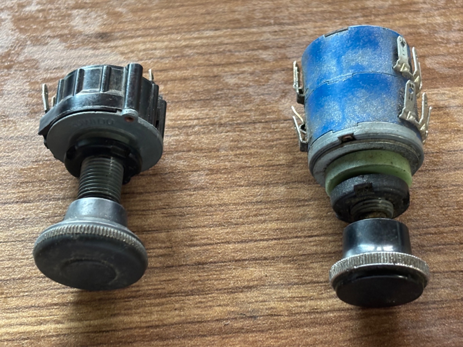

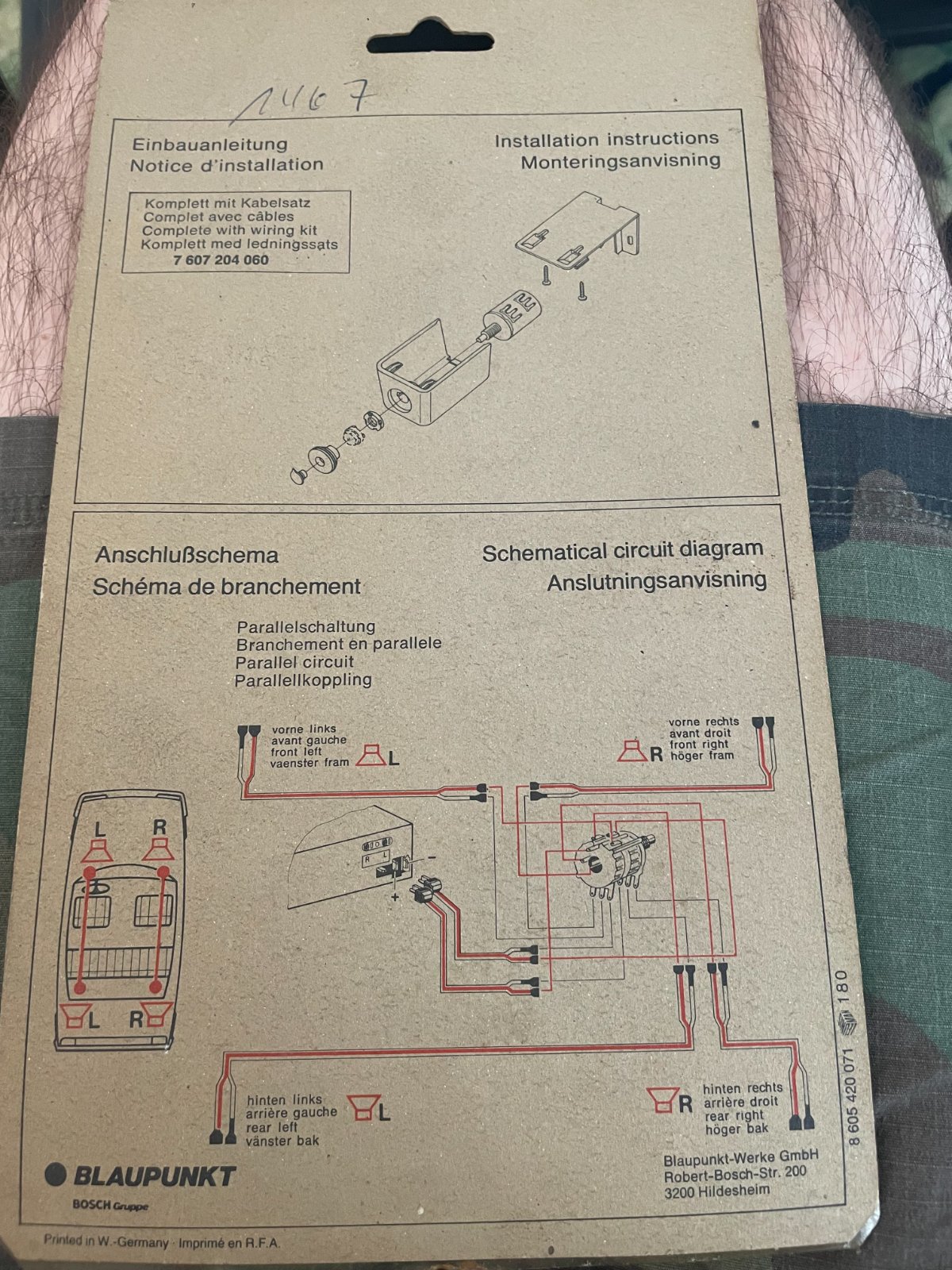

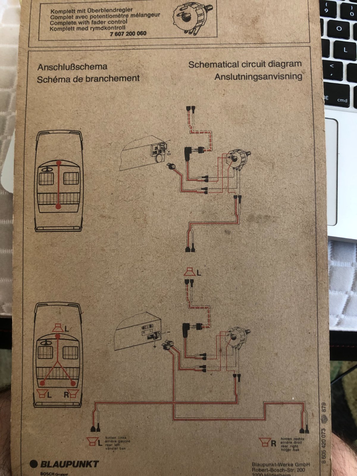

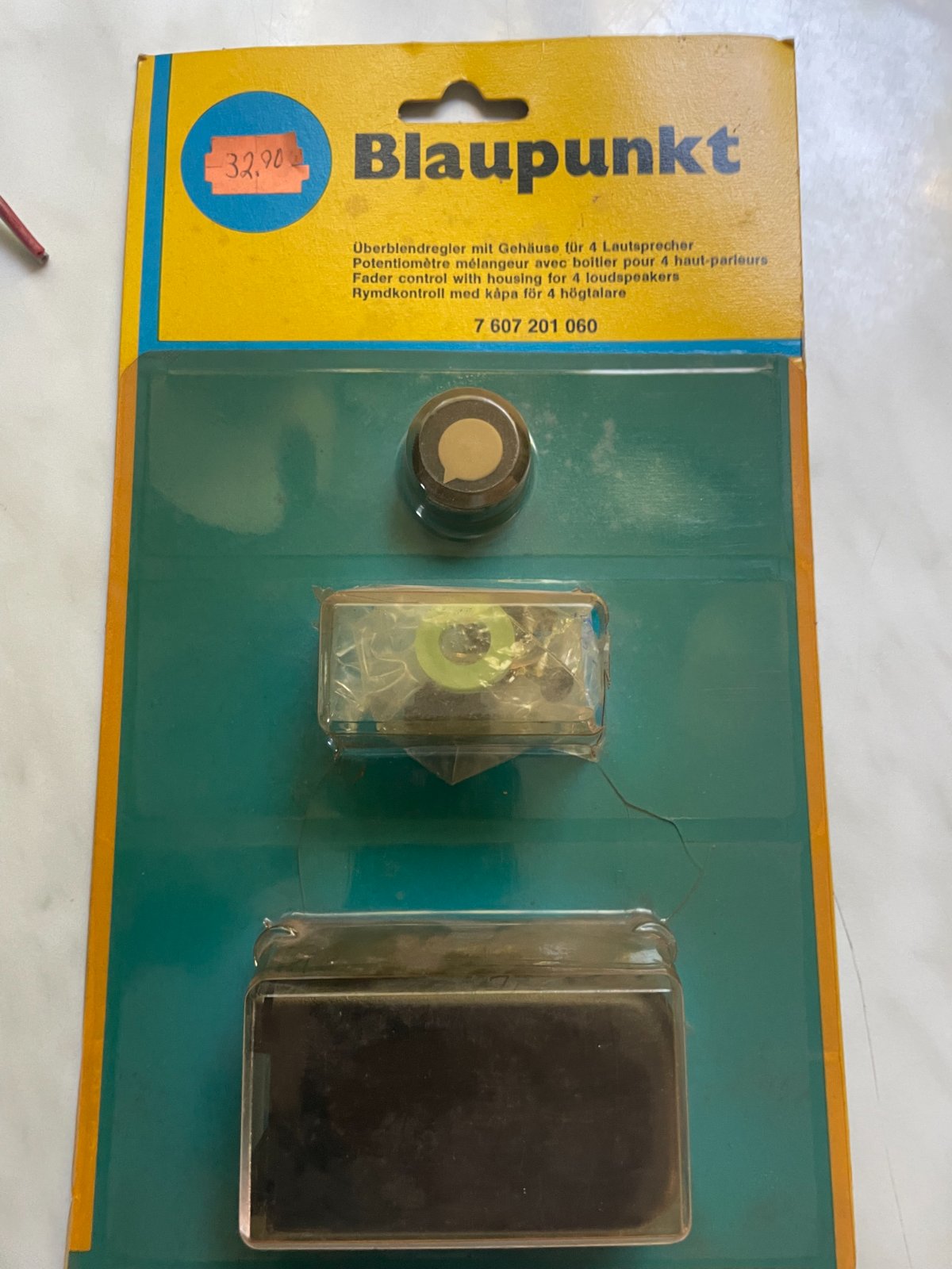

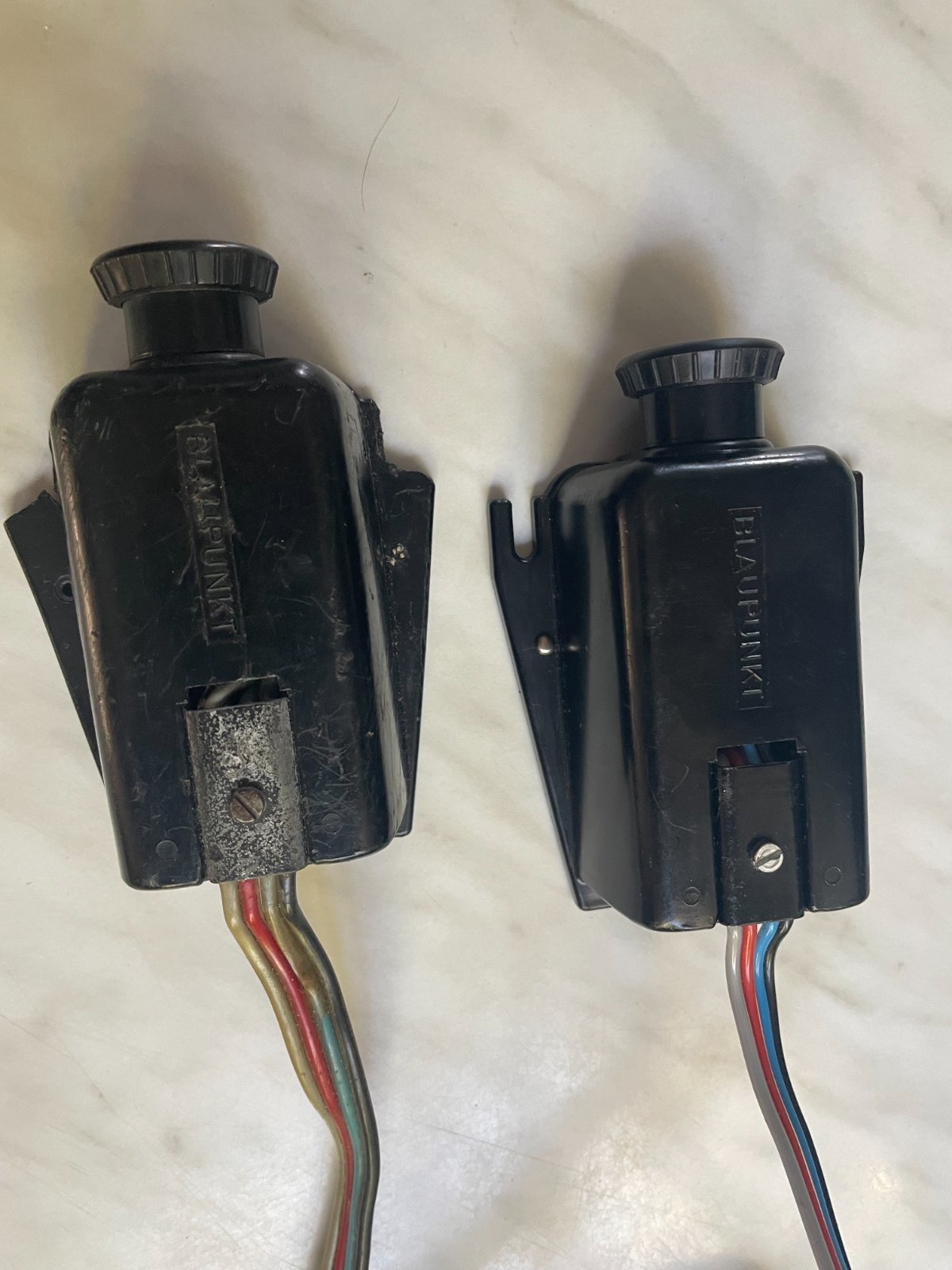

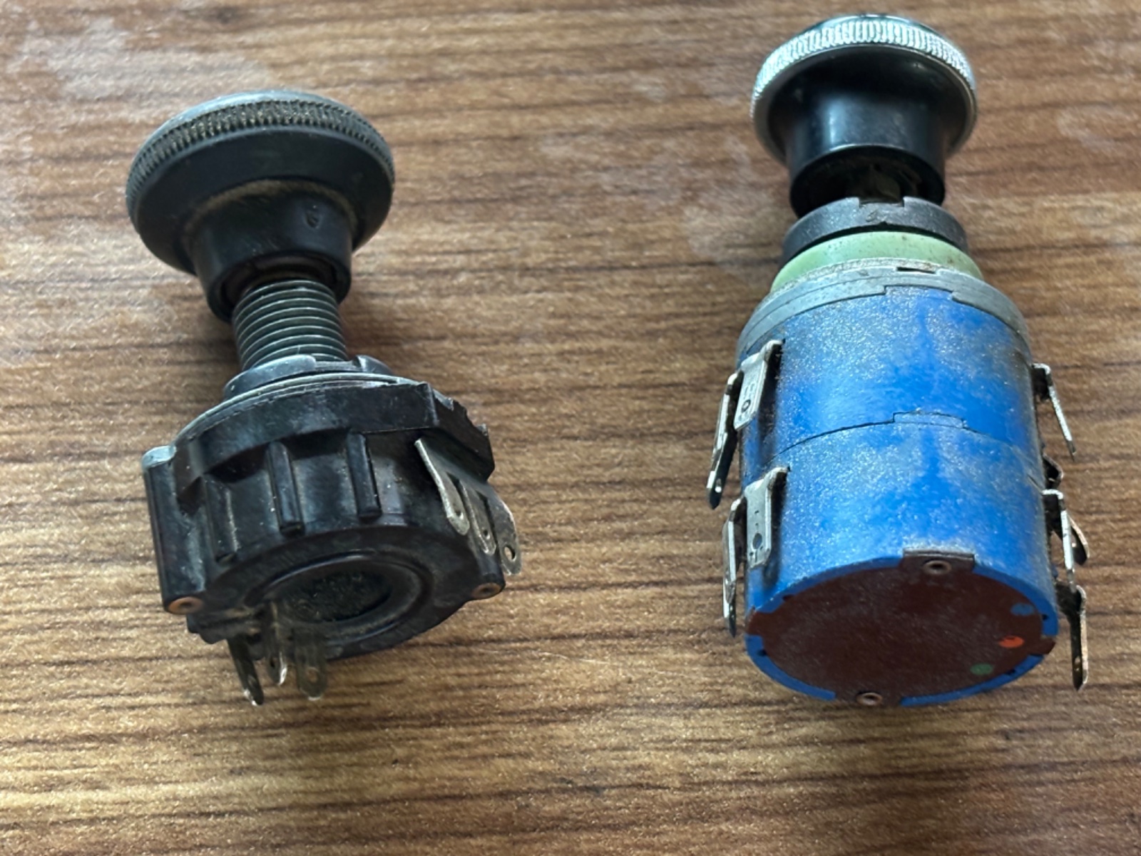

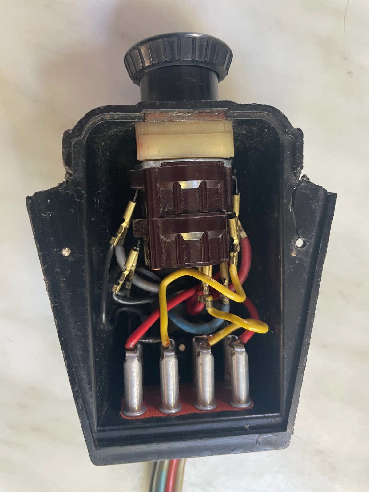

Yes, this can be done using one of the faders below.
@Lucas thanks for posting those photos. The schematics show how the faders are wired. I have both the six spade and twelve spade versions sitting around for years. Now I know how they’re wired.
Radios were dealer installed, Most BMWs of the era, e3, e9 and 2002, stereo radios, had one front center speaker and two rear speakers and a separate fader control. I imagine the installations varied depending on the radio brand and the dealer doing the install.
Faders are used to balance the signal between the front speakers in a stereo (1+2) or quadraphonic (2+2) setup.
Some car radios from that era featured a built-in fader, but it was designed solely to balance the left and right channels.
This external unit provides an additional control, allowing you to adjust the sound output between the front and rear.
In a 2+2 system, the rear speakers essentially complement the front ones, so their volume level should always be lower than that of the front speakers.
