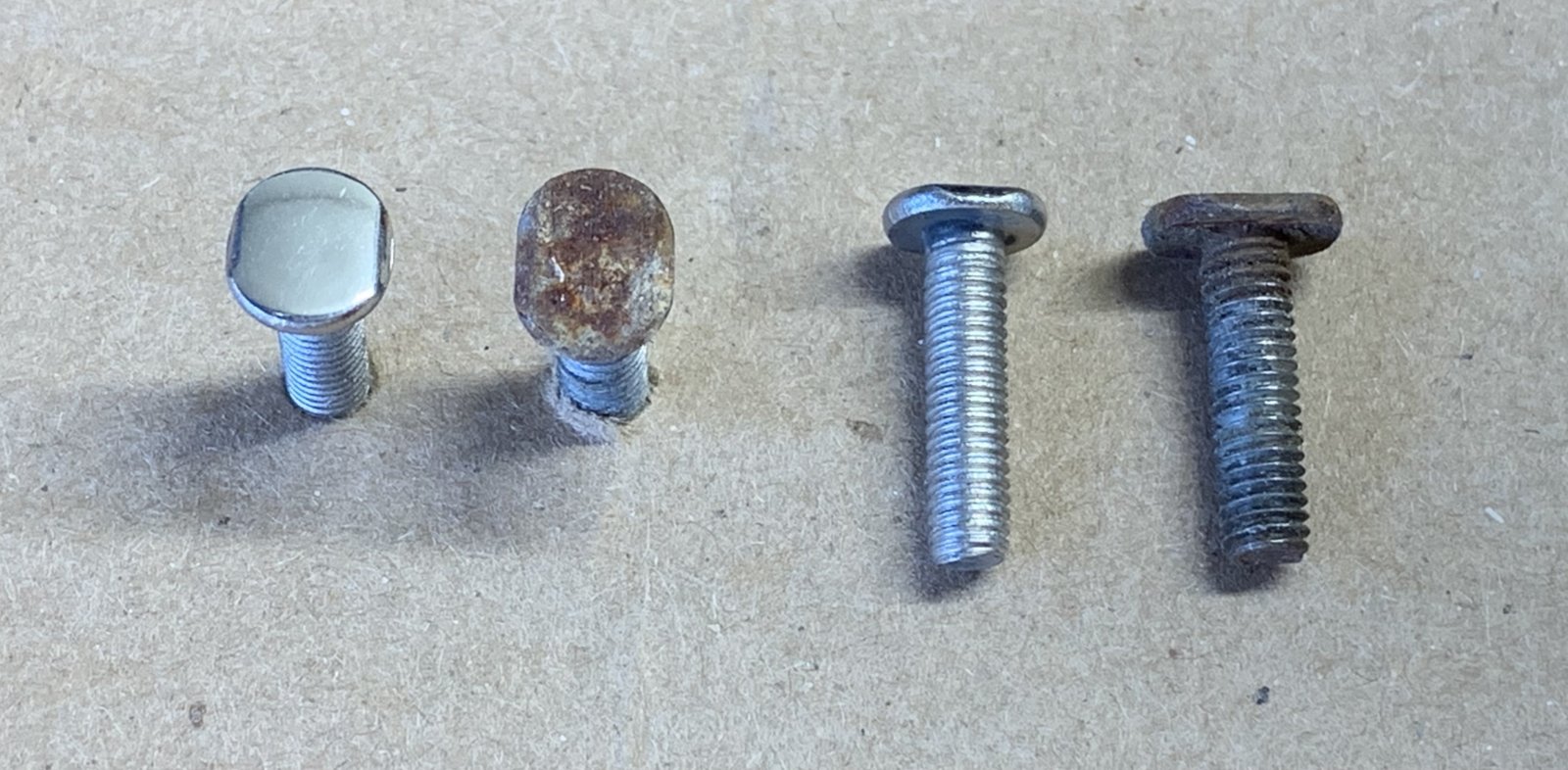

There was a discussion a bit over 2 years ago about these infamous trim nuts and bolts. At the time the consensus was that the current batch of W&N bolts were too thick and did not fit in the original trim pieces. The suggestion was then to buy the nuts from W&N and the bolts from Bmw directly.
Because W&N was selling a set (both nuts and bolts) for not much more than the nuts alone, I decided to take a chance and ordered their complete set of 90 pieces last week and they arrived today. I don’t know if they were modified since the time of that original thread, (wouldn’t be surprised if @sfdon ’s towering voice of discontent scared them back to the drawing board) but I am pleased to say that this current batch fits perfectly. They’re a little bit smaller than the originals but apart from that they fit just fine.
New vs originals

I put a tiny amount of 3M strip caulk around each. Even though the nut has a rubber gasket, I wanted a little extra to ensure no water gets in. Also protects the paint a bit.
I had the original W&N set. I found I only had to modify about half of them so there must have been a quality control issue also.

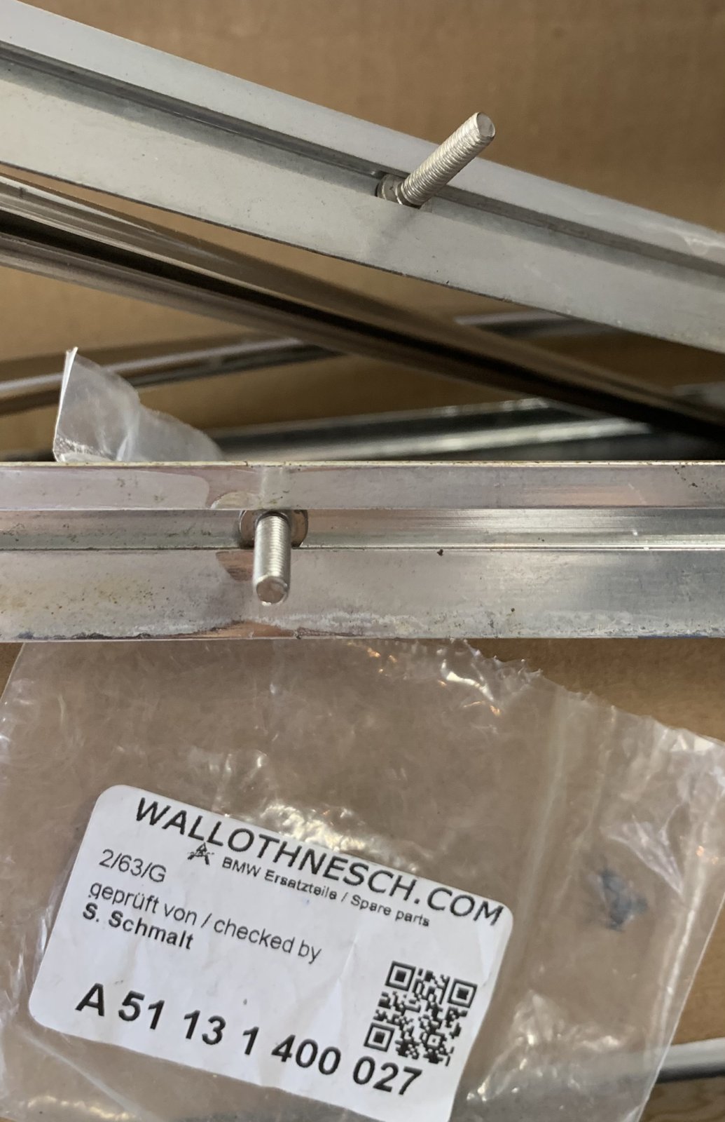

To add to the belt line trim bolt experience, I ordered the W&N package as displayed in the picture in the @Bmachine post that started this thread. The bolt head size in the picture looks the same as the bolts I received. However, these bolt heads clearly do not fit in my trim. Further, from the picture of the trim in the picture above, I can tell that slot is deeper than on my trim. Also, the heads on the bolts I removed are much thinner than the bolts in the W&N package. I installed my door trim by grinding down the heads of the W&N bolts but it was a pain.
My car is a '71 2800. I'm wondering if the older Coupes had slightly different trim which is the explanation for the variance.
