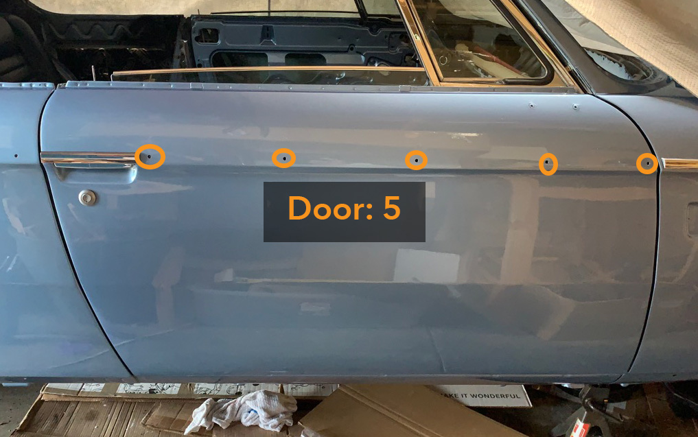

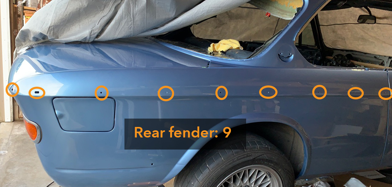

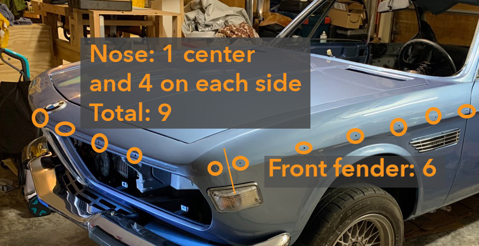

Maybe my car is different but I count this:
Rear fender: 9
Door: 5
Front fender: 6
Total for each side: 20. Both sides: 40

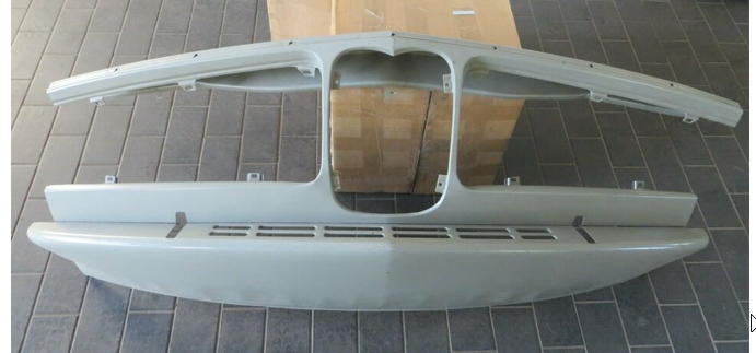

Front nose piece: 9
Grand total: 49
Is this a '74 difference maybe?
Not sure, but it is easy to ADD an extra hole+bolt ofcourse.
If you had, say, 48 holes then I'd be really curious.

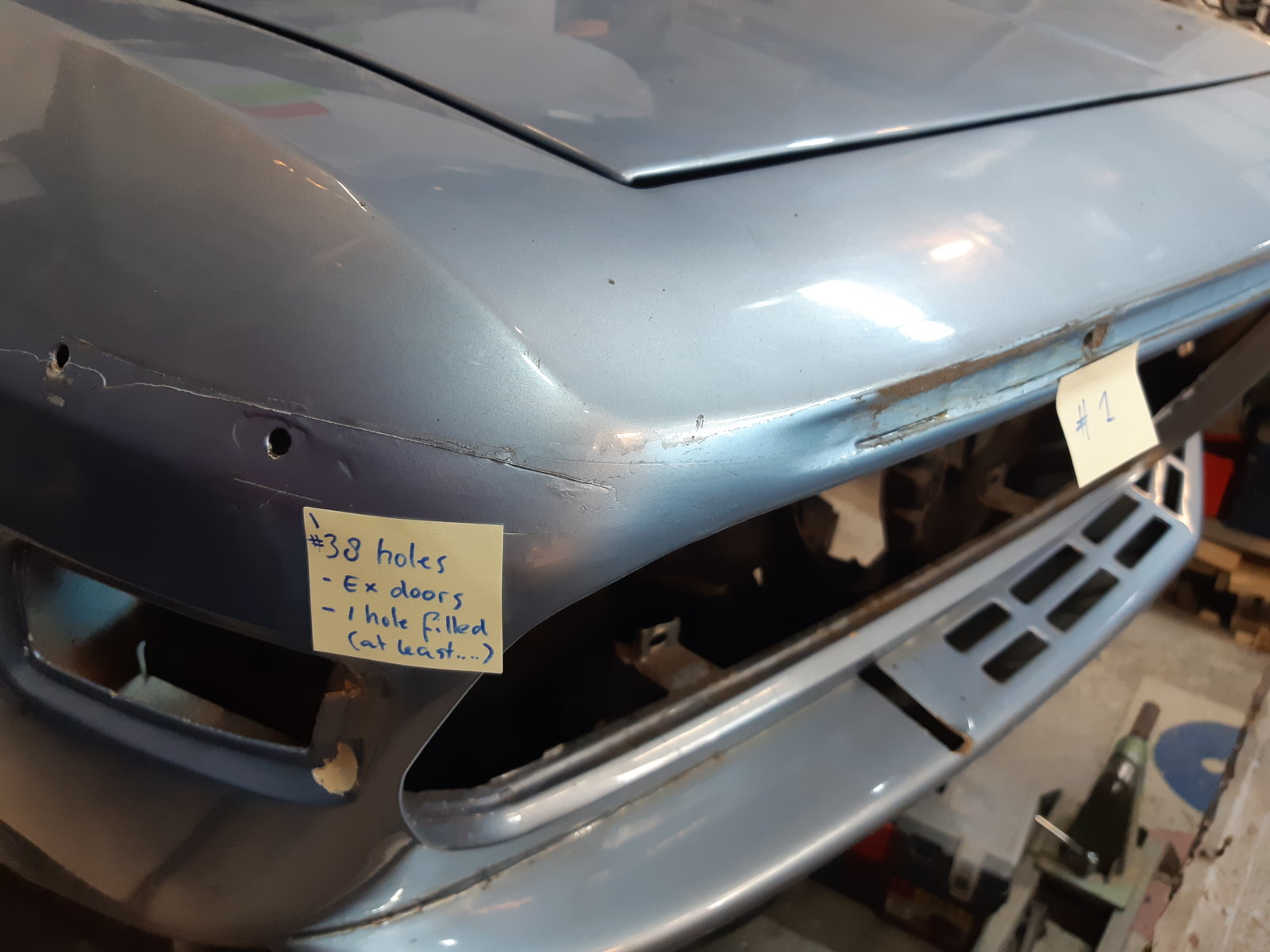

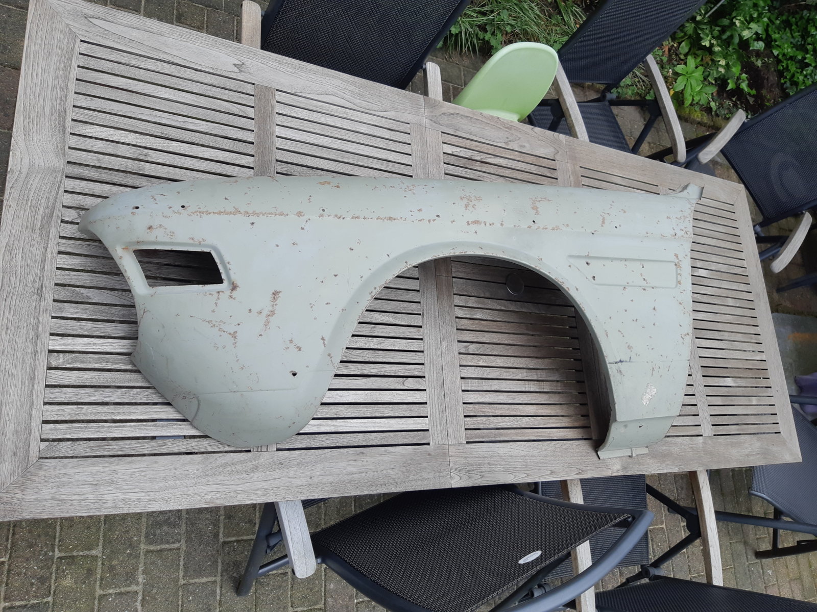

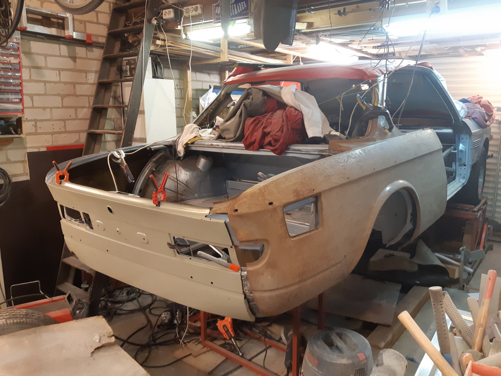

Update 15/02/2022:
My car has 38 holes in the body:
- I did not count the doors
- Clearly one hole has been closed by PO, under the c-pillar roundel as it is present on the right, but it is missing on the left. As a result on the left it spans for ~60 cm unsupported.
So total should be 39 on my body +10 on the doors would give me 49 as well. @Bmachine : our cars are alike! This is becoming intriguing.....
My car was build may 1973.
Realoem shows 45...

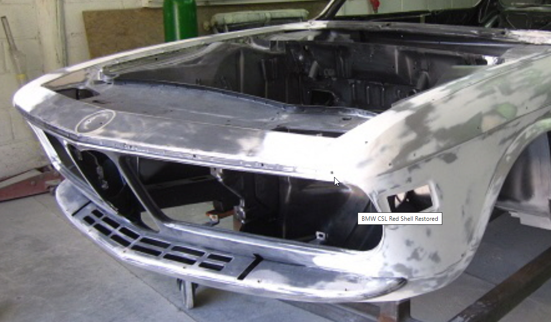

I've checked some random images on teh web of various cars in their restoration process. most, but not all of them match the number of holes per panel reported by @Bmachine and my car (49)
(note: BMachine quotes the front fender as having 6; were the fender actually as 7 holes. That is because Bmachine counts the numbers linked to the chrome trim: the front hole on the fender is actually holding the leading front edge trim eventhough it is a hole in the front fender.)
Oldenzaal; 5 on door, 9 on rear panel (8 visible from this angle) = matching to 49 total
6 on fender, +1 on fender from front trim = matching to 49 total
I did spot one CSL with additional hole in the front corner, still on the front panel: see the mouse pointer? I don't have that hole, but then again i haven't cleaned that corner of my car yet, there is a bunch of filler there in my car. this would however lead to two more holes (one L, one R, giving not 49 but 51 bolt holes!)
Could it be that 4 holes simply have no bolts through them? In designing stuff in our company we do the same sometimes: make sure the holes are in the tooling, later on we'll decide how many are really necessary to use to get a good fitment.
