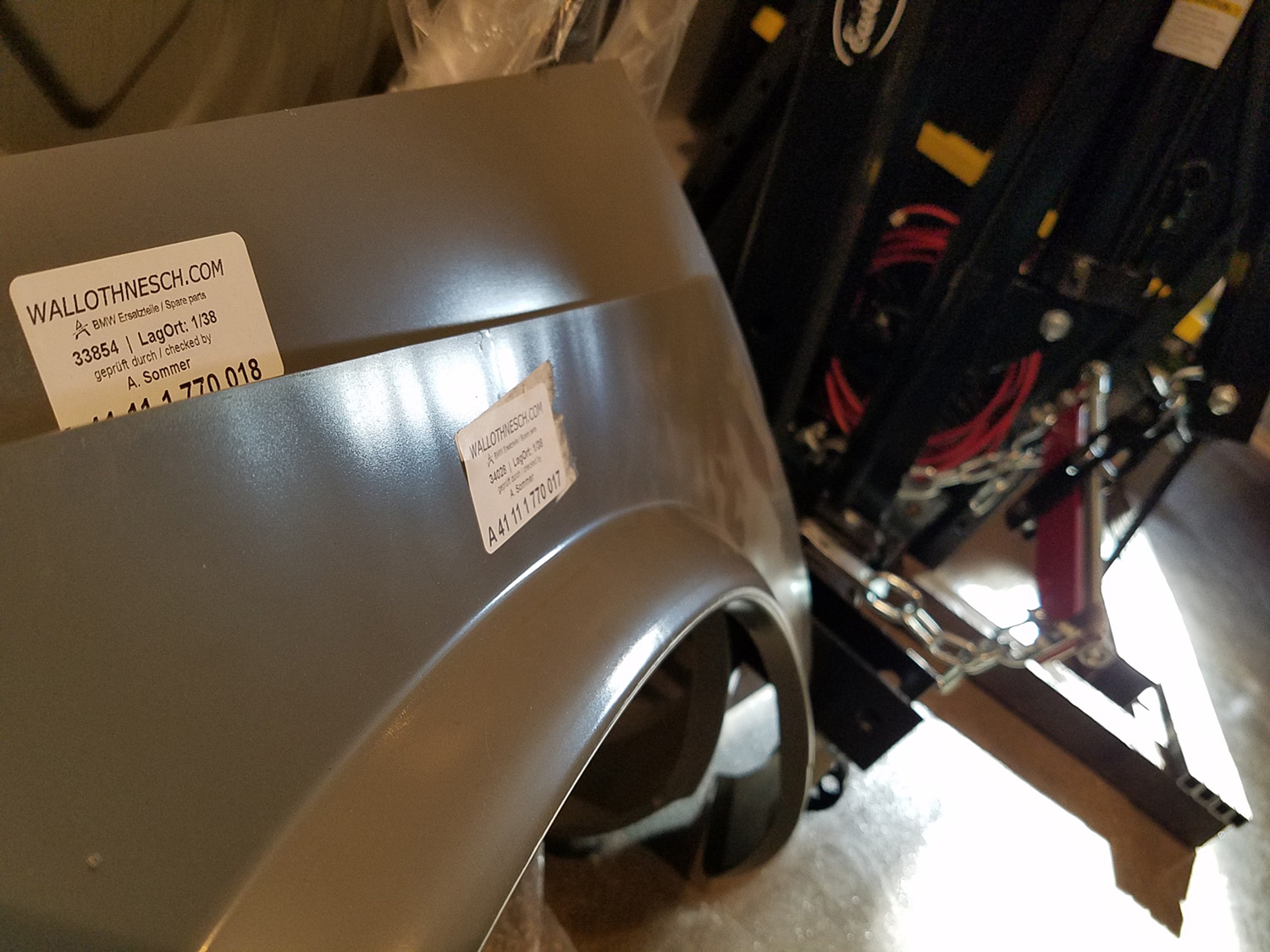

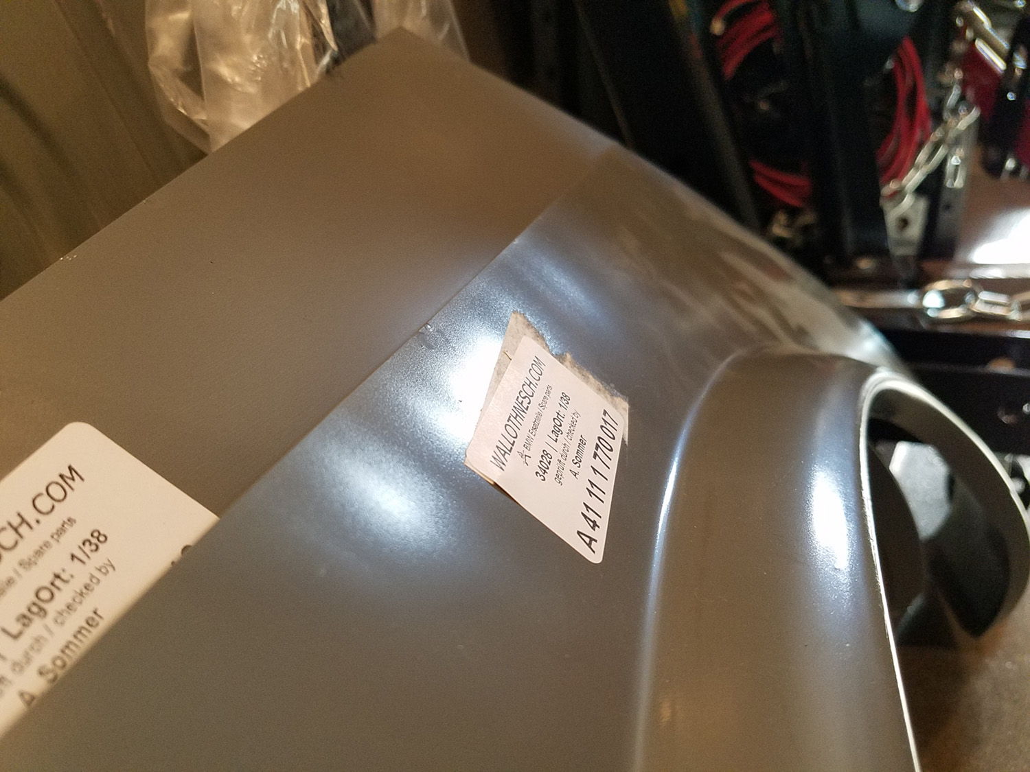

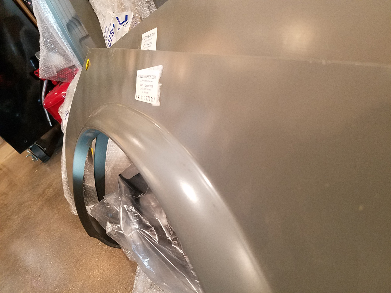

REAR WHEEL ARCH PATCH PANELS
This one bugs me. My rear wheel arches have been fussed with, and I plan on patching in new wheel arches. WN makes/sells these and they look good in concept. The overall fitment seems good as I've test fitted thus far. But there are differences between the Left and Right panels I have. Specifically, the flatter section of the patch (the area above the wheel arch/lip) on one side has wrinkled pretty significantly. I chalk this up to the metal deforming/wrinkling when it was stamped. Since the other side looks good (no wrinkles) I wondered if I just had a bad part. But when I contacted WN they told me that they don't have perfect ones for the bad side. Essentially, they know that the parts are wrinkled, but that is what they have and that is what you are going to get? Here again, perhaps a note on the part description that the patch metal above the lip itself may be deformed. At least there would be transparency.
Pictures attached of the wheel arch.
20201220-02-wheel arch wrinkles.jpg20201220-03-wheel arch wrinkles.jpg20201220-04-wheel arch wrinkles.jpg
Again, this is not too much of a rip on WN. I will no doubt order thousands more dollars of parts from them. But I hope this alerts others about what you might get when ordering sheet metal from WN.

They basically said that the ribs are in different locations depending on the year of the car.
Since they know there's a difference they should sell them for a specific year or offer two versions. They gave a non-answer. The wrinkled side panel would really irritate me. It's difficult to get a panel like that really straight using filler.
Perhaps even more difficult as I plan on shrinking and wheeling out the wrinkles so as to avoid needing much filler.
