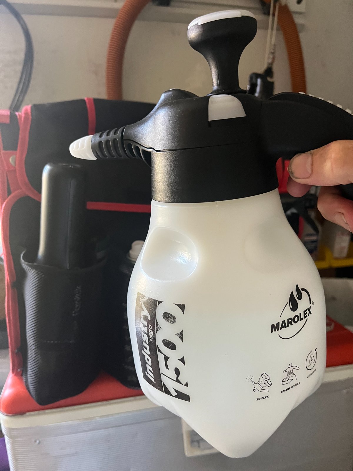

I agree with Chris. Cermic coat is amazing BUT getting the car preped is key. On my Cayenne I went with the lowest bid and he just ceramic coated over the swirls. Want paint really clean before ceramic coat. Once you have it ceramic coated you can use a rinsless wash and the dirt just comes right off. I use this marolex spray bottle and then wipe or if dirty use the Marolex spray bottle than ONR and ONR sponge. This spray bottle is very impressive!

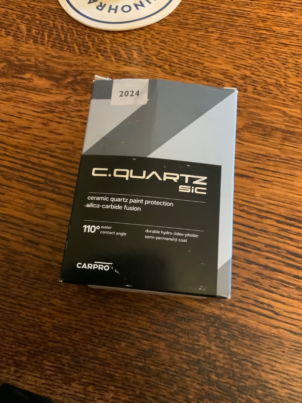

ONR user here, and I also use a ceramic coating. Speaking of which I need to re-coat as it has been a few years and I have had some paint work done in the meanwhile.
Paul and I have used this but any Ceramic of a good quality is going to cost $75-100 for 30ml. It looks tiny but can do several cars. You apply to a 1 to 2 square foot area at a time, wait 90 seconds for it to haze over and then lightly dry with a microfiber towel. Can’t apply in direct sun and you want a clean surface to start. I wash, clay, detail and then apply. A spray on ceramic is not going to last I believe.

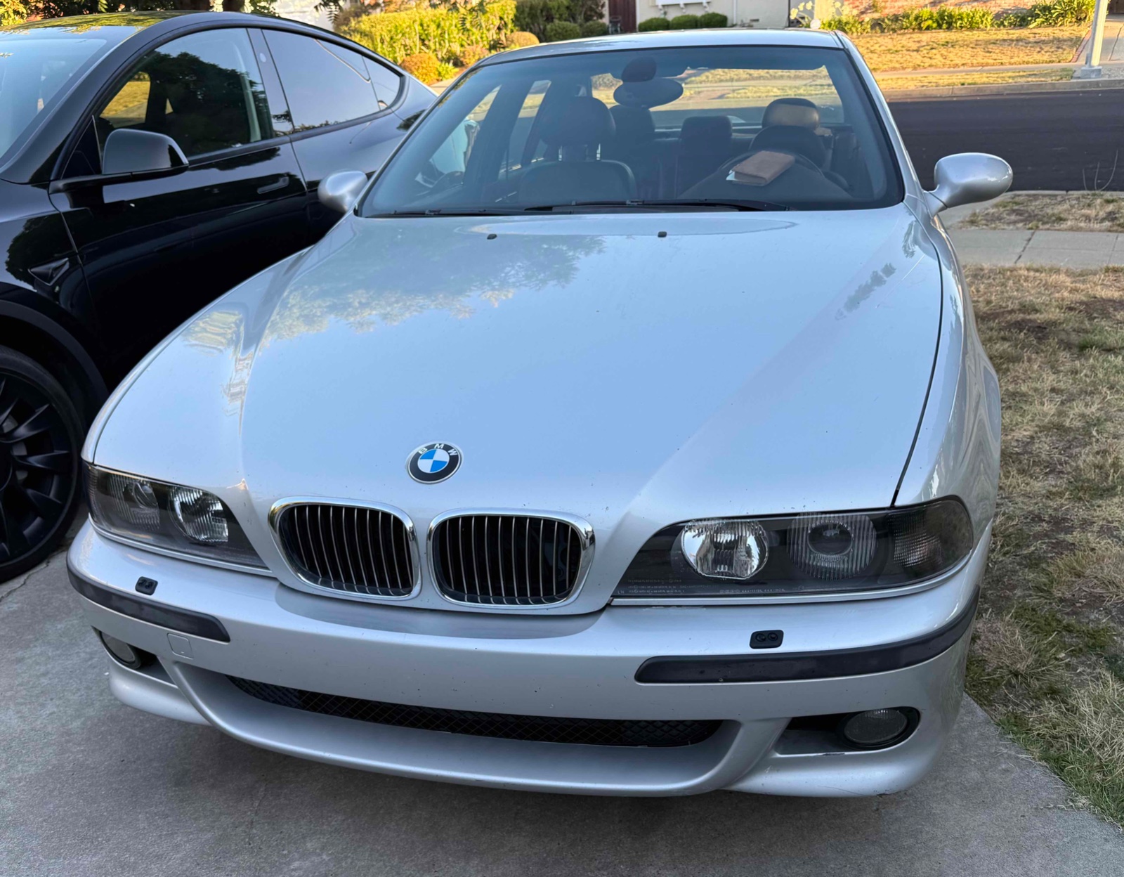

A big part of how the car looks is how clear the headlights are. DQ has methods for cleaning the Hellas from inside the glass.
On the M5 I just replaced the headlight lenses completely as the plastic ages beyond repair... Long live glass!

Yeah I once again need to redo the headlights on my e39 540 6 speed. Would love to have a glass alternative.

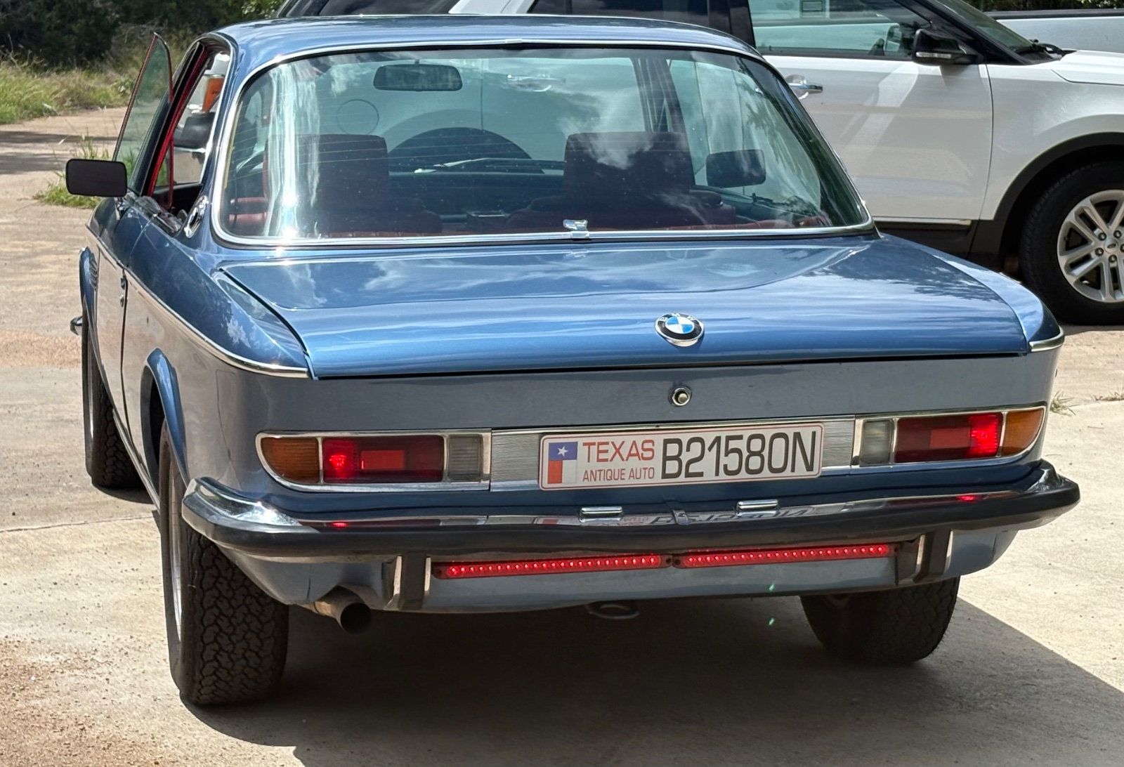

After reading this I need to go look under the car cover and see if my coupe is Still there, or rusted away. At least once A month are so I wash my coupe with water…and drive it to dry it off. We use the Griot’s speed shine in between washing.
A couple interesting things on your car - the auxiliary brake lights are a good idea - extra insurance against getting rear ended?
But that license plate really caught my eye. Are you legal to drive like that in TX?
