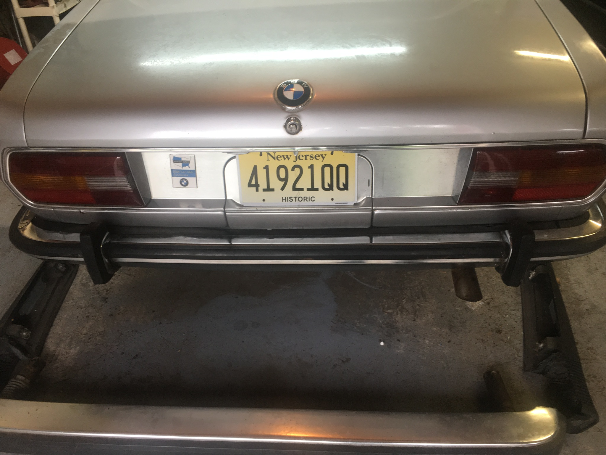

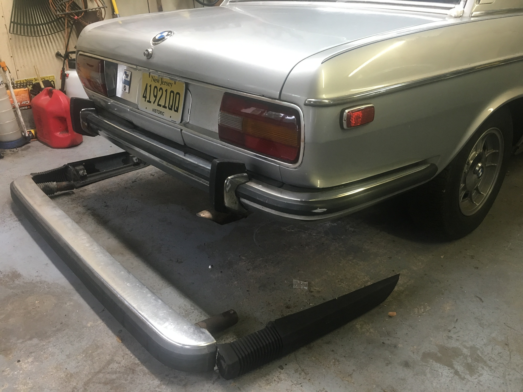

After a deadbeat eBay bidder and no sniffs from CL , I've decided to keep the Bavaria.
Today the front bumper came off. I may keep this look for awhile till I figure out how to mount the 73 front bumper.
This is what I hope to put in place:
