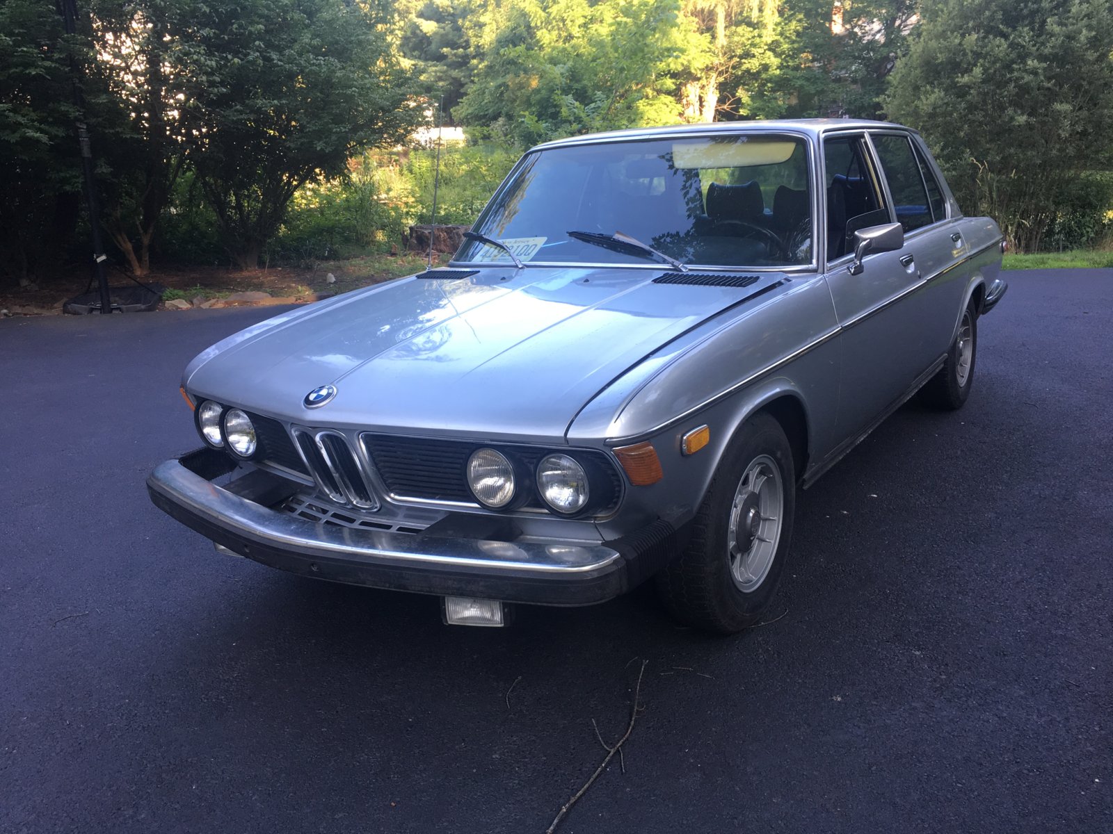

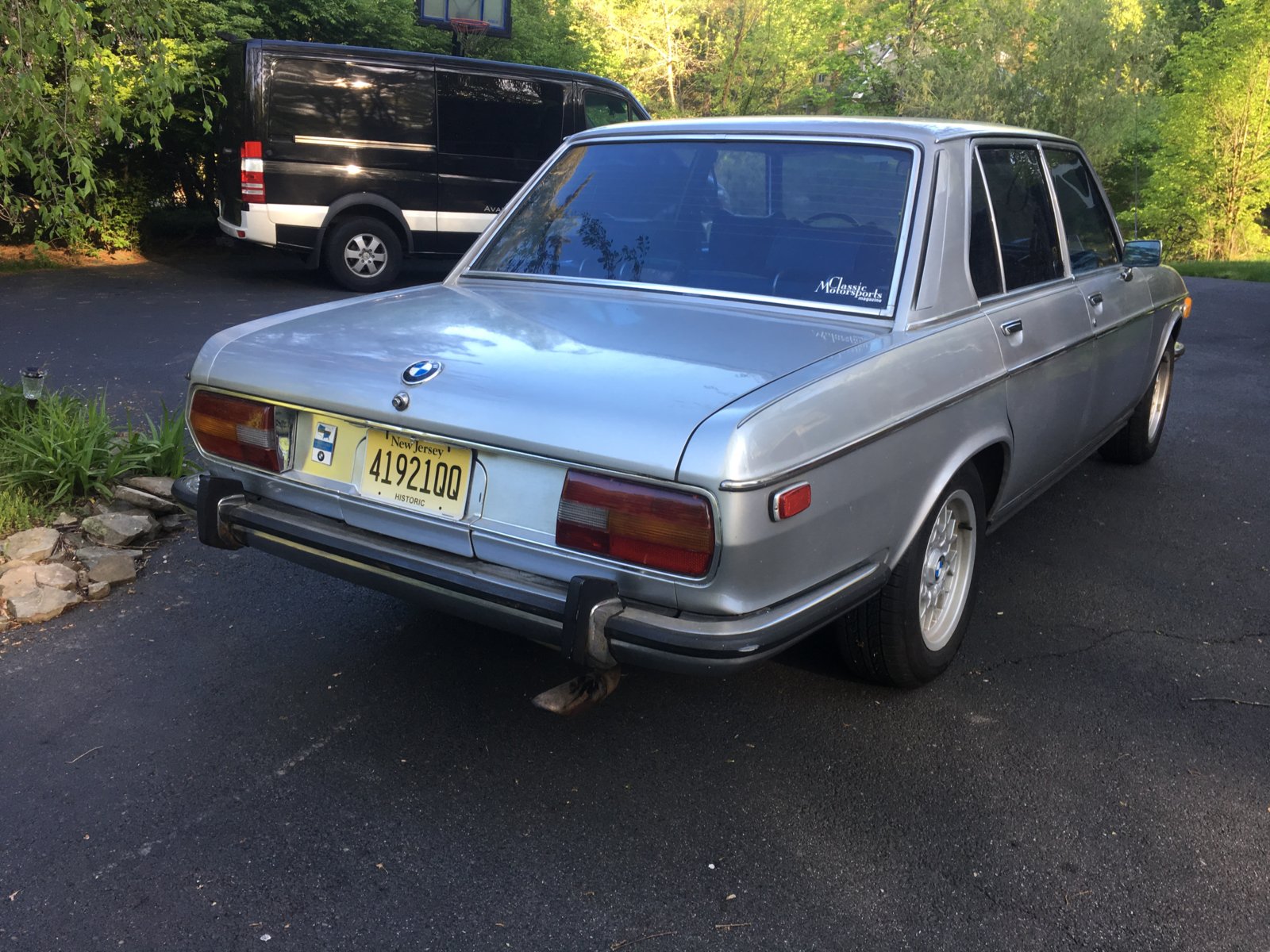

Bumper swap completed.
Before:
After: (Just how God intended)

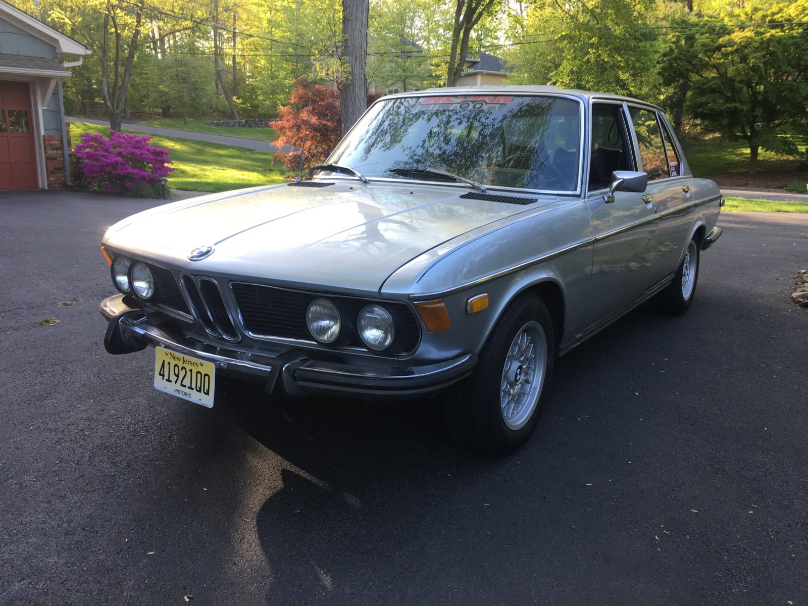

Before:View attachment 64050
Polaris! Like mine....will be again, one day..lol. What's the back spacing on those wheels? Is it the picture or do they look like they're sitting inboard a lot. I ask, as I have a set of those that I just did a trial fit and they sit way different, filling out the fenders nicely. Good looking car, though!

Wow, the rears do look weird to me. Looks like they were trying to reach a certain height for a regulation. If the fronts angle down you'd like the rears would do the same.
I used bumpers from a 73 parts car. Rear bumper mounted with the 73 US spec only brackets that extends the bumper a couple of inches from the body. Front mounted with brackets I had fabricated to fit the “wider” front section of the frame rail that had accepted the shock absorber for the big bumpers.
I followed Bfeng’s description of how he mounted the fronts in post #626 of this thread:
