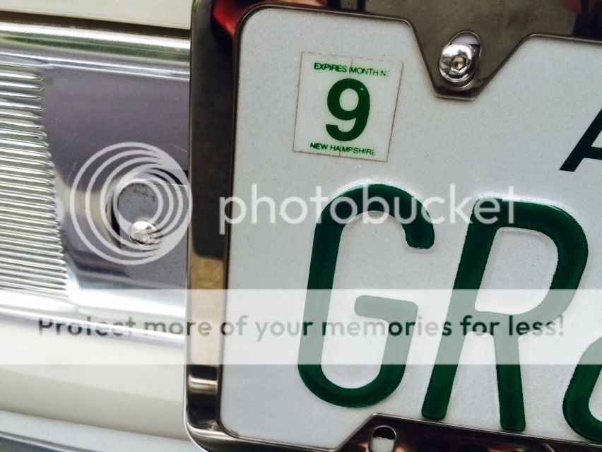

My license plates were attached using a plastic screw with a chromed plastic cap. At a car show another enthusiast said to ditch them in favor of stainless steel button head allen screws.
Looks very nice! I also replaced the screws that hold the rear license plate bracket to the car.
Looks much better, Stan.
On Athena I have neoprene washers as a cushion and to prevent water infiltration on my front license plate and air dam. Not that the car gets wet, but just in case.
Looks nice but if we're getting into minute details here I think stainless phillip screws would look more period vs. allen head.
The allen heads do not look 'period correct', but they protect your license plate and/or stainless plate frame from thieves MUCH better!
I doubt that very many thieves carry allen wrenches, much more likely to have a phillips screwdriver. I too use these in stainless on my classic and antique vehicle plates.

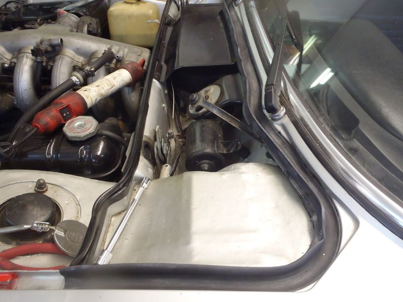

I decided to replace the gasket that seals the rear of the hood. Started by ordering it from BMW. When it arrived, it was grey, not black. Sorted that out in this thread
http://www.e9coupe.com/forum/showthread.php?t=20007
Then went ahead with the install. First, the original look

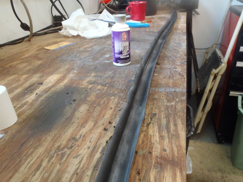

Got the gasket all cleaned up with Simple Green and some Meguires detail juice. Then treated with Gumm whatever. Didn't do the back side as that's where the glue goes.

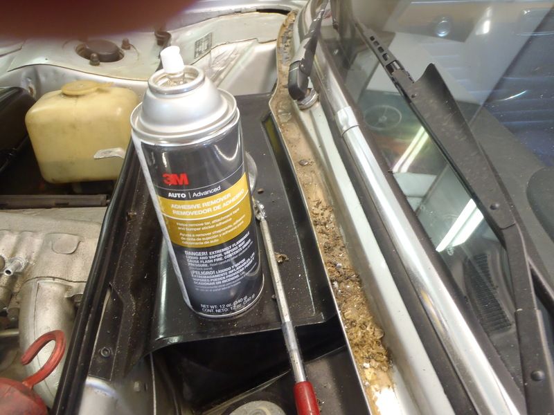

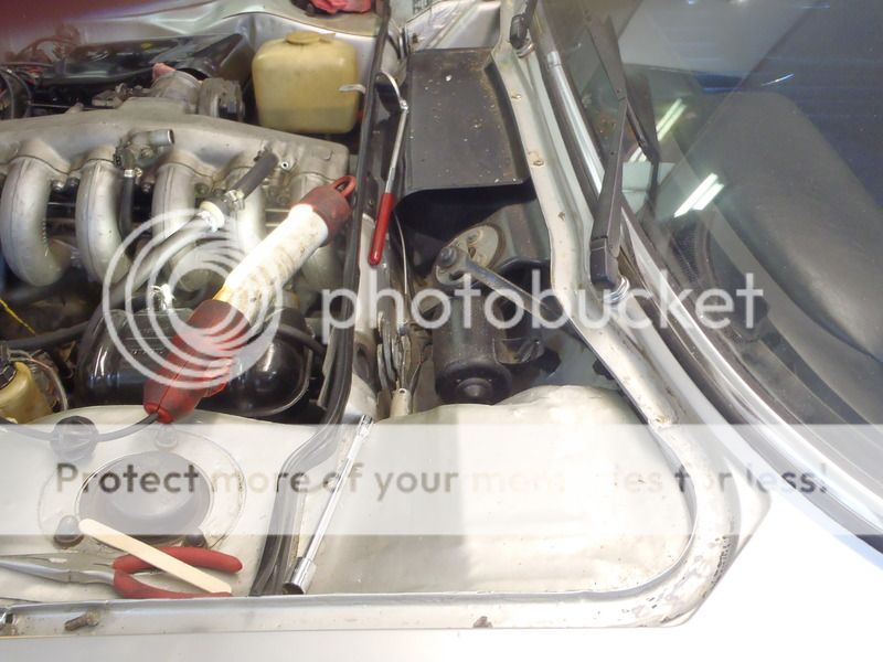

Cleaned off the old stuff with a combination of careful scraping and 3M adheasive solvent
Nice and clean!
Job done! I used 3M gasket adhesive. Apply and let dry until tacky
Jeff:
Good luck getting the trunk lid to close for awhile. You may want to loosen the latch and then progressively tighten it as the new gasket takes a set. Remember to remove any heavy tools from the toolkit if you're slamming the lid.
