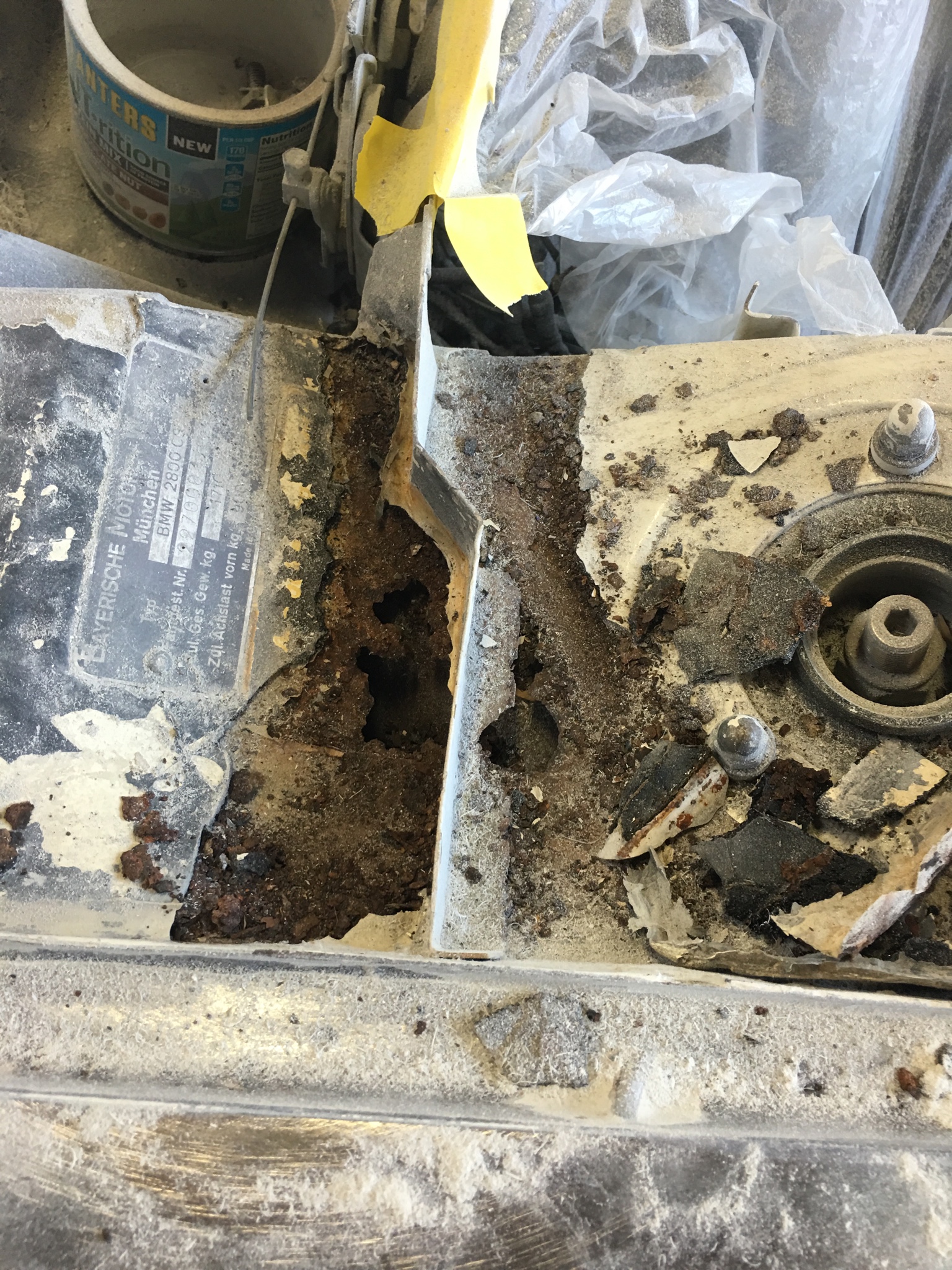

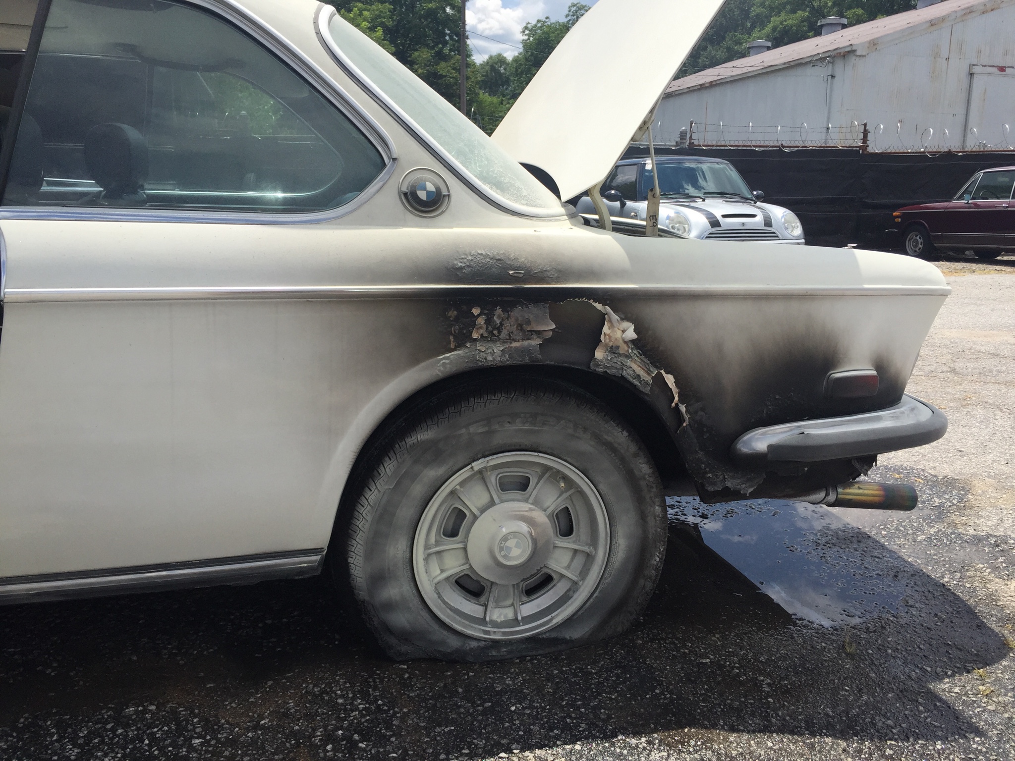

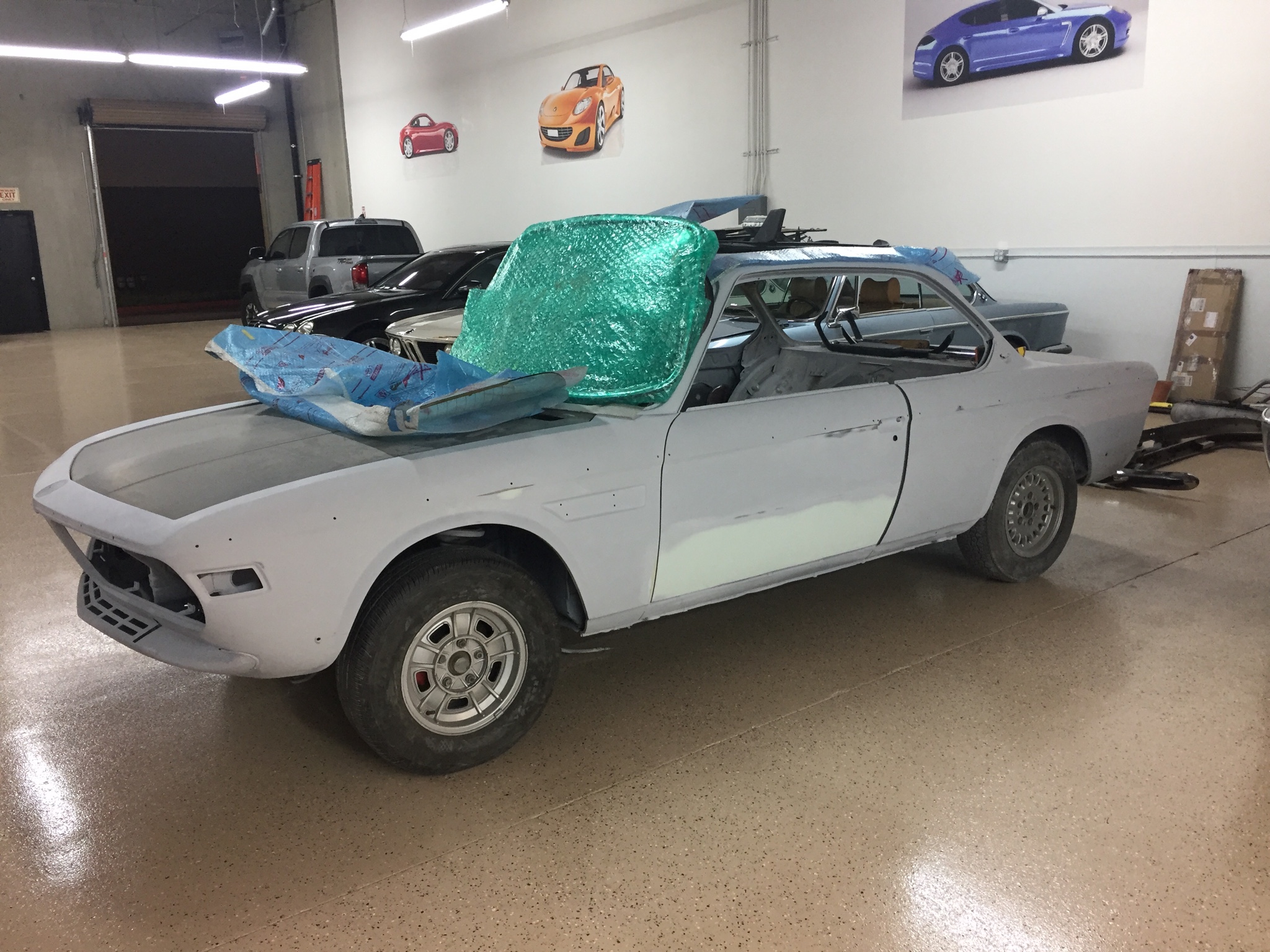

I saw my car for the first time without any rust. Yes I understand how strong of a statement that is and now it's headed to the painter.
As a reminder, here are some before shots

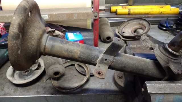

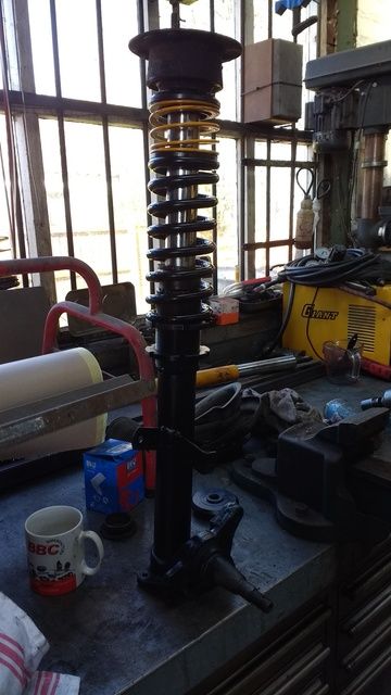

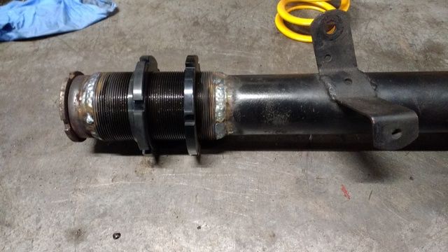

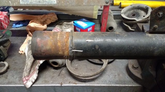

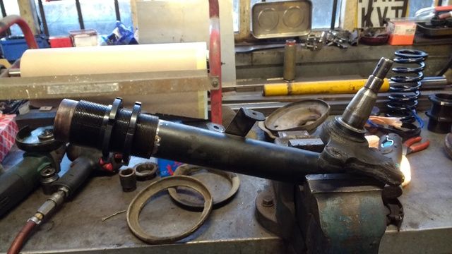

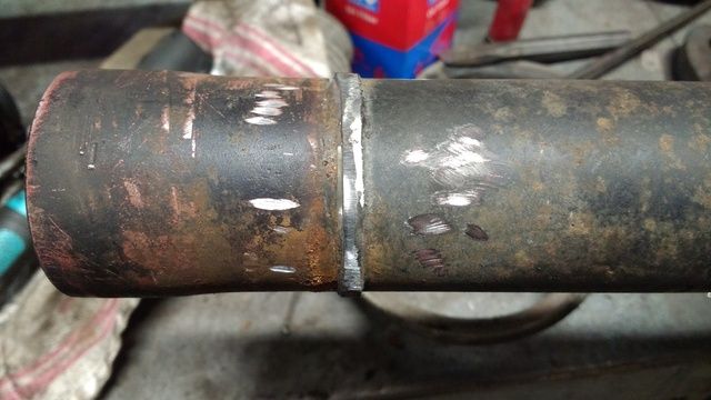

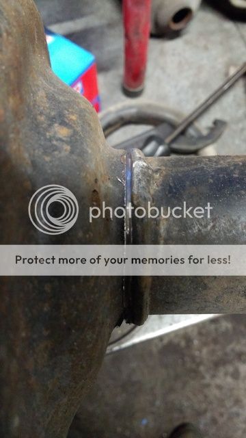

Today I fitted my adjustable perch 2.5"coil over set.
Weld was not completely removed to act as a support for the threaded sleeve .
Thinking that I should've gone with 7" springs as ideally I'd like the car .5" lower. Without the assister spring and it's perch it would ride about right but the perch is all the way down so I'll be ordering some shorter springs soon.
