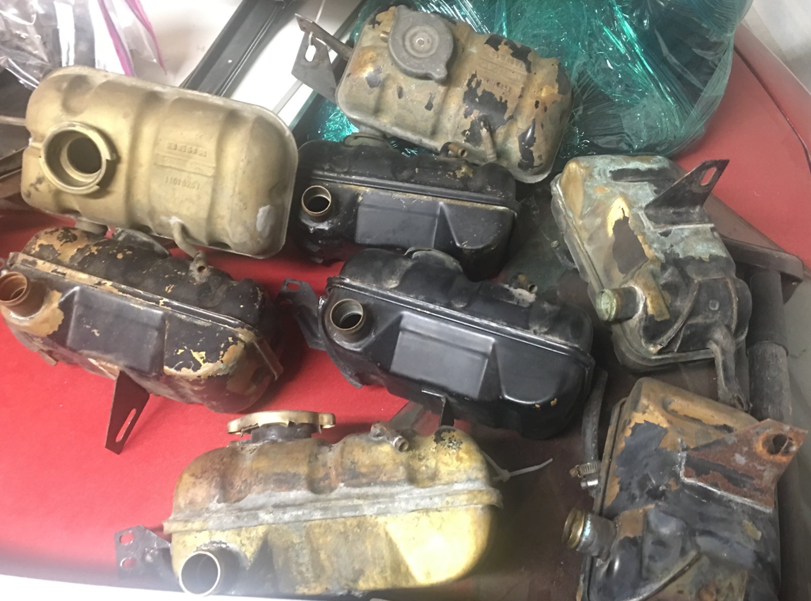

After so much of my car has powder coated parts, we'll I didn't do the Webers like the Ferrari I saw at Amelia,
you see I have this brass overflow tank. I know some of you like them natural brass. Just didn't fit my engine compartment color scheme and paint just didn't look good and was easy to scratch.
So I thought I would get it powder coated.
All my suspension, and many engine parts are black or silver.
I took it to the powder coater who after 3 years of this is a pretty good friend.
He looked at it and said I think this may come apart from the heat.
I said I had thought of that but actually had an extra so give it the college try and let's see what happens.
He turned the heat down on the oven to 380 and went home. In the morning the tank was on the floor.
He called me and told me and I said oh well we tried.
Went to pick it up thoroughly expecting it to be in 5 or 6 pieces.
Not, just the brackets that it mounts with and the neck had come loose and very cleanly.
Took it home cleaned up the pieces and got out the solder and flux and back together it went.
I did burn the powder coat some on the bottom where the big bracket goes because I had to heat such a big area. You can't see the bottom when in the car so I now have a powder coated overflow tank that will look like new for many years.

Definitely pressure test it before installing. I have a few that I need to do. I am going to take them to the vapor blaster next week. I’m just going to paint them. I’m also having new lower brackets cut via water jet.
Why bother with powder coating when a nice high temp engine primer/paint would look nice and last a long time. That’s what I used on the radiator on my XK, and 8 years later it still looks like new.
I just use SEM Trim Black or Uphol Satin Black, high temp not needed, both spray well and dry quickly without runs or sags.
My powder coater refused to do my tank. It painted it with a rustoleum flat black, and it looked ok until I spilled brake fluid on it.
I use Duplicolor Satin wheel paint. I have used it on Alpinas, Weds, and all of my AC face plates. Great spray pattern also.

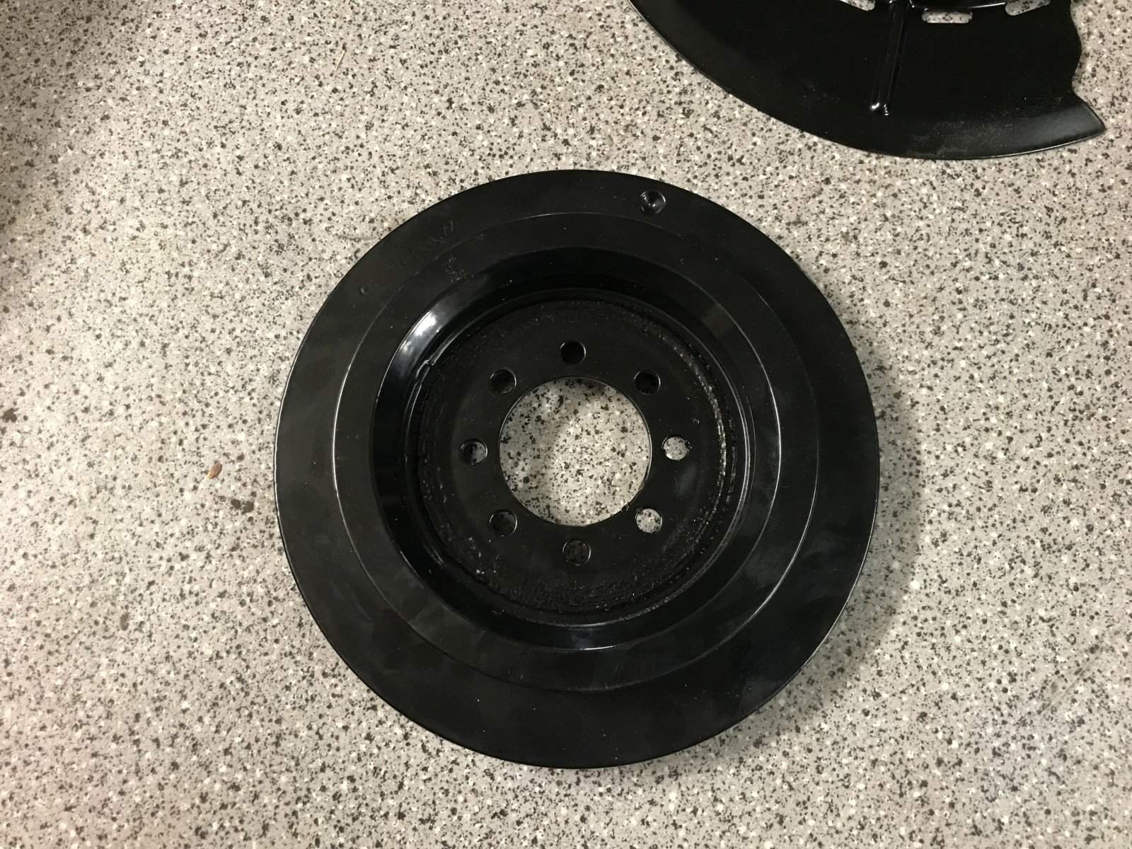

I accidentally had my harmonic plbalencer powdercoated without thinking, wasn’t until after I realised it contains rubber and I had destroyed it.. oops
Sorry James, I did know about that one and painted mine. A good thing is that you can't see it.

looks like you could file the solder off the edges to clean it up a bit
ugly solder job.
repaint i always use "rustoleum"
paint the absolute best
ugly solder job.
Um, would you like to come over and see if you can do any better than BMW did from the factory.
You obviously didn't read the thread very carefully but you looked close enough to see the solder along the edges.
I never said it came apart at the seam, in fact I said it didn't come apart at the seam.
I said the brackets that it mounts with came off and the neck. Easy to re-solder.
In defense of the statement (not the poor delivery approach)... I don’t think that your tank left the factory that way. The seams don’t look “ugly” but they may have shifted in the oven. The tanks are often repaired also. Looks just fine to me. I can show you much worse.
