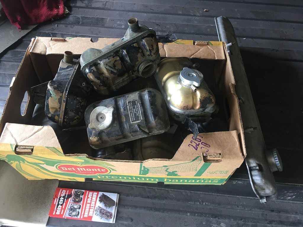

I hope that @m5bb doesn't mind that I am pilling onto this thread since it is about brass coolant tanks. I dropped off 9 tanks at the vaport honing guy today. He took a test pass on one of the tanks. It looks sparkly but there is no pitting. I'm going to shoot them with primer and black after repairing any solder, but I'll post a pic of the vapor honing results. You don't want to dry blast these things as it leaves them cloudy and pitted. Looks like vaport blasting will take off old zinc also.
