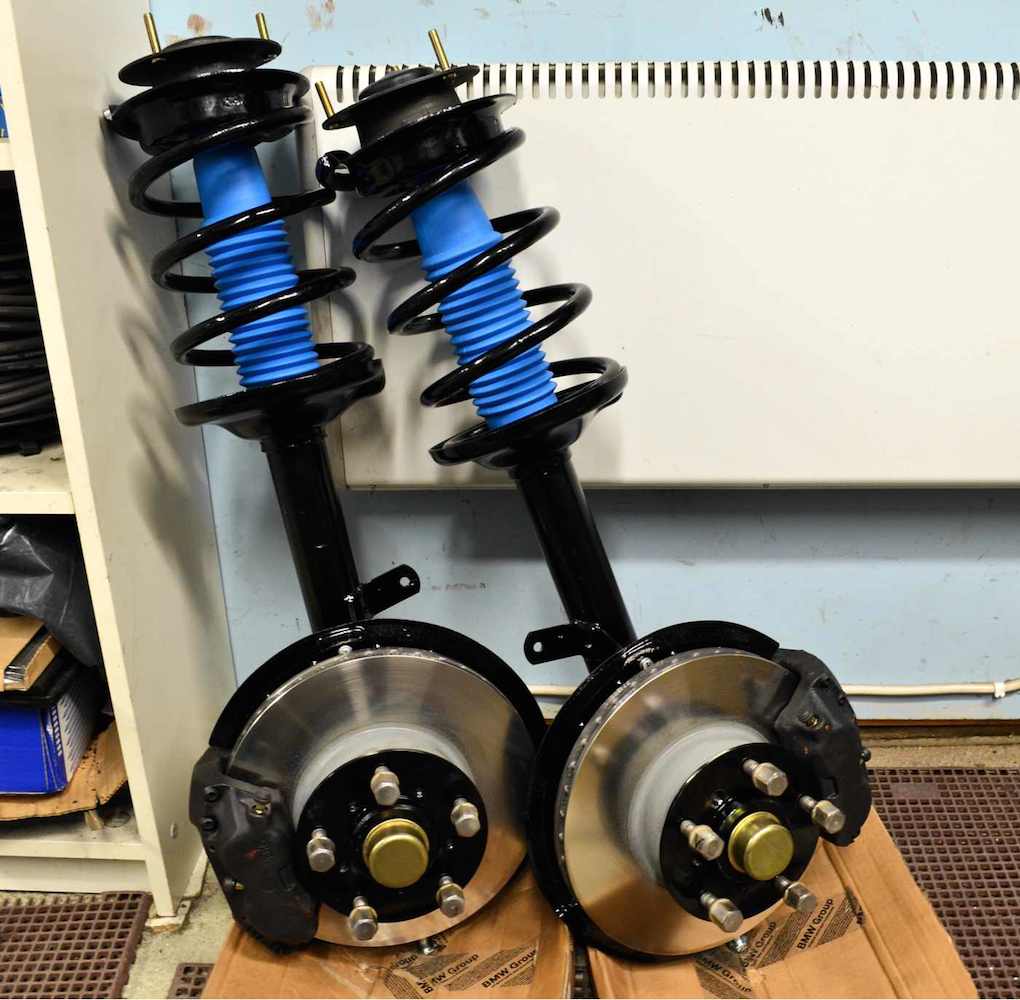

Here is an early pic of my struts before I installed lowering springs and camber plates, I also had the three bolts cut down a bit since I don't use the US-only spacer, which happened before I removed the bolts to install the plates.

As I previously said, my bolts were already cut by half, or more, before I knocked them out (I have no spacers).
I'm pretty sure they should go straight out without compressing the springs, the strut top mount rotates, so you can move each bolt to the place with most room.
I'm not sure if the full lenght (for US spacers) bolts would go straight out without cutting them down first. I don't know why, but my new replacement strut top mounts I bought came with full-lenght bolts to use with spacers, as can be seen in my previous picture.
