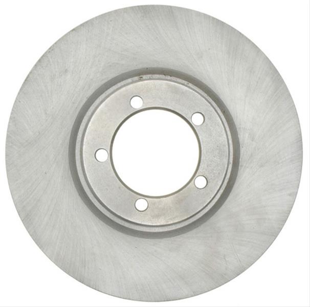

My understanding is that the E3 solid rotors are not readily available, but still out there if one looks hard enough. Are the vented rotors (Euro) a part that is in better supply? I have both styles of calipers and just want my car to be serviceable. Please feel free to post part numbers and manufacturers/brands/suppliers if you like. Cheers

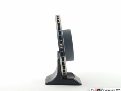

I'm looking for some good sources (and prices) for vented front rotors. Unfortunately, I ordered them from ECS and of course they waited a long time to say they were unavailable.
From a recent post, the only aftermarket solid non-vented ones available don't fit- Raybestos 9841R.

If not, we know W&N has the vented ones.
My question is do any later vented rotors fit? I think anything later than E3/E9 has the rotors sitting on the outside of the hub so they won't work? Not to mention the diameter difference.
I have three pairs of decent solid rotors but none around me will turn rotors. Is the rotor easy to mount on a brake lathe if I find someone?
I just ordered and received vented front rotors from WN (approximately 1 month ago). I also ordered rears - I'm all set to stop.
Discussed earlier, they don’t fit
