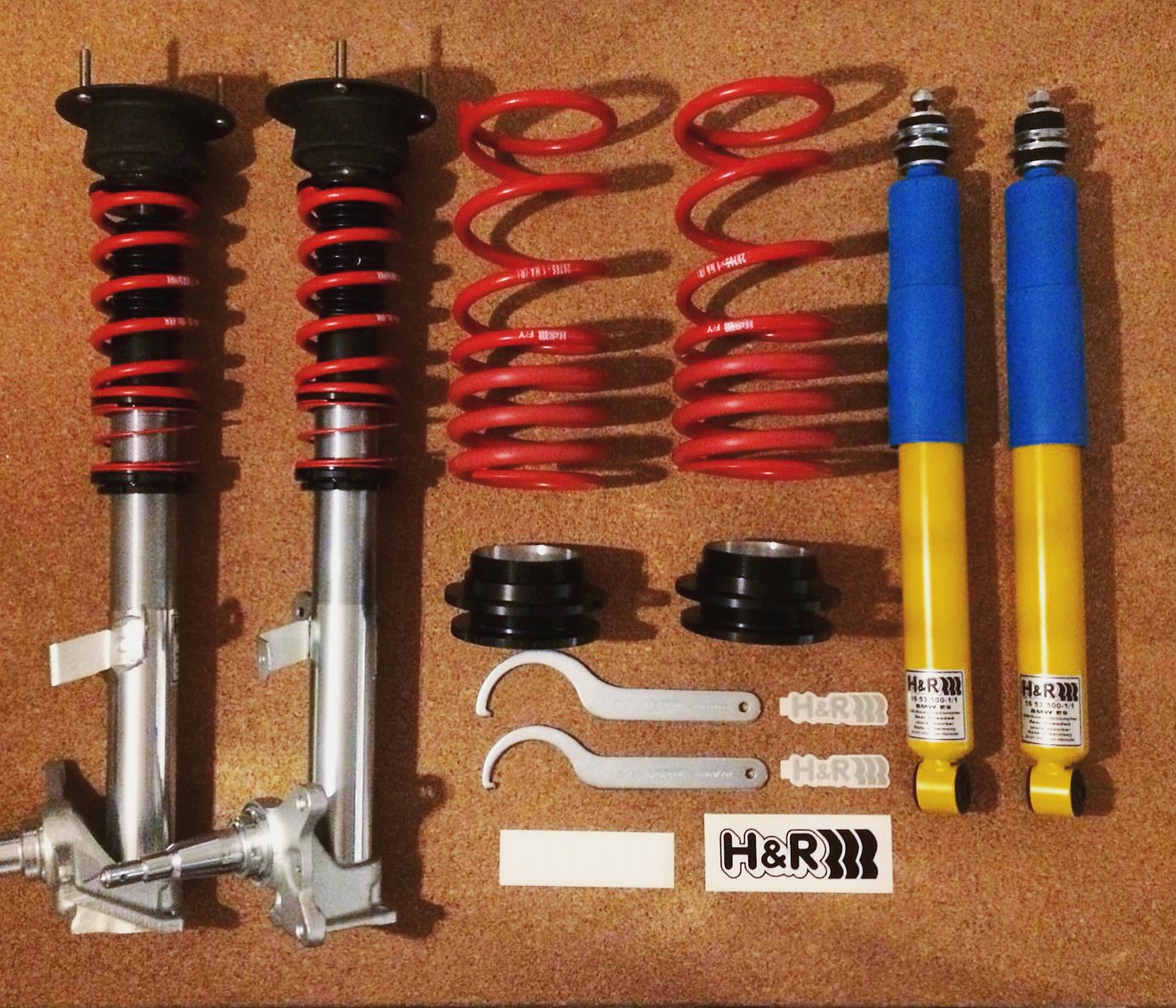

My H&R set up wait to install.

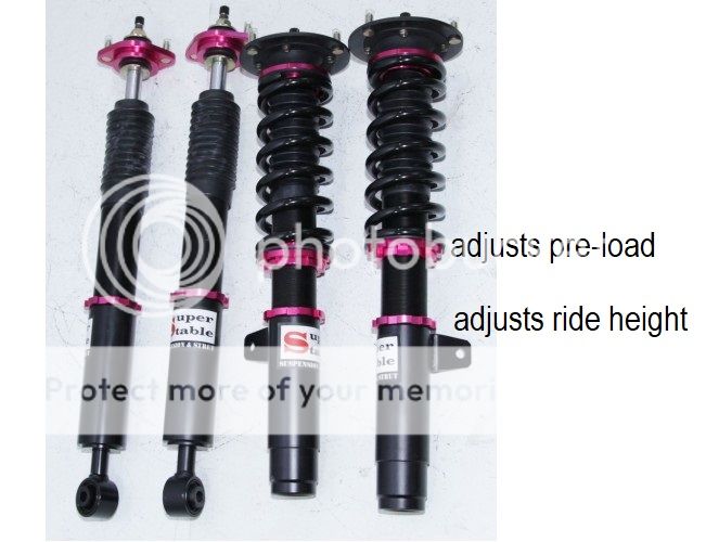

I actually wasn't referring to helper springs, but I now understand their purpose! Speaking of helper springs; JamesE30 on your H&R setup, what is between the helper spring and the main spring?

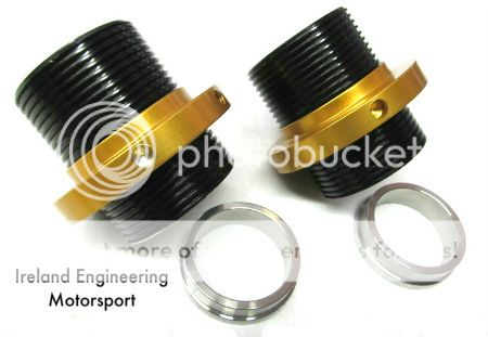

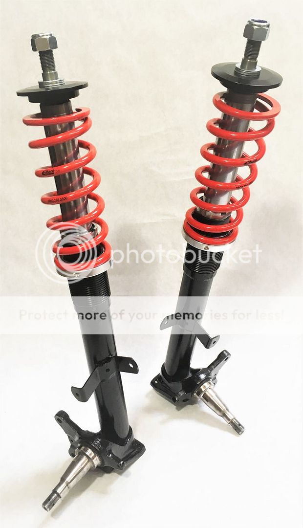

I was getting myself confused before after looking at examples of these strut assemblies (picture1); that seem to more adjustment than I would if I were to install the IE Perch Kit (pictures 2&3).
