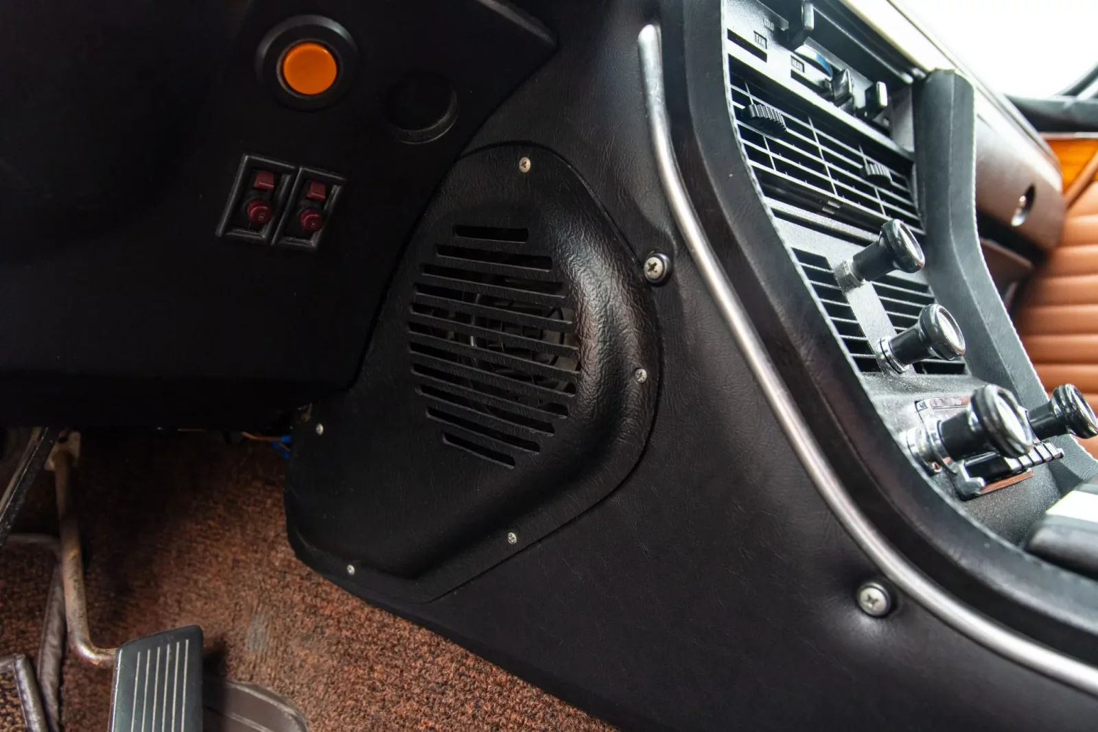

so the title asks the primary question - i would guess either 2.9 x 10 or 2.9 x 13. the follow up question is what is the correct finish - silver or black? i have seen pics of both ways. this is a pic of a well known car with silver - both for holding the a/c plate in as well as the grilles. the 4.2 x 32 countersunk screws that attach to the a/c plate aren't available in silver from belmetric - only in black oxide.

Chris, the pic above is from your malaga coupe. i know the ones in the side grilles were small ... i just don't know the size of the small ones and it isn't listed in the orange book or realoem.

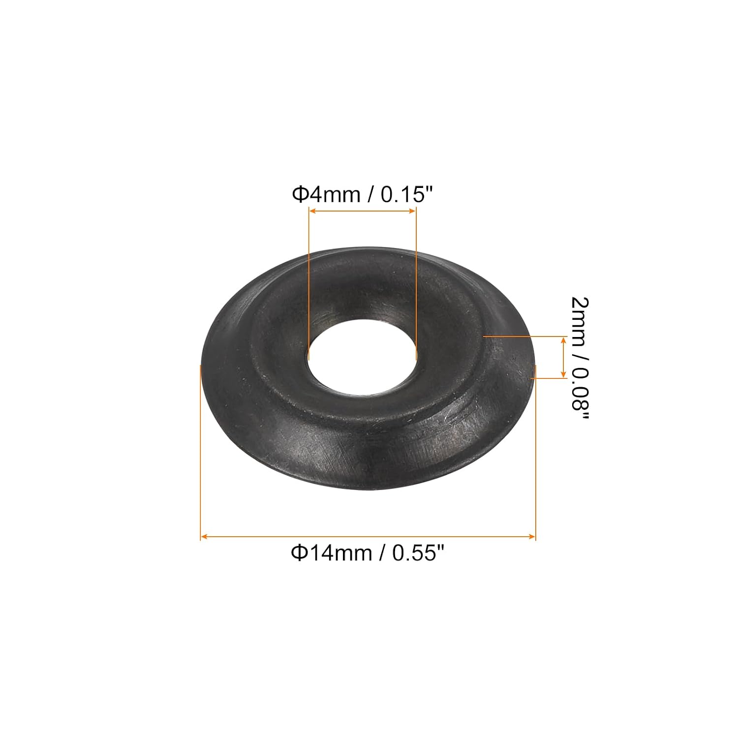

The most important part is the washer. Mine are black recessed hollow flush washers for oval head screws.
i have black and stainless hollow washers in various sizes (3, 4 + 5 for sure). with the hollow washers, oval head countersunk screws look the best.
