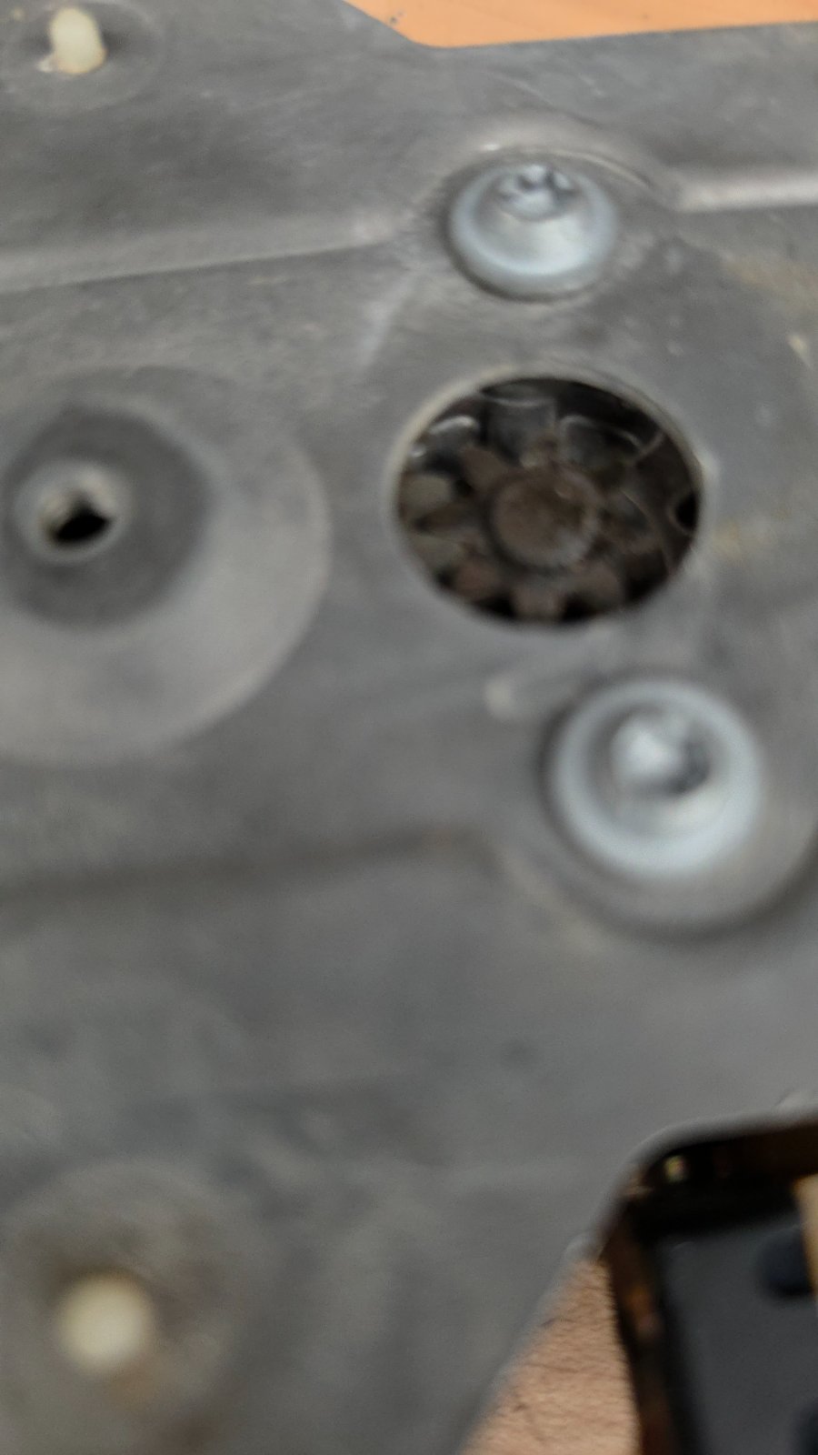

I installed the new motor but was very disappointed with the speed. Even if I cleaned all the old grease out of the tracks this will not be an improvement. Then I understand bolted the motor and retested and it is significantly faster. How do I lubricate this window regulator?

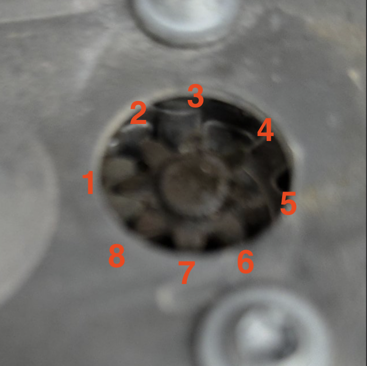

Does your new motor have the same number of teeth on the gear as your old one? There are at least 2 sizes out there.
See Thomas76'S note above. My motors (and all E9s??) have 8 teeth. Some very similar motors from Porsche and MB have 10 and on ebay they look like our motors so...
The picture in the original post appears to show an 8-tooth motor.

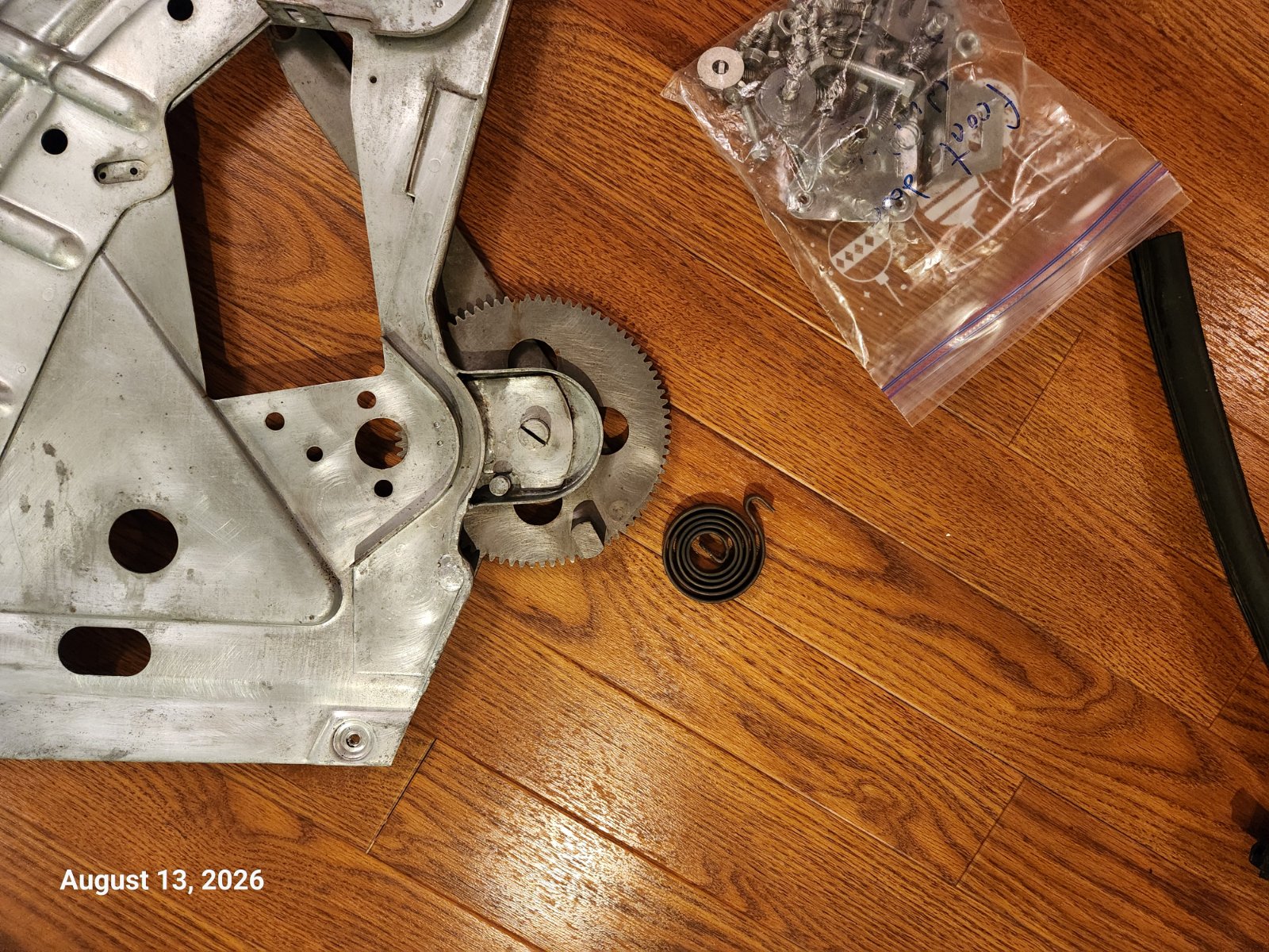

I now see, from your picture, that you’re working on a front window regulator. So you’ve got it on the test bench. Once removed, the regulator-arm with large gear and motor mounting plate is detached from the ball bearing bracket and tracks that bolt separately into the car door. So if in your bench test the “far end” of the regulator-arm is not pushing a window around the only drag on the arm is its pivot point and the spring (in one direction). I think you said that you can manually move the regulator arm when the spring and motor are removed – that is good and necessary. So why does the new motor only slowly move the unloaded regulator-arm on the bench? My guess - 1) your power supply may not have enough current – try a car battery with in-line fuse or 2) the slowness you perceive is in the downward direction, against the spring force, which normally has benefit of a heavy glass weight pushing down to help the motor.
I have not done your test but maybe you don’t have a problem and it’s only in your set up. Remove the spring and if your motor can swing the regulator arm up and down equally fast then there is no binding. Good luck.
