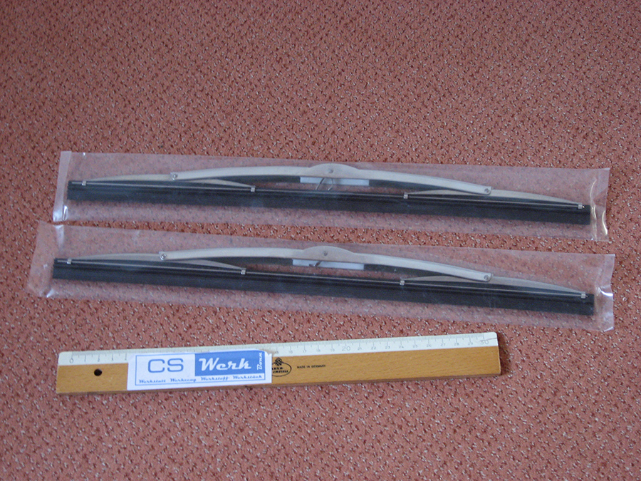

E3/ E9 have the same length and both need the hook type.. although you have to insure the base matches the spindle.
Hopefully some once can confirm.

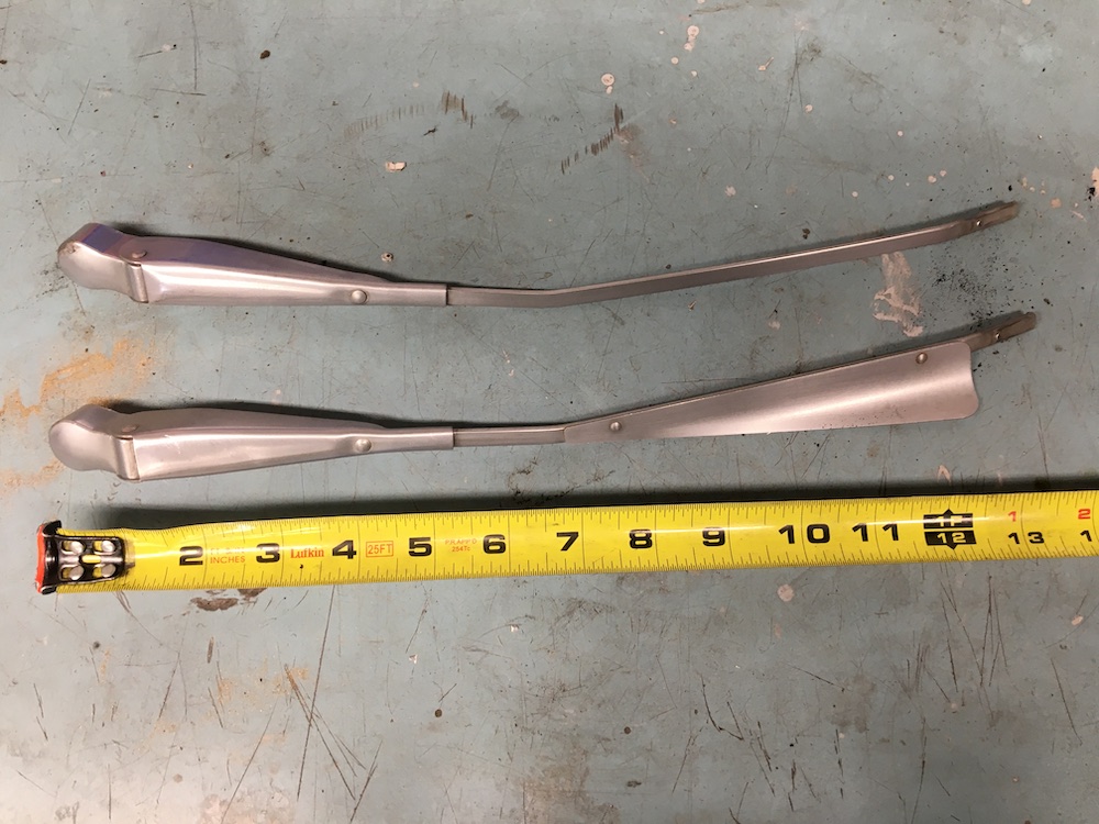

Mot27cars
1,216
649
Elkhart, IN
These are on my 72 Bavaria

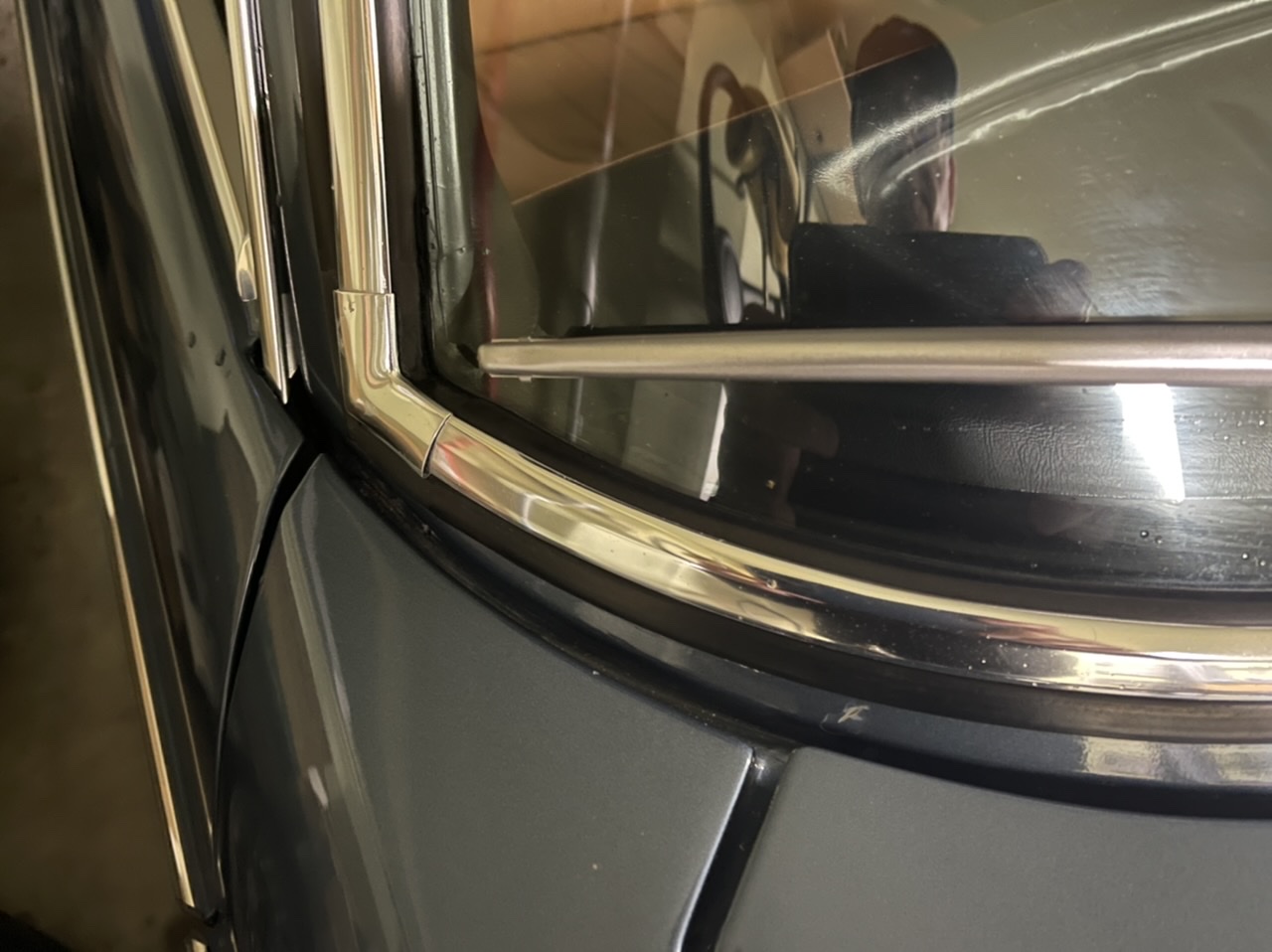

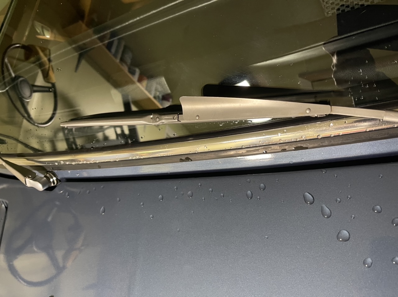

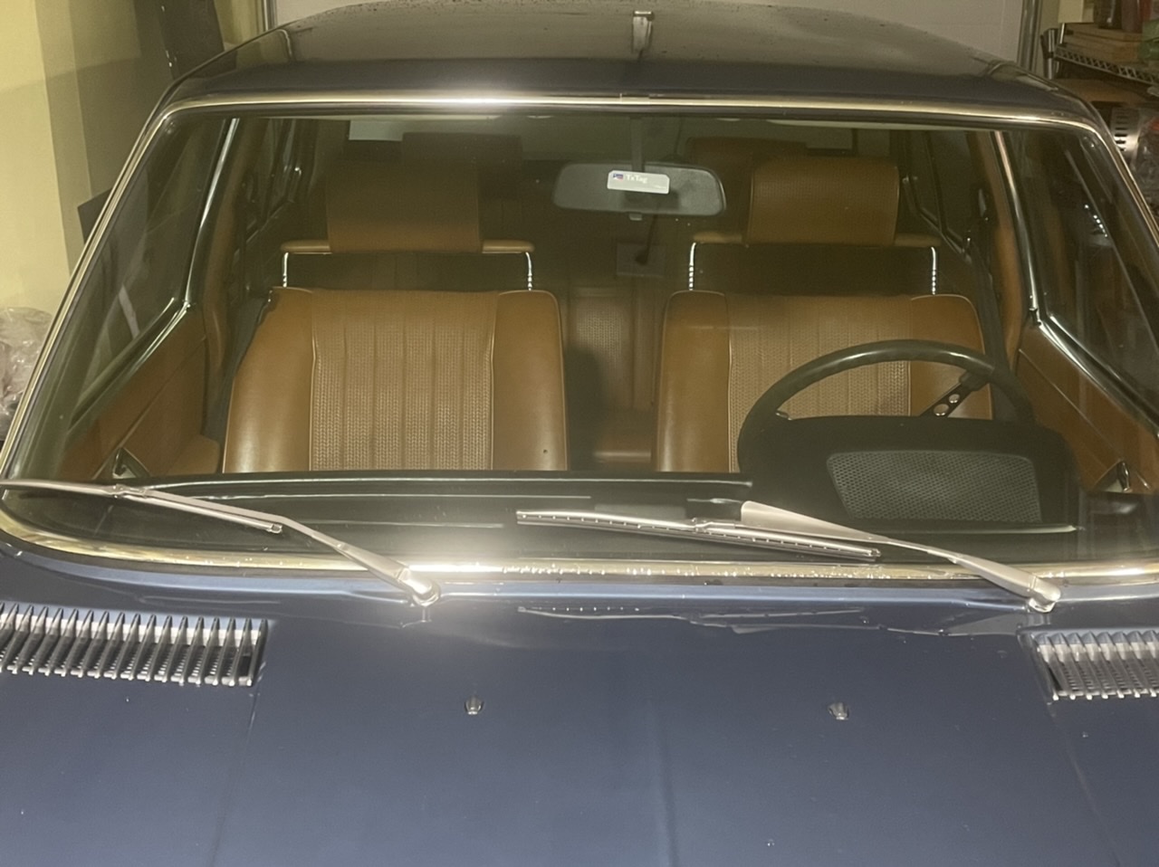

I spent a bunch of time on wiper blade assemblies today. I believe I have the a good answer for those of us looking for the right (available) part for the E3, here in the US. Some comments and photos:
1. The Trico Classic 33-150 is the right part for the E3. It is the same silver color as the the original E3 wiper arm, is bayonet style and is the correct 15” length. I just installed a pair and photos are below.
2. Online 3rd party fitment guides (e.g., wiper manufacturers, auto parts stores) are wrong. They all come-up with 16” (black) assemblies and all say the 33-150 does not fit the “Bavaria”. This is hogwash!

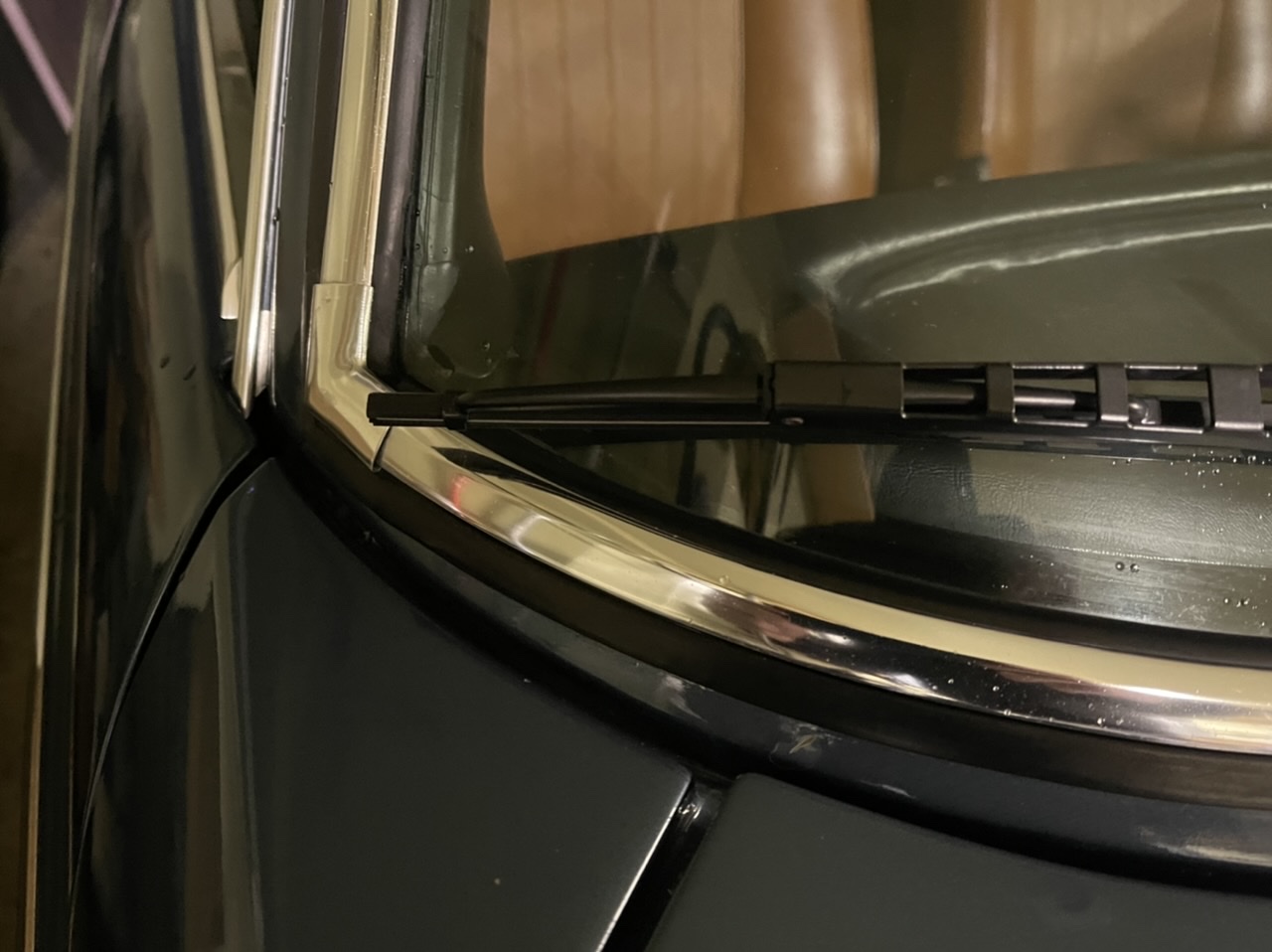

3. The very ugly (read:out of place) black Bosch wiper assemblies I just took off were 16” and plainly too long on the passenger side and stick out over the trim at the outer edge of the windshield. Pic at bottom.
4. I found the the Trico 33-150’s for about $11 each at a local O’Reilly auto parts store, a couple of miles from my house.
AustinOski
206
104
Austin, TX
BTW, I’m still waiting for a comment about what is in the reflection of the windshield in the first two photos (and I’m not talking about me).
