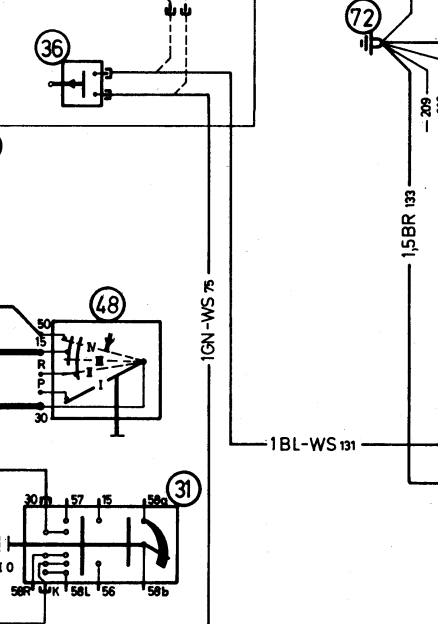

Wiring diagram shows #36 reverse switch wires Blue w/ White Stripe and Green w/ White Stripe and my 2800CS went with the window switches. I looked under ours yesterday but I had to add length so the colors aren't the same.

Scott -- Perhaps I wasn't being clear in my earlier response. The original wiring for my coupe was under the dash and through the firewall as Chris and Steve has mentioned. My car is an early 72 auto. Blue/white and green/white and with stripes just like the ones in your post 3. When I did my five speed conversion on my coupe, I used this wiring.
My comment about the 535is was intended to communicate that by 1987, BMW was routing the backup light switch wiring up through the tunnel rubber boot that surrounds the shift lever to a connection just forward of the shift console near the light switches. This fits with the second set of wires you found in post 17. Moreover, these wires look like they were added to the car because the stripes surround the wires at 1" intervals as opposed to running the length of the wires. My guess is that whoever did your five speed conversion ran the wiring up through the tunnel near the shift lever and then spliced into the original wiring somewhere.
That said, I would locate the connections at the light itself and find out where you have continuity to wires you found. If the wires at post 17 are spliced into the original wiring, you should have continuity at both sets of wires and you can take your choice.
