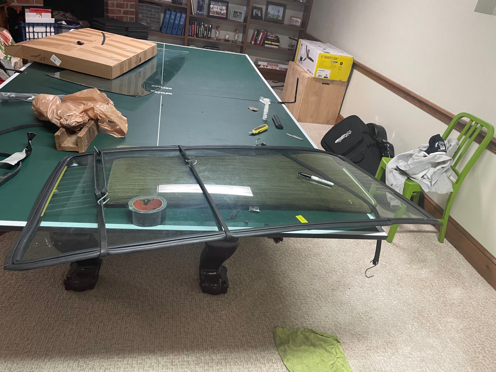

so far im using the bottom corners of the "front " for the upper left and right corners of the new orientation, then will cut the right angles for the new bottom l and r corner, waiting on glue , 3m instant, if i search for 495 I get "loctight" a different brand
Loctite 495 is the correct material. Comes in a small bottle that goes a long way. Use sparingly. The less put on the better it holds. I can’t comment on the 3M glue because that’s not what I used, but I do know the 495 is awesome.
Not sure this is in the thread, but what I did was make sure the curve at the top, left and right fit well enough, but doubly sure the 90° bottom corners fit as well as I could make them. The sides top and bottom will be too long, but these are easily cut and pasted because they’re straight cuts. The more precise and straight you can make the cut the better it will look just be careful when you stick it! That being said, I now recall that it didn’t really matter because if you stuck it incorrectly, or you don’t like the fit ,and you left yourself enough slack you could always do it again, and again! You just don’t want to get too short.
After I had it to my satisfaction, I used plastic wrap on a roller and secured it and left it for a couple of months on the windscreen.

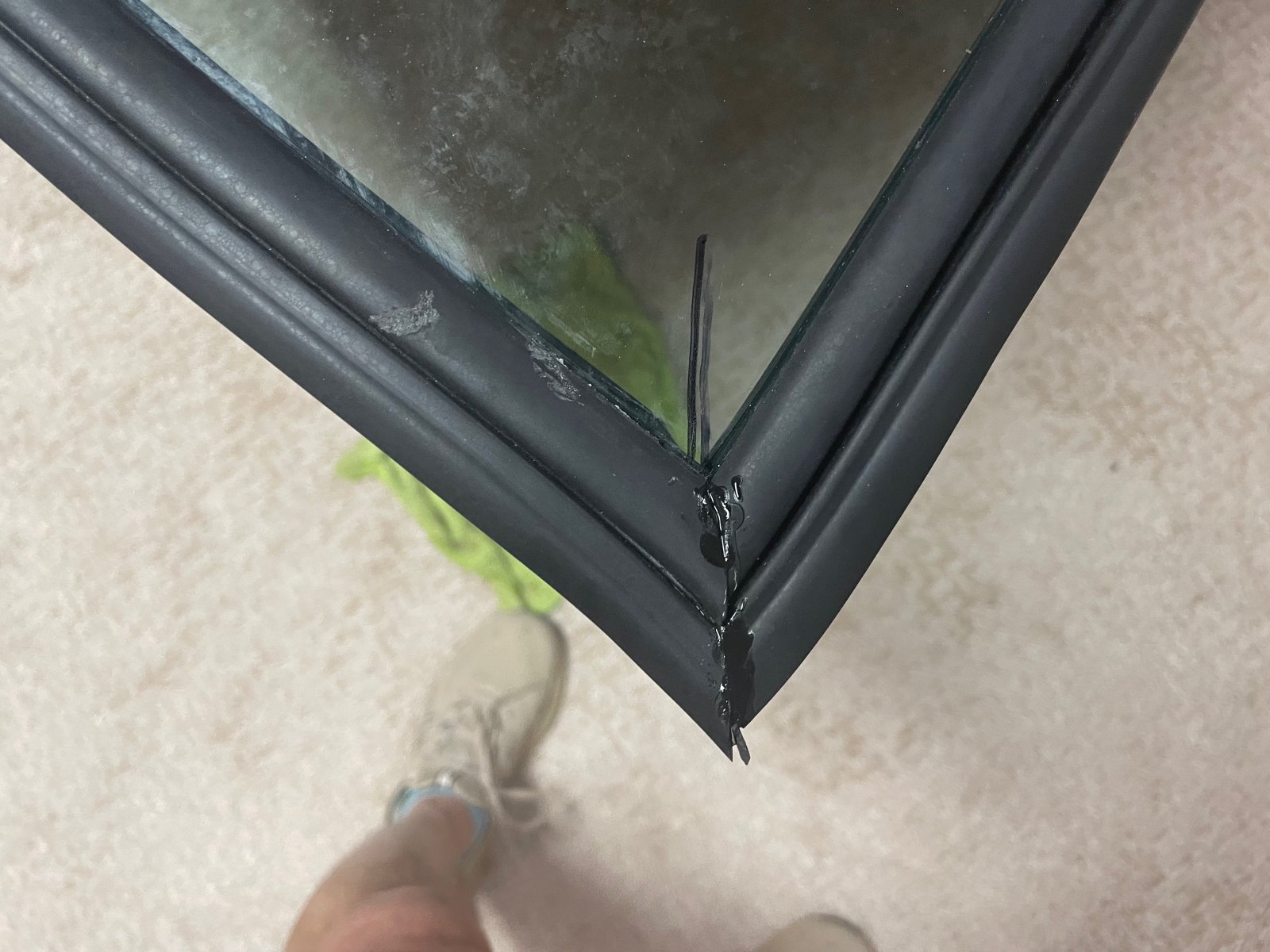

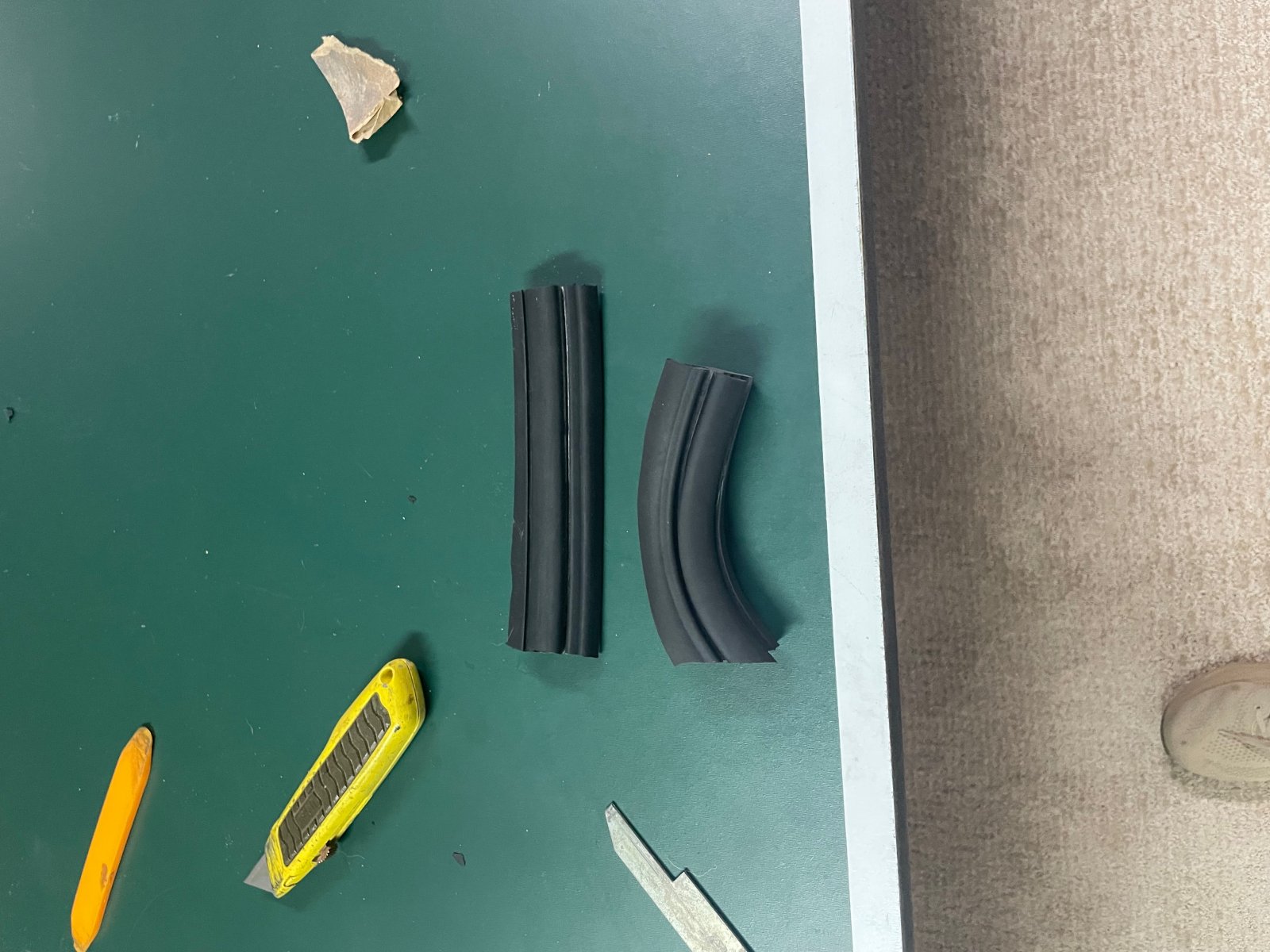

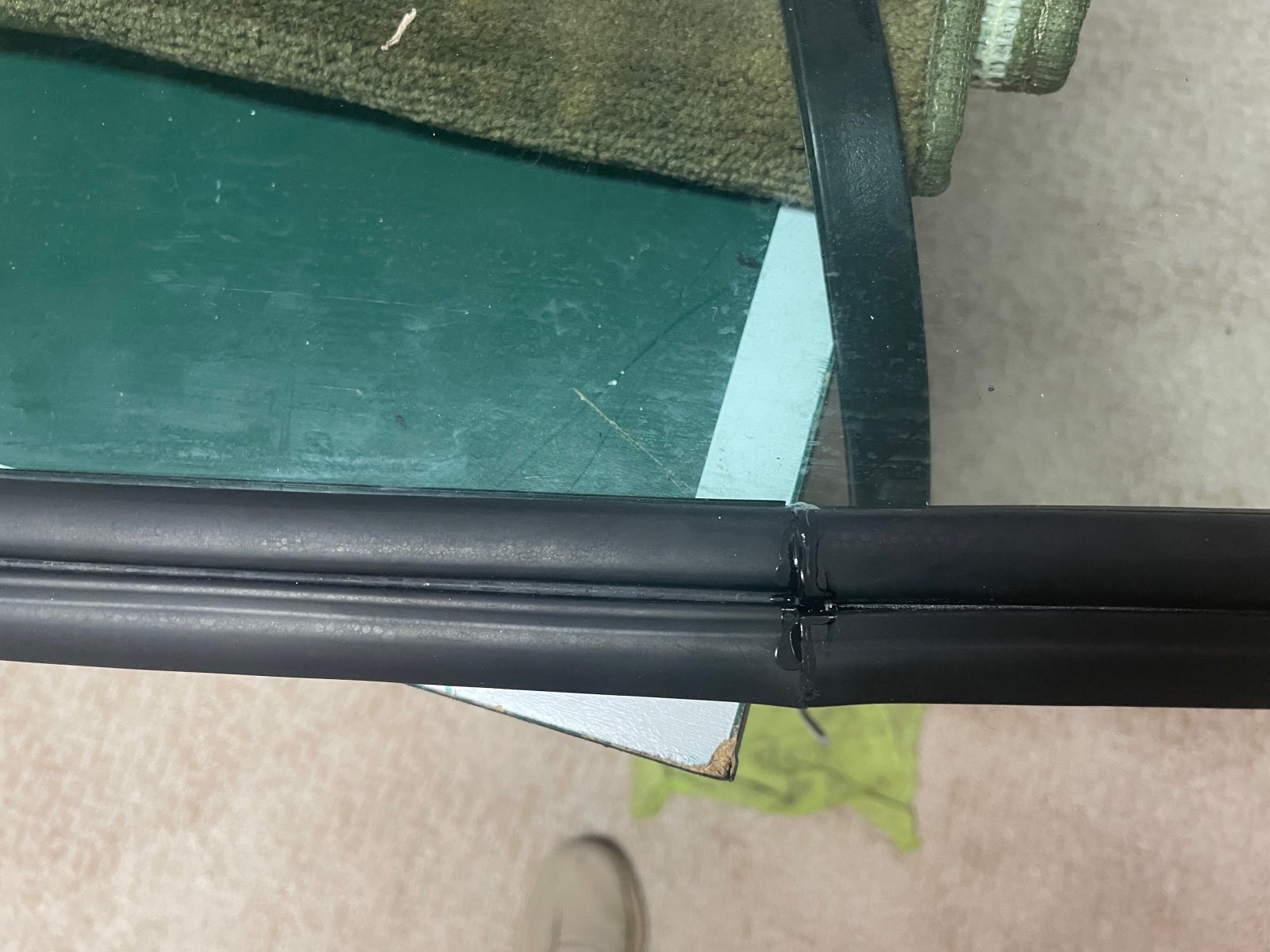

got it together , i wish i had a few more to do to get better. there is little room for error, only two little pieces left over

If you have the length,you could clean up IMG 1882. Very sharp knife( i used a fish filet knife with a little heat,cuts like a hot knife thru butter) . Use less glue. Being in the middle it is goin to stick out.
OR, you can sand it with fine paper to remove overspill and clean up the seams. Corners look great and too can be lightly sanded.
Remember you are putting the trim in so really only the outsides will show. When I put it together to sit for a while, I did so with the trim installed. It can be tricky and will bend easily, just try not to "kink" it.
