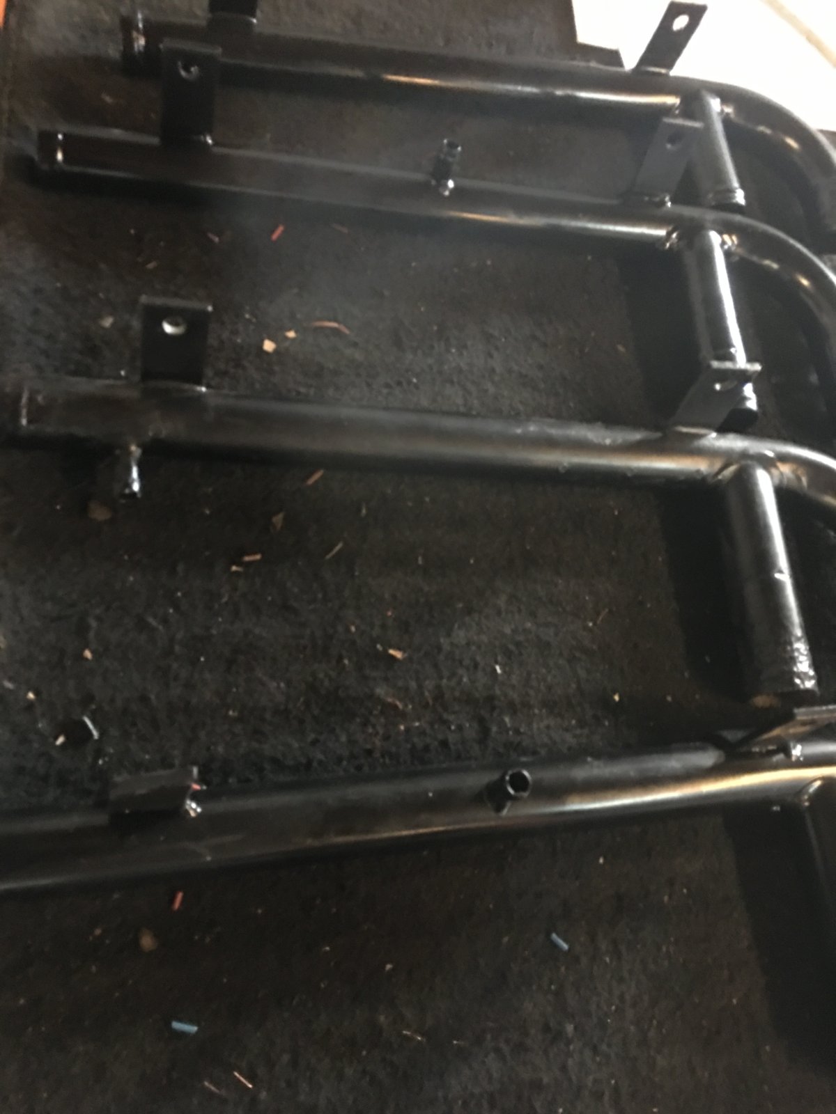

    752E3CE7-1A09-4432-984E-D76749772AC8.jpeg Keep in mind there are two versions.....

    what's your point Don ... you take them off because
    1. they are corroded and you don't trust them
    2. they don't fit
    3. too expensive to fix
    4. they are all different
    5. you have them stockpiled for future use

    I think the point of the picture is to show the visible difference in the two types. I’m also guessing that the correct answer is #5.

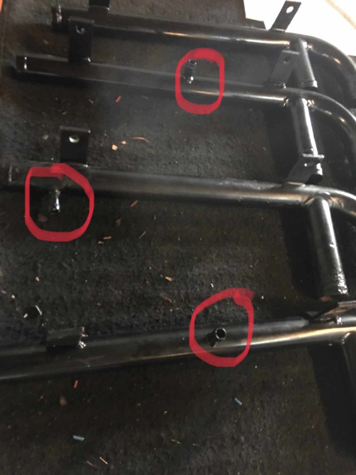

    Two different models- look at the red circled barbed fittings - only one with barbed hose fitting circled in red on left is correct for Csl/Csi
    They are often rotten - I get them braised and powder coated . Folks with injected original collector cars want OEM parts.
