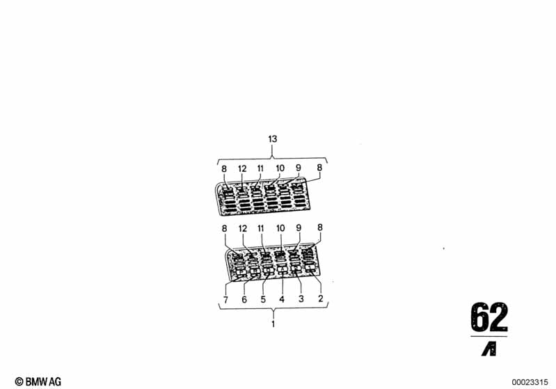

Bear in mind that while the E3 gauge set may fit, not all speedometers/odometers will read the same - unless your rear axle ratio matches the replacement gauge. 3.64/1 is typical, but not necessarily. https://e9coupe.com/forum/threads/what-differential-gear-ratio-to-what-speedo.8252/ Also, some tachometers were marked with different "red lines (areas)."
Not to dissuade you, but if you are only concerned about concealing the gear indicator lights, those are plastic "lenses" that fit in the bottom six squares and they were listed as separate parts per the catalog (See: "7, 6, 5, 4, 3, 2 and 1" below). Although they the lens may not be available, it would seem to be fairly easy to replicate, or obscure, with flat black paint or some suitable matte cover.

Hi Lloyd
That is a great suggestion!! Thank you! Honestly, I did not notice that the automatic selection indicator lights could be blackened out; I thought the indicator lights for manual cars were extended down but that is not the case. I like suggestions like this; makes total sense and saves $ too!
