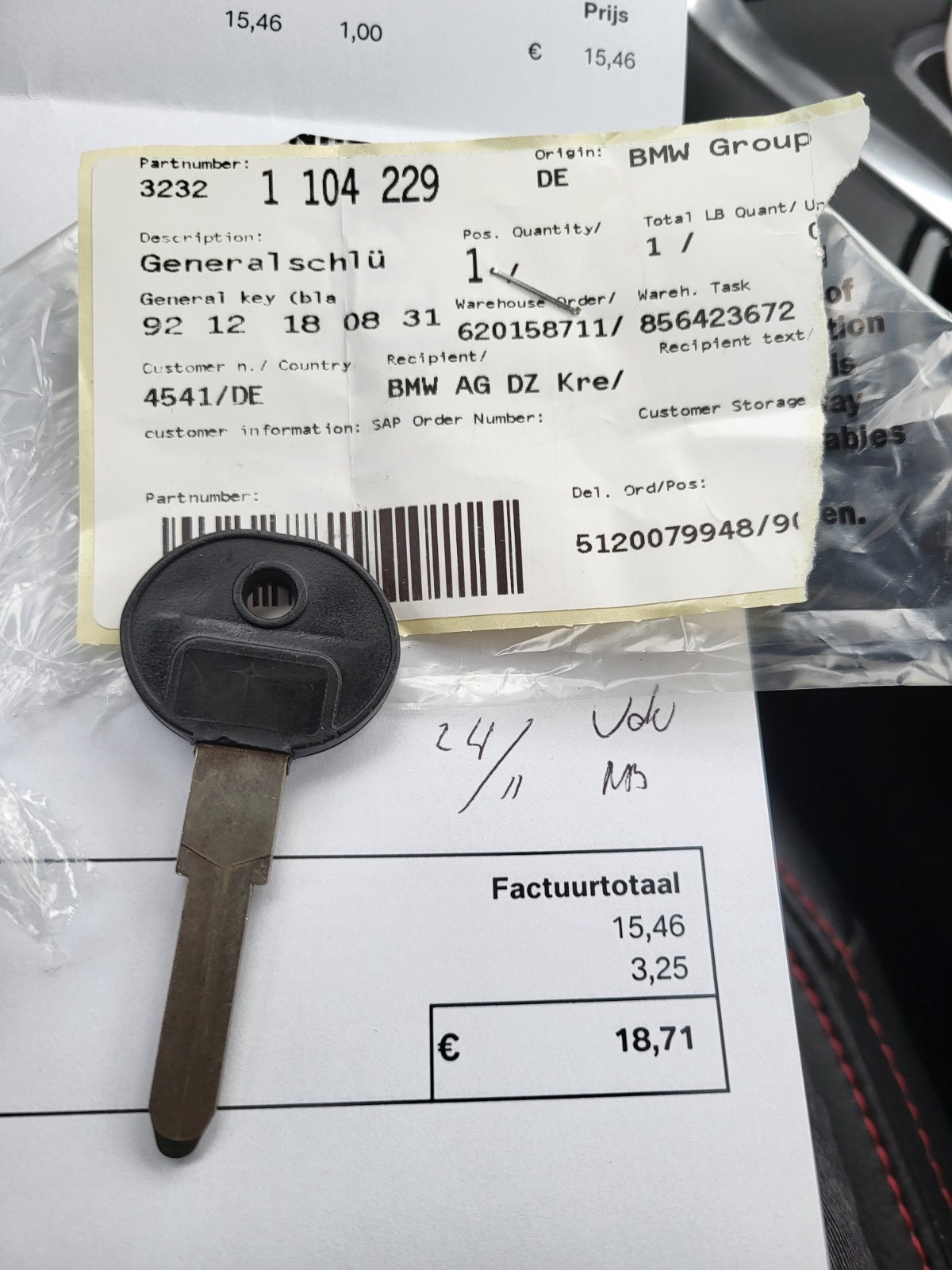

Hmm, just ordered one in the Netherlands; ourselves are not identical. No 'pebra', oval head.
Functional, but my originality quest isn't satisfied.

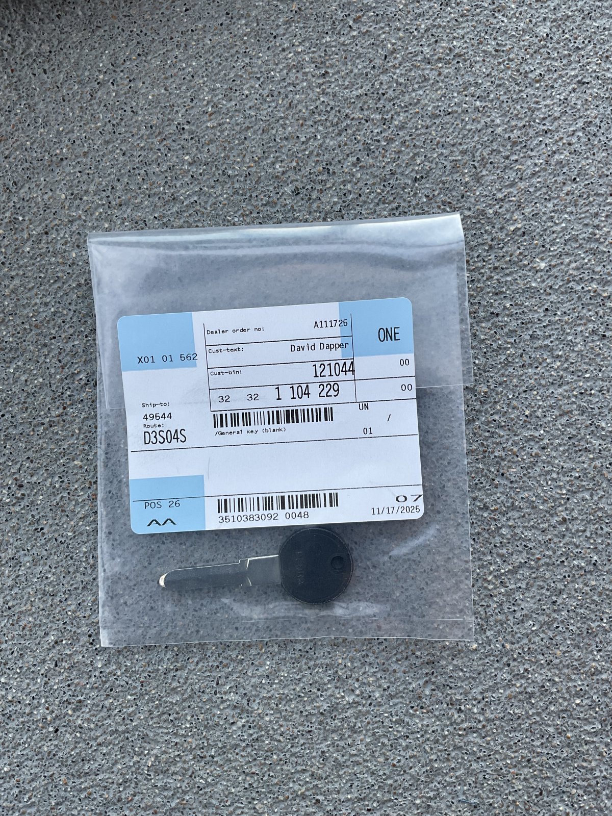

....same same I received a while ago when somebody told me "originals are still available with BMW". Feels like lottery.20251125_153615.jpg

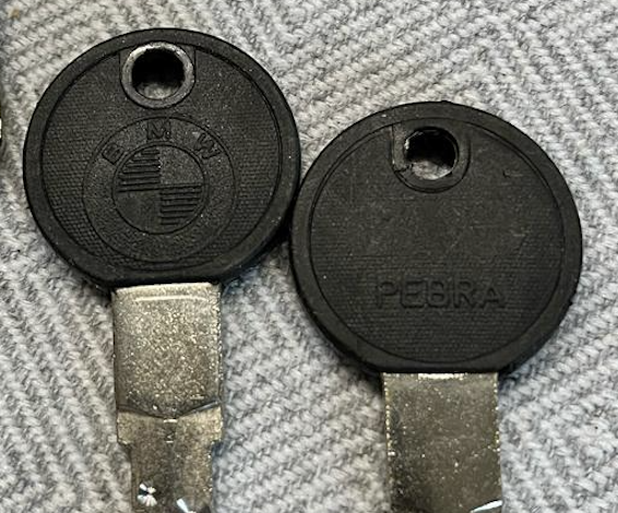

...ouch ... all are the same part number. Some are 100% original Pebra, the good stuff, others are similar but generic blanks...
