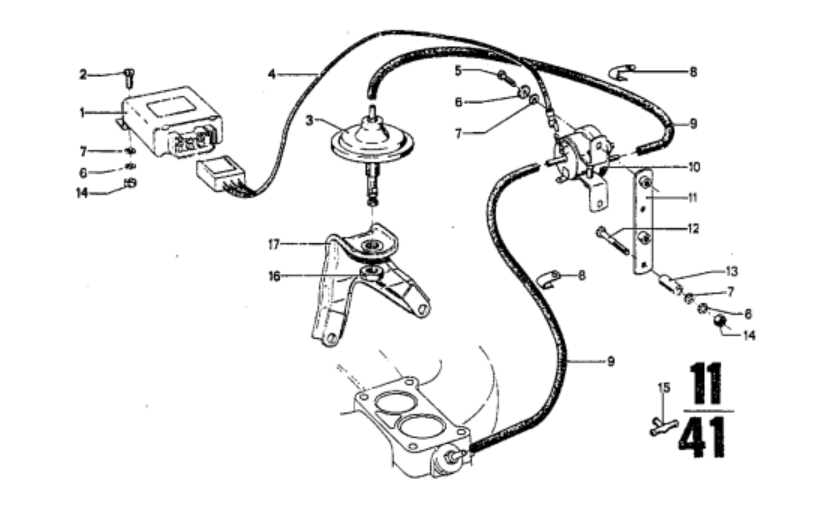

The wiring harness with Don's cooling/A/C new system has a way of powering up a solenoid when the compressor is on, but I have not found the correct switch or a place to mount it,even after looking at Steve's pics from before. Once we get the carbs sorted, I will work on that. For now, Heel/toe on the brake & accelerator is my method of keeping up the revs.
If want to use original parts...something like the setup on the original twin carbs
You'd need an extra arm on the cross linkage bar for the vacuum pod to contact.
The support bracket mounts between two manifold studs on its original use.
Hook an electric vac control valve in vac supply tube that is activated by the ac (Don's provision)

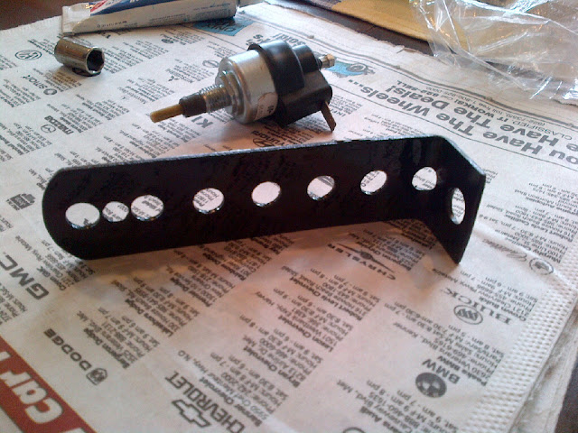

If want a not so visible simpler solution you could use a solenoid plunger as an adjustable "stop" on the lower linkage pivot bracket on side of block may do the trick.
