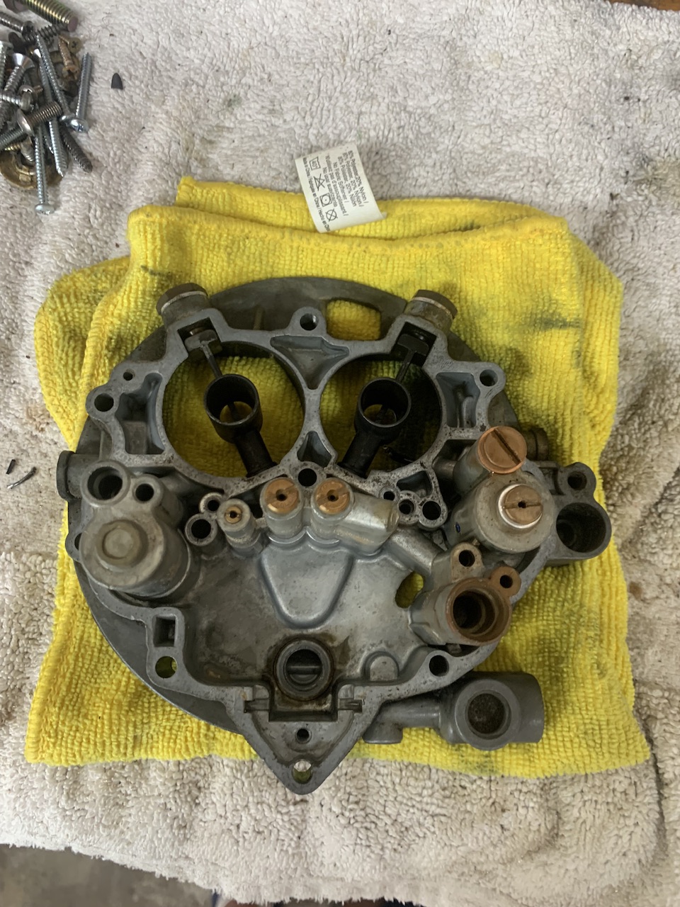

Runs like crap when cold, much smoother warm but something isn’t right. When cold chokes close and open progressively but it doesn’t have a fast idle, I have to hold it until it warms up. I have rotated the choke housing to a richer position. I pulled Zenith top case off on Sunday, cleaned idle air jet and upper jets on main and secondary. Maybe I need to pull again as in bottom of the 2nd stack are the other main and secondary jets, mixing/emulsion tubes run between the two. Will talk to Don’s expert tomorrow, another frustration on the road to completion.

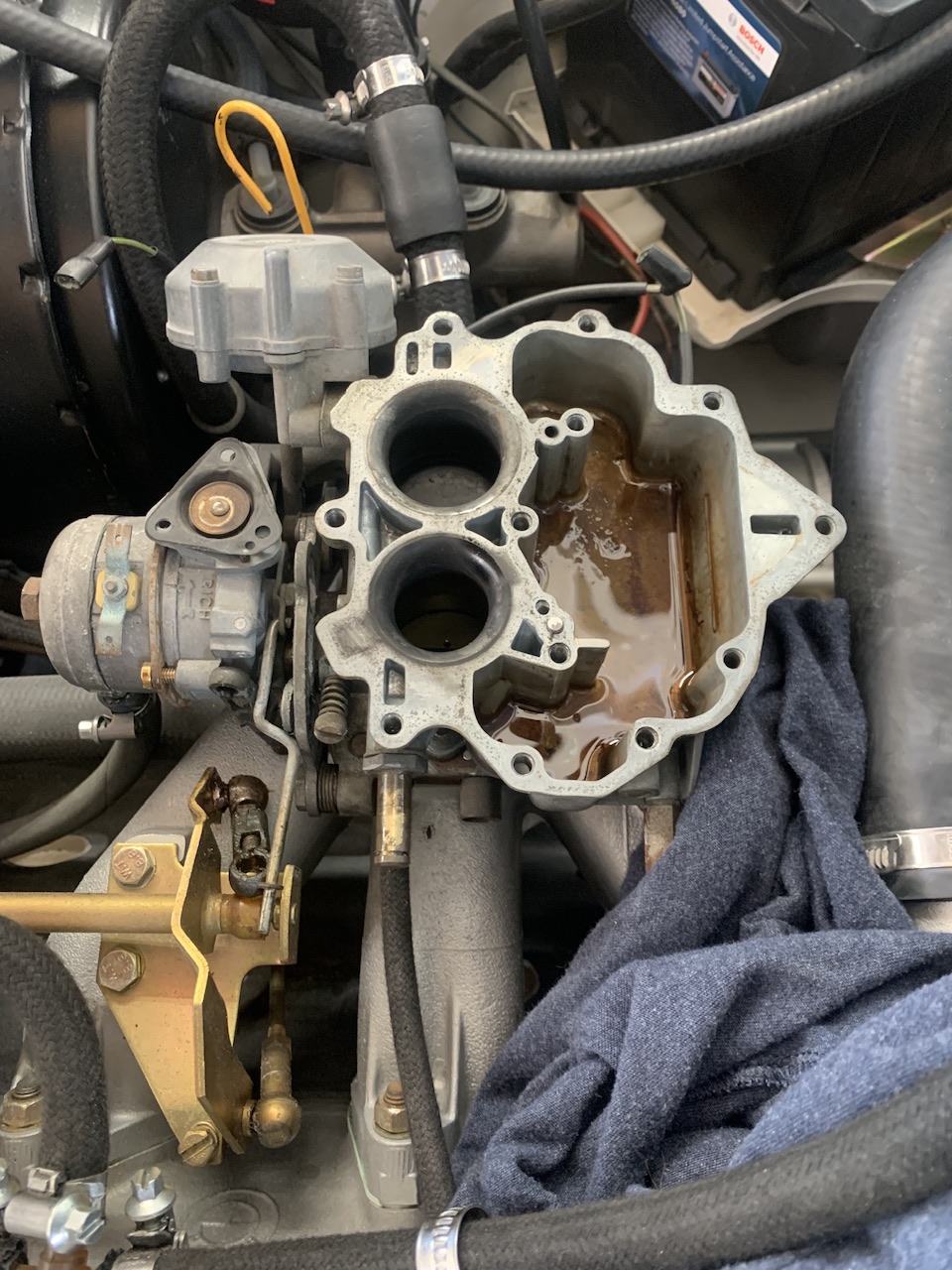

Steve, I will try to find that hole and cover it. Carbs were not rebuilt, just accelerator pumps. Car ran fine after five speed swap coming back from Rey’s 30 miles on freeway in November. Maybe we have too much on the idle richness screw to compensate for a clogged idle air jet. I understand these carbs much better now after removing the top stack and plan to remove next stack to get to underside orifices. How do I test secondary barrels for leaking?

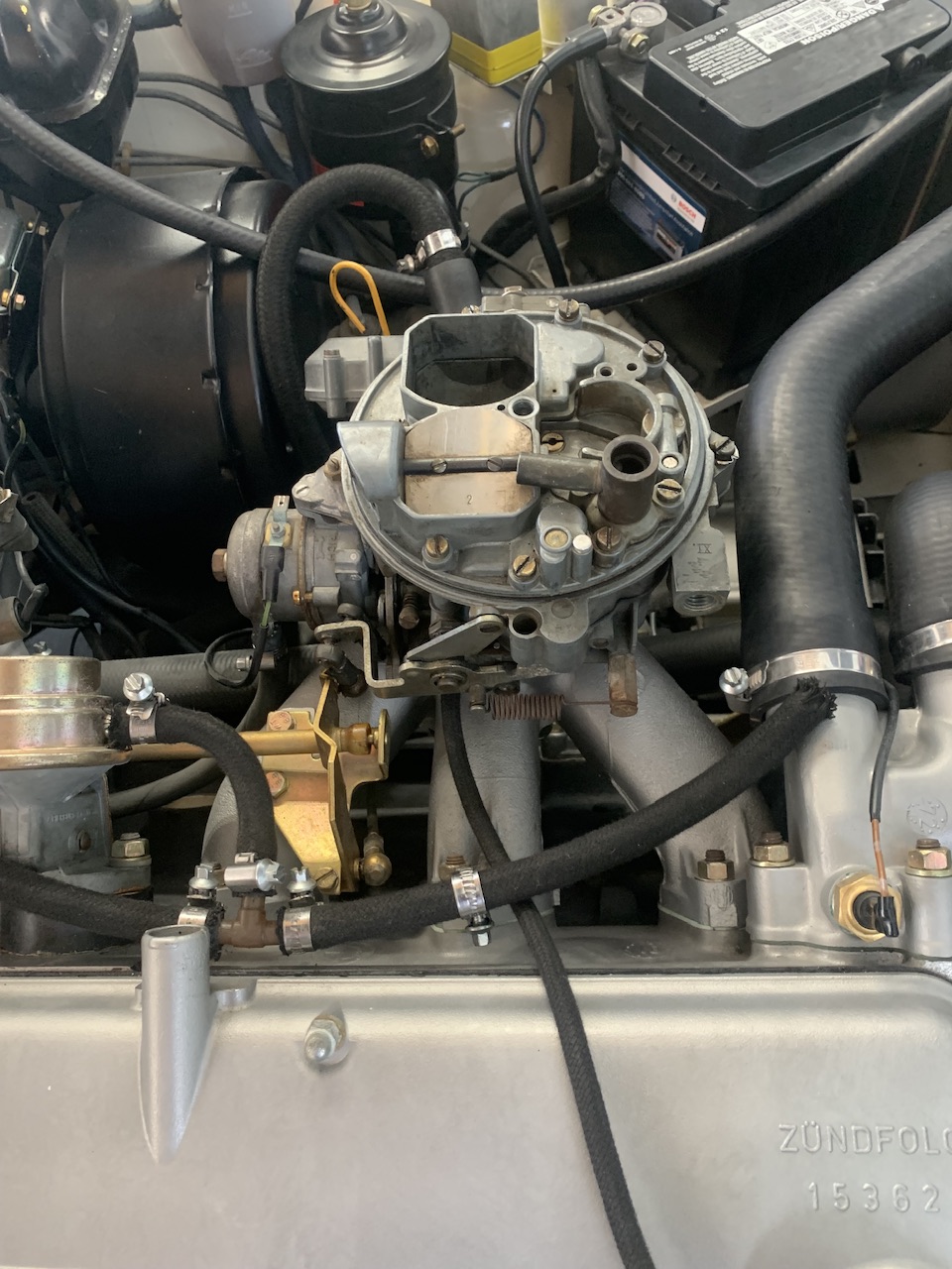

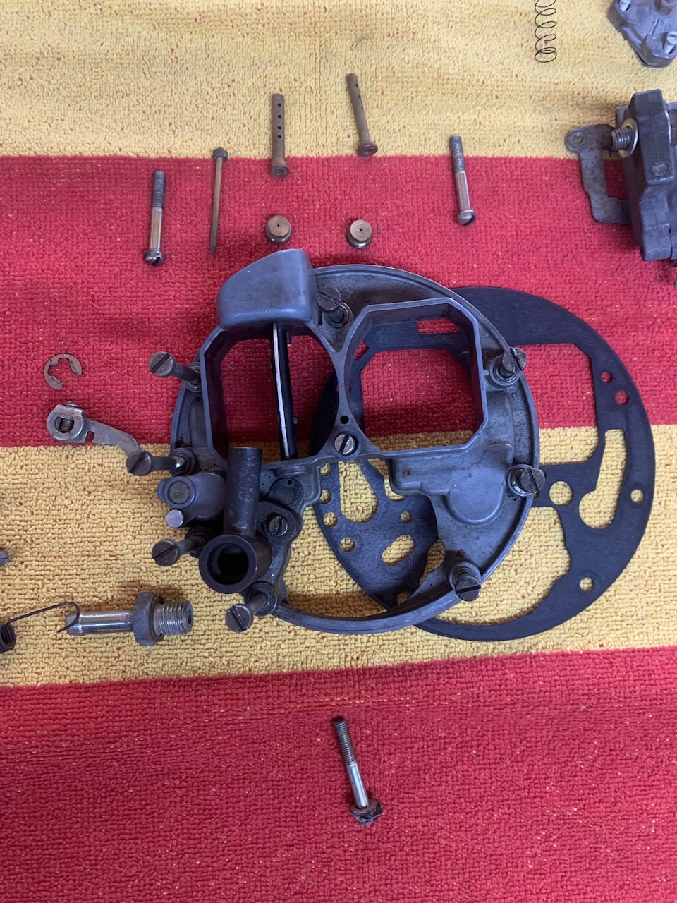

Rick, I spent three hours removing front carb pieces, cleaned all jets and replaced float valve, cleaned carb components, dialed in the fast idle parts I which I finally figured out means top cover had to be back on to close choke completely, adjust the butterfly valve (?) to 1.5mm to the lever inside choke housing, turned in the fast idle screw one turn as it is so hard to tell where it is resting (I did this by opening throttle so screw was horizontal). I also made sure housing is rotated to the notch for initial setting. Tomorrow I will do the rear carb.
