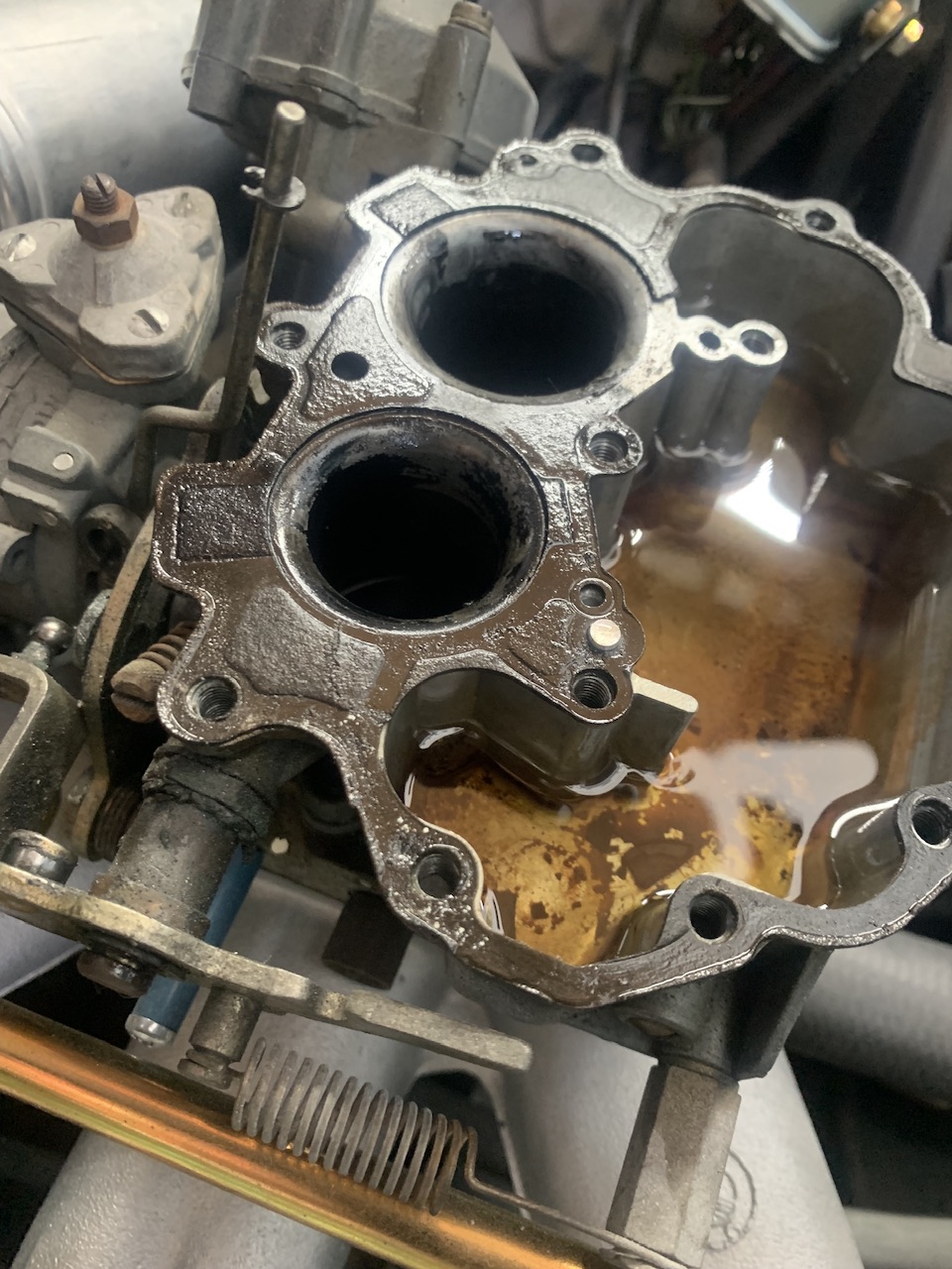

This was the rear carb, pretty wet when I removed the second stack. Got everything cleaned and reassembled, even the tiny screw underneath, can’t get the butterfly valve within 1.5mm of the lever but not bad. Poured a bit of gas down the vent pipes, car fired right up, 1400 rpm, can’t get it to drop down so maybe I will loosen those two screws a bit and rotate choke housing CW. However, gas is dribbling into the venturi of the rear carb which is not good, front carb looks great, gas is atomized. New float needle not closing? Rick, your thoughts?

Geez you got a lotta crud (technical term, ya know) in the float bowls. Really need an effective filter, Mr. Chris. I assume you have the filter on the gas line inlet? A lotta stuff can get through that metal mesh, but IDK if it's still coarse enough to obstruct a jet.

Cold/fast idle much better but after four attempts gas still runs out of Venturi into the throat after reinstalling old float valves. I removed one Venturi and noticed a tiny O ring where it meets the body. Haven’t reassembled yet.

Back to gas leaking into main throat after swapping Venturis. Float needle has three spacers and spring returns so I know that is working.
