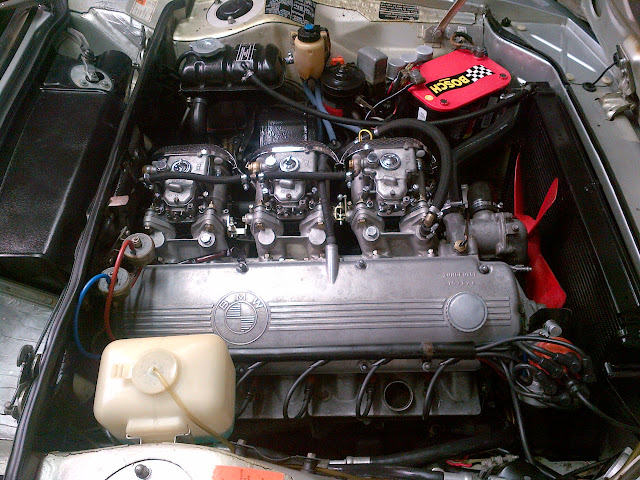

Update
Finally solved the middle carb air leak causing backfire and spitting. I also went a notch richer on the idle jets and main air correctors to bring me more in line with other 3x weber coupes I've seen here. All hoses are braided cloth including the crankcase breather for period look. Smooth idle. Took it for a test drive tonight and it friggin' screams and pulls to the redline (for a stock engine). The intake sound is awesome. The gas mileage sucks. I grin when I accelerate - worth the tradeoff for now - I will see if they are livable long term. It's taken 2 months to get to this point through several frustrating (and costly) hurdles. I ended up with soft mounts with couplers instead of phenolic spacers/gaskets with throttle levers/cross bar.
Next up, more engine detailing, another colortune session, and tracking down a wideband gauge to check jetting through the rev range - will document the final settings for any others contemplating this self-indulgent mod. Thanks for the help.

Stevehose
13,031
5,725
Sarasota, FL
Here's pretty much the final setup, had the head rebuilt after detecting a cracked exhaust valve, fixed the cam sprocket from being off one tooth, aluminum parts bead blasted, new yellow fasteners, braided hoses, replaced the front main seal and chain tensioner, and detailed various components. Although the trumpets are for show, I have filter socks that fit over them for driving. I'll probably right angle the brake hose coming out of the manifold to clean up the loop. I installed an AFR gauge behind the speaker grille to see when driving which is removable to see while tuning, switchable and also completely hidden when not in use. Thanks for all the assistance, it only took 6 months!
