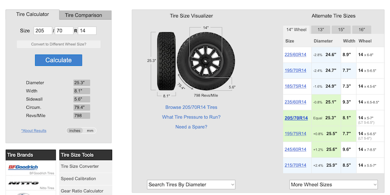

The calculator I use recommends a 5-7" wide rim for a 205 70 14. Others may show different

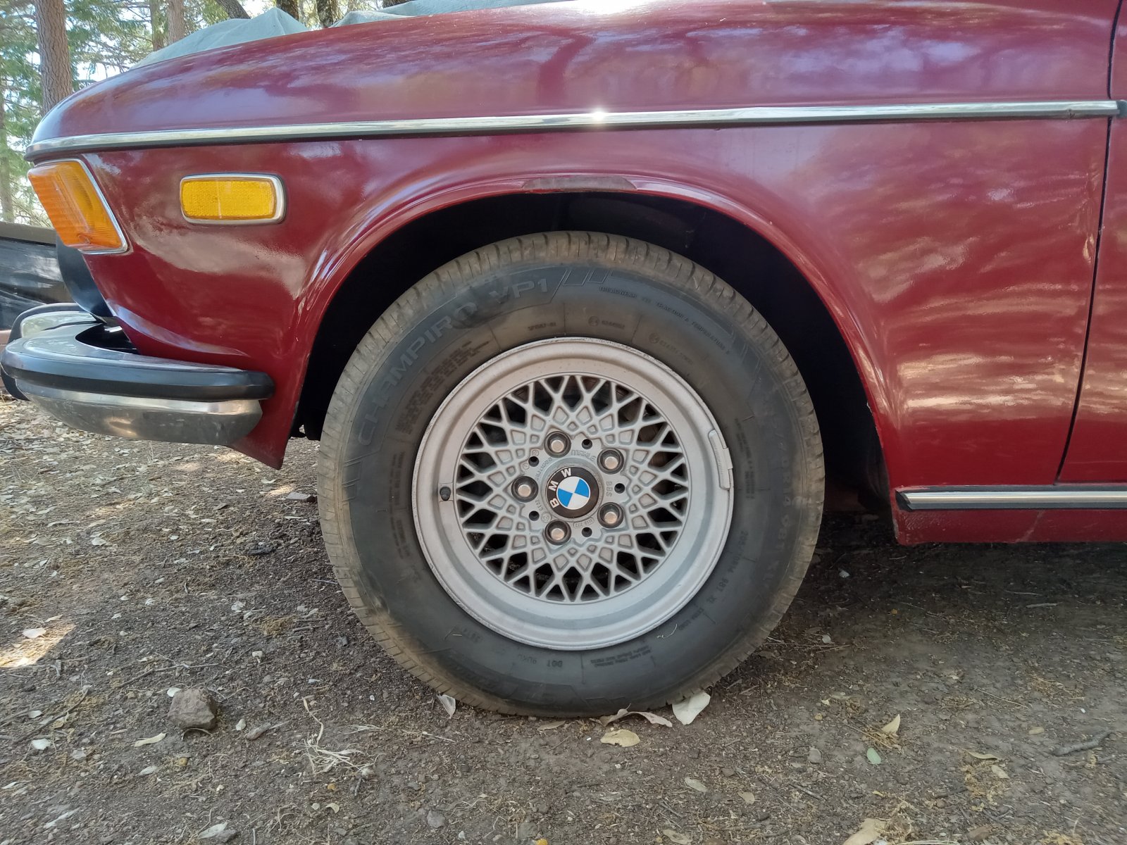

205/70 14s on my E3. Have used these wheels and tires on my coupe. Will be getting the same size for use as my coupe's new daily sneakers (14x7 Vials).
I like the taller sidewalls for the clearance on varied road conditions.
HTH
HTH

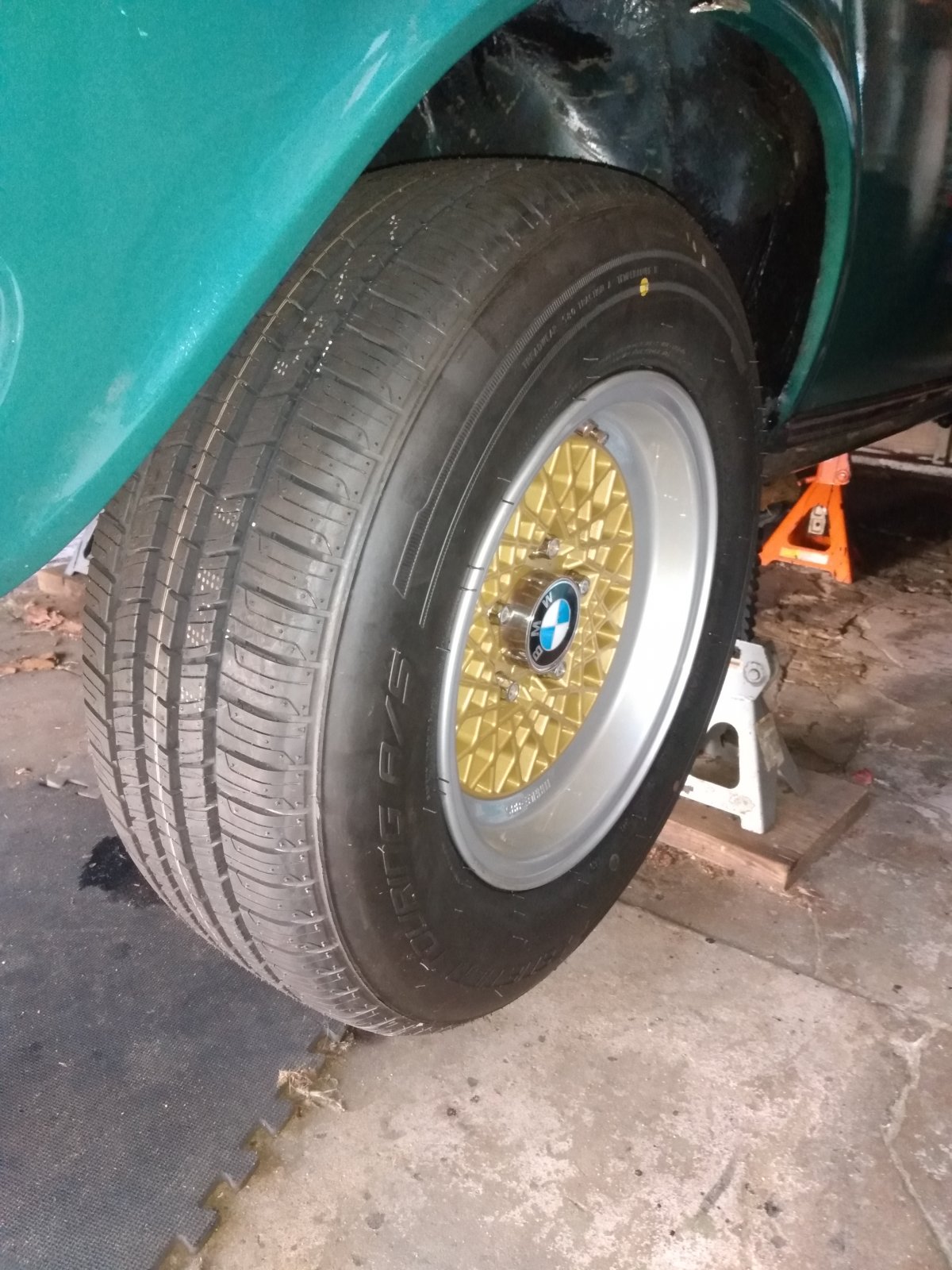

I went with these super cheap Kenda Kinectica 205/70R14s on 7" wheels but haven't yet driven on them. I also have some BMW Style 8 16" wheels if I want a grippier tire at some point.

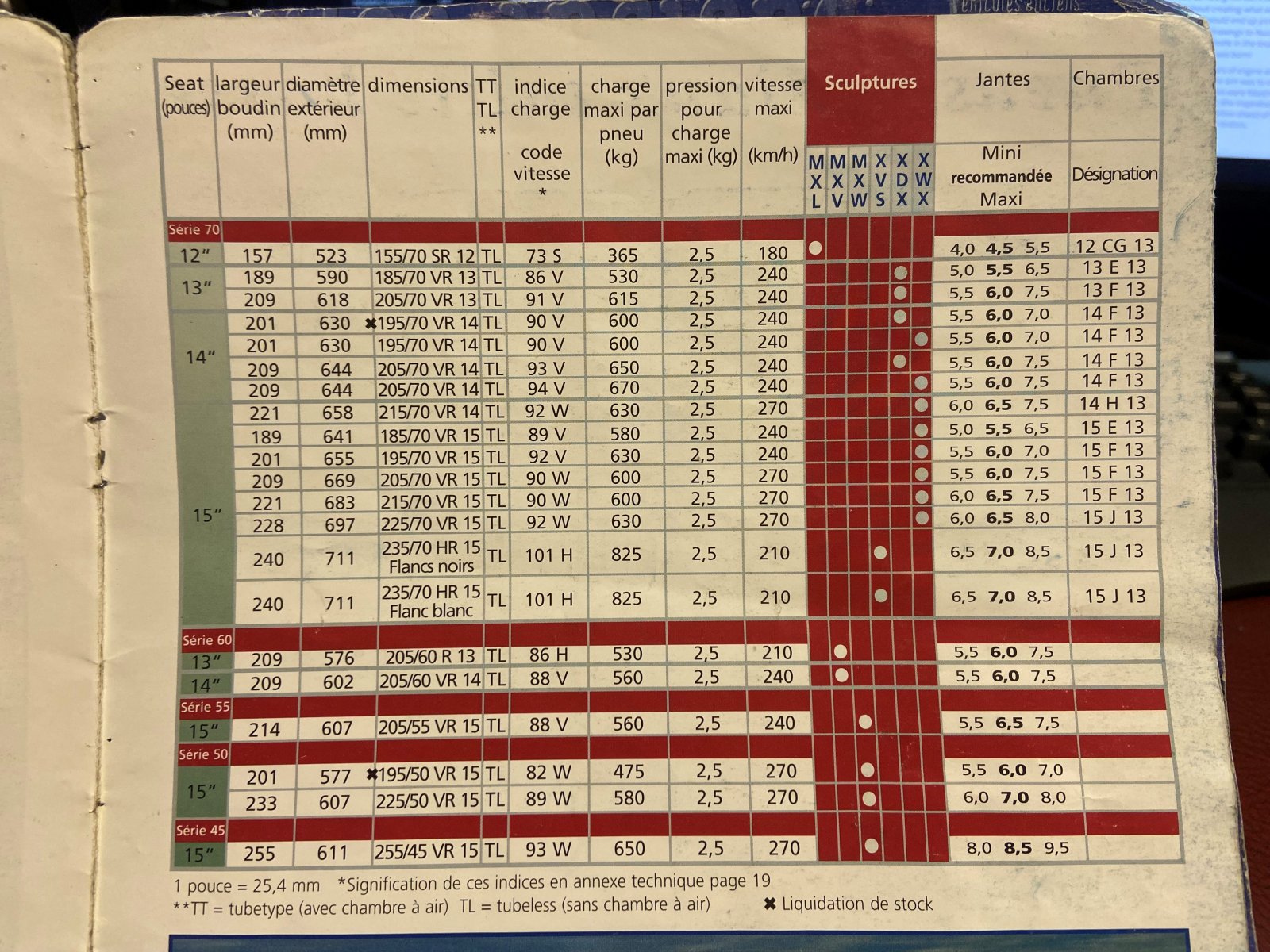

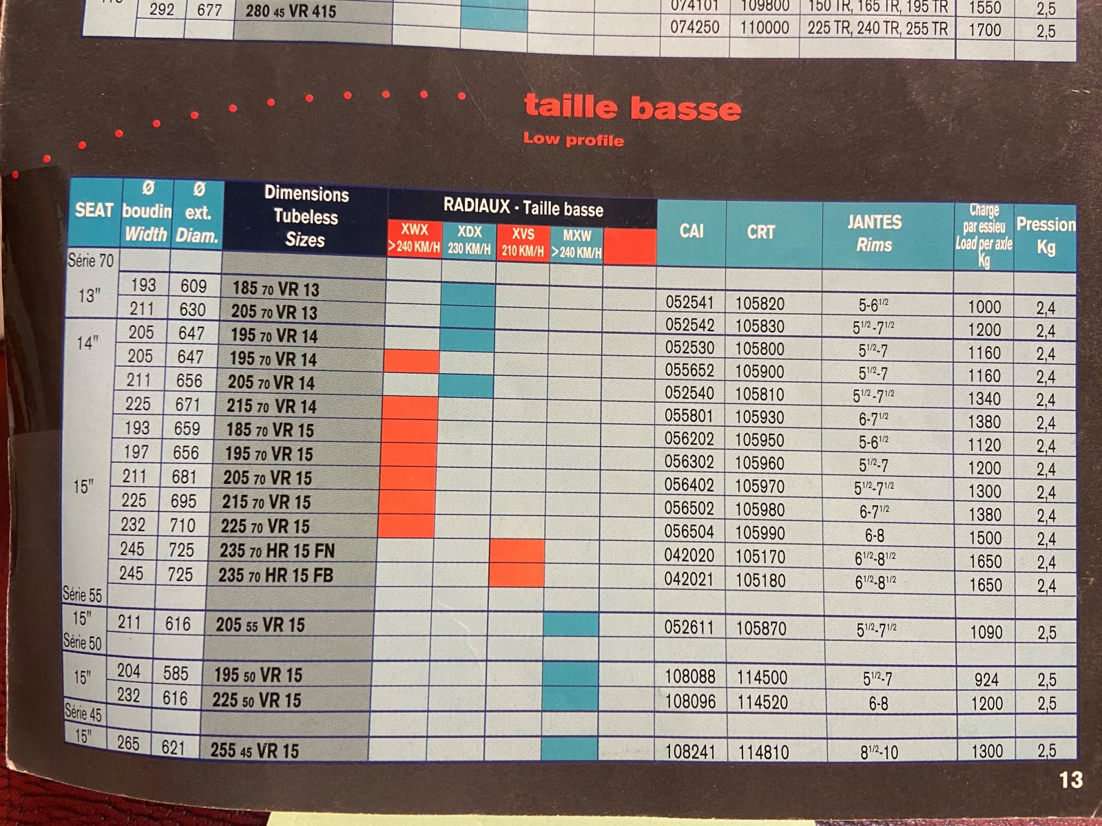

this is from the 1996 Michelin collection brochure. amusingly at the time they had 2 options of 195/70R14 XWX and XDX both listing a diameter of 647mm. which i think is silly because if you do the Math it should be quite a bit shorter than that. and more importantly the 200 book in a bit contradicts it. However at the time they only list the 205/70VR14 in the XDX. well i dont think that would make Ferrari Dino owners very happy.
Right this one makes a bit more sense
this is the 2000 book
so the 195/70R14 is listed as 630mm and the 205/70R14 says 644mm diameter which is more like it.
(70% of 205mm X 2 =) 287mm + (14" X 25.4 =) 356mm = 643mm
Incidentally the current range of Michelin list the diameter of the current 205/70R14 XWX as 644mm
